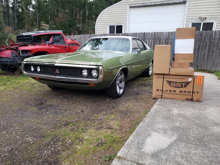

Meet Max the '71 Coronet
Check the heads for cracks. Magnums had an issue, not all but many. One of the dealers I worked at, we kept 4-6 pairs on hand. Trannies and converters were frequent rebuild/replace too. Poor shift calibrations and junky oe converters. All easy fixes plus upgrades are available. Magnums are great packages.
I have brand new heads on hand already, for just that reason. Also I'm using a Hughes EFI intake on it, so the lower plate sealing issues on the stock manifold won't be a problem either.
Consider taking a silver Sharpie and highlighting the edges of your grill fins. You have the silver front with the flat black background. I've also seen red that looked good, but on yours, I don't think red would fit. Maybe another color?? The all-black grill looks somewhat dull. Just sayin'.
I like it all black, but thanks for the suggestion.

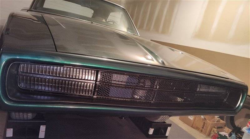

I'm digging the all-black look of your grille, I'm doing the same thing with my '70 Charger project. I think it looks meaner.

Hasn't been a lot of things to photograph, as the rainy season is upon us, but I did get a delivery last week, and I've been busy disassembling and cleaning parts from the 5.2 Magnum I'm building. Engine was just going to be a reseal/new manifold and run it, but some investigation found 3 cylinders with excess leakdown and valve marks on 3 pistons. Timing chain was wayyyyyyyyy past overdue for replacement at 207k miles. So now it's getting a full rebuild, better heads, a Hughes cam, and higher compression... along with a TKX 5 speed. I'm not a fan of automatics...

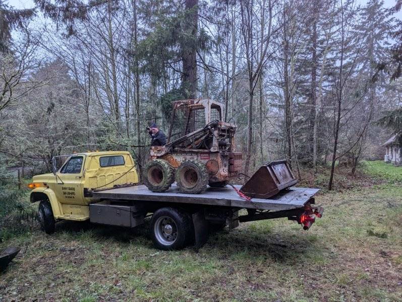

And because I need more things to work on, I picked up this 1973 Bobcat M-610 last weekend.
great work on the coronet, love the front end on those cars. no mater how many/much projects/parts. i cant pass up a good deal lol
