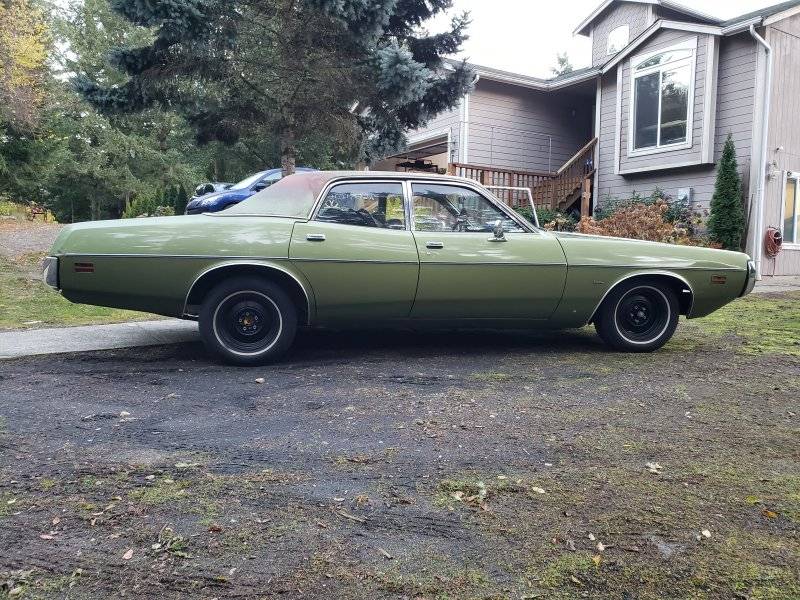

Meet Max the '71 Coronet

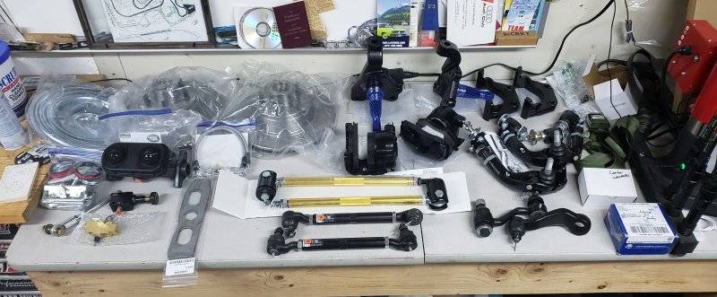

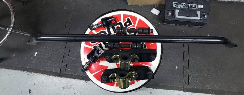

Next up for the Coronet... new and upgraded suspension and brakes! This is just the front pieces minus the anti-roll bar which will be here later today. The car, as delivered, had no anti-roll bars and is very softly sprung (and quite worn after 53 years). We'll firm it up a bit. Only things I'm missing now are the rear anti-roll bar and front torsion bars.. already in progress along with an upgraded steering box (Borgeson). And yes, rear disc brakes are on the plan too.
Nice example that was at least reasonably cared for. These are just the best looking 4 doors ever built. Just scored a 75 Coronet with fellow member Ari C. In junkyard for 30 years..It should run ( I hope). Great color on your car, don't give up on the 318, a good tune and free flowing exhaust makes such a good cruiser with plenty of passing power ( and it is thrifty to keep on the road). I've never noticed much gain with a 4bbl, the 2bbl. does just fine.
Ya, this car was definitely cared for early on, but then abandoned for a lot of years. While the 318 isn't a bad engine, its output even when modified just isn't where I want it to be.
Cruiser isn't in my genetics... :lol:

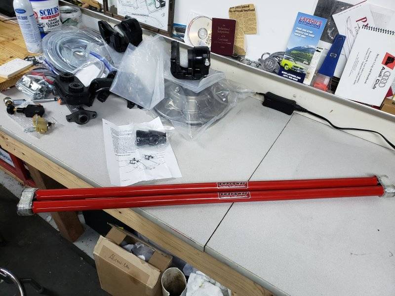

Next to last piece of the suspension puzzle on the Coronet is in-house! Torsion bars ala Bergman/SwayAWay are here. Just waiting on my rear anti-roll bar from Firm Feel now. C'mon Matt, I need that rear bar.
I was going to do the rear axle/brakes without the bar, but there may be a conflict with the rear disc brakes, so I need it for mockup. Given I ordered the bars last September, I don't think I'm asking that much.

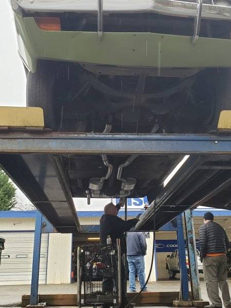

More parts have arrived... and a new exhaust. This is much better than the rotted out single oem exhaust. Picked up a Borgeson steering box from Peter Bergman with his adapter. This should get the steering feel dealt with. Just waiting on the rear anti-roll bar from Firm Feel and I can start taking stuff apart.

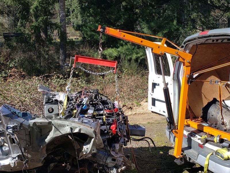

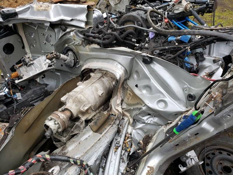

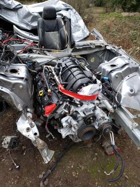

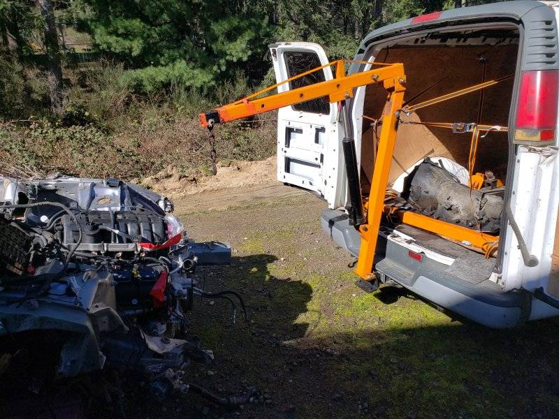

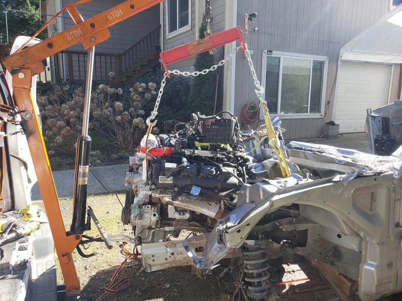

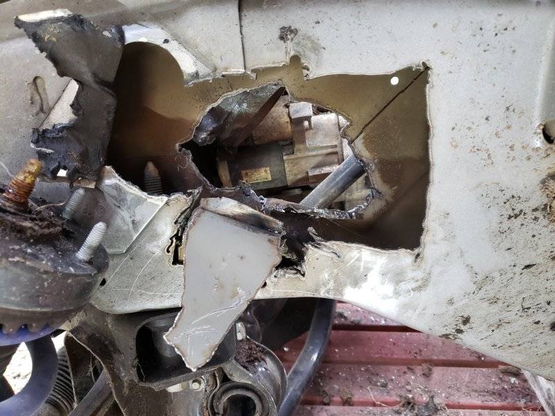

Todays project was getting the engine ready to come out of the Challenger. It really needs to be indoors for storage (it's been covered, but it's still damp). Did a bunch more chopping of sheetmetal with the plasma torch, cut off the driveshaft (already broken and zero use), chopped the bolts on the downpipe/manifold so the downpipe would come off. The outside bolt was obscured due to bent sheetmetal from the wreck, so I just cut in from the side to get access.
Now I just have to figure a way to get it out of the car. Car is on stands... engine hoist is fairly non-useful on dirt. I have an idea to build a hoist that I can stick in the hitch on my cargo van, just have to fab that up. A friend gave me his old engine hoist to use, so it's basically just building a mount.

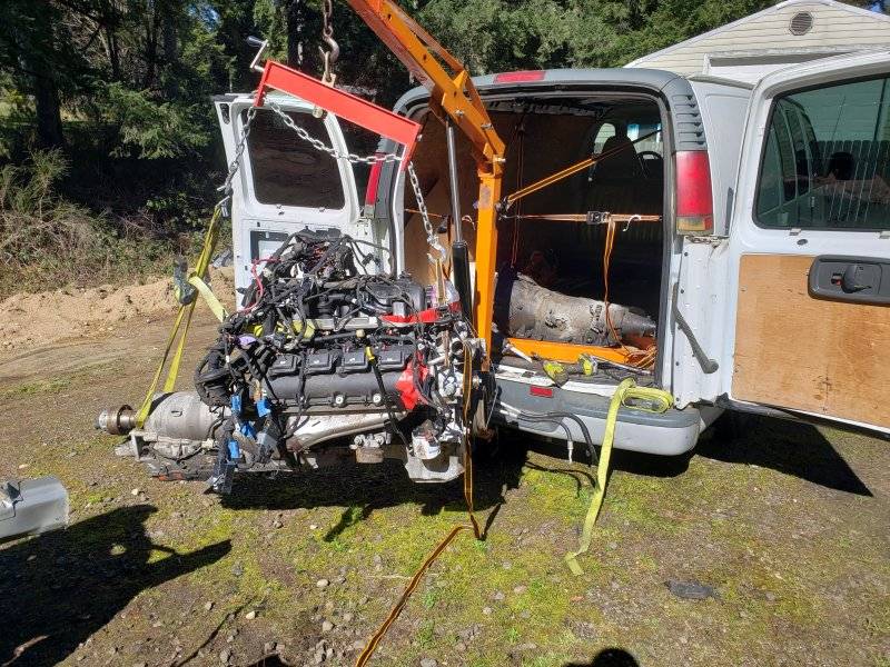

I'm thinking the van mounted hoist is the way to go, I just have to get it made.

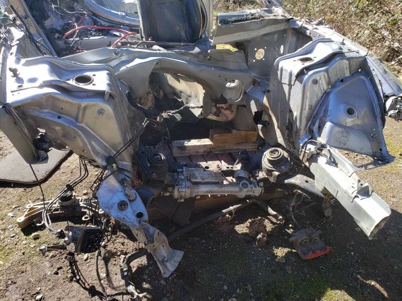

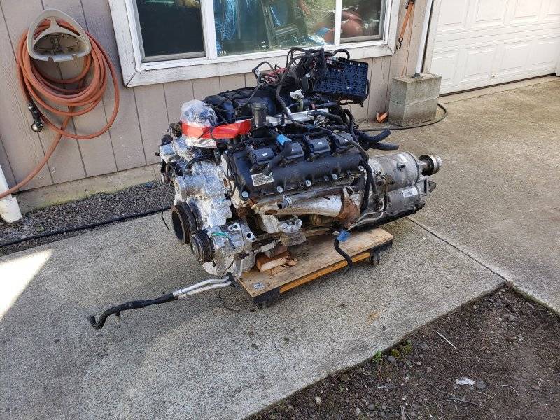

Ok, engine/trans are out of the Challenger!
We're finally having some decent weather so I put my lift contraption together and got it done. Also drove the Coronet to breakfast this morning. Next up, putting the Hotchkis rear springs on, and setting the front height appropriately.
Man... that Challenger is BENT. I have to finish pulling the wiring harness, but it's ready to go to the crusher and get out of my way after that.

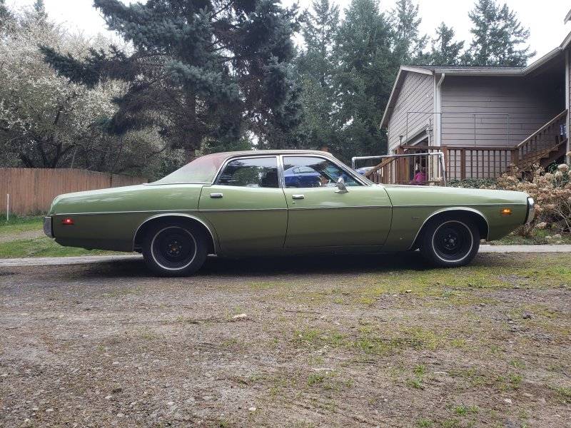

New Hotchkis rear springs are done. Lowered the rear of the car a bit over an inch which is about what they claim, and leveled it out side to side compared to the tired stock springs. Now I need to drop the front a little. Pics are before and after.
