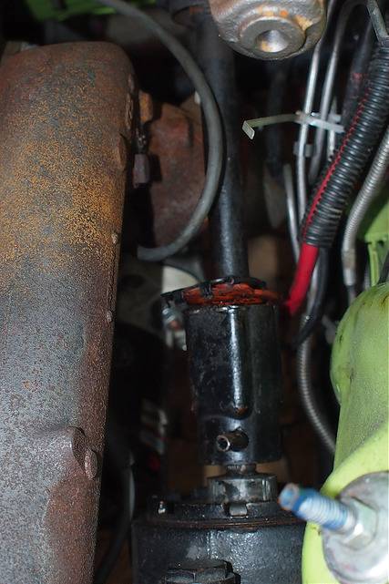

This was holding the shaft, and it was loose.... can you believe on this setup?

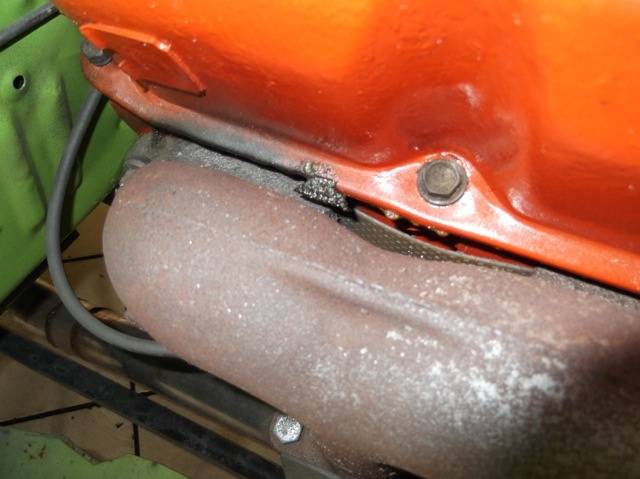

Came also with a burnt exhaust gasket

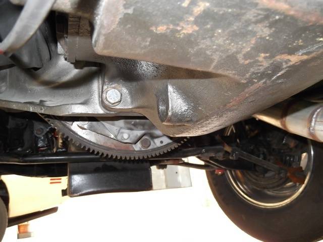

This is the RR gear box.....
NO OIL
do you see any residue here?.
DRY!!!
Shaft stuck, bearing gone

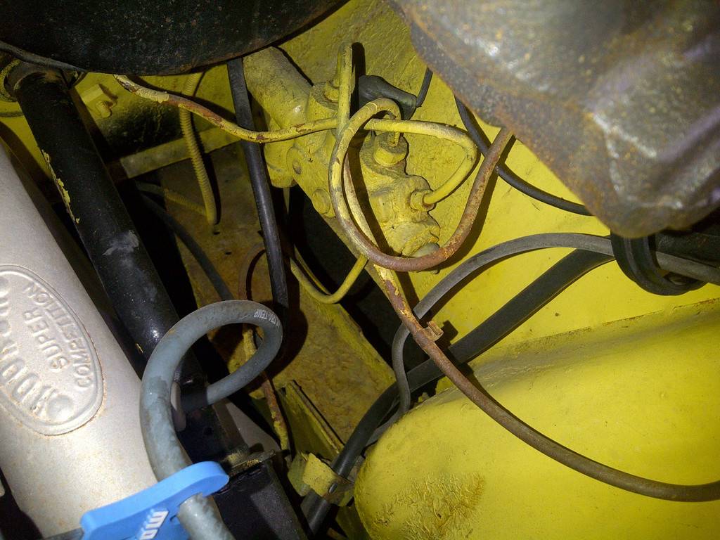

The pictures dont match here. The one about the steering coupler shows an exhaust manifold on the left side. The next one regarding the brake lines being painted shows a Hooker header and a different spark plug wire. What is the reason for that?
