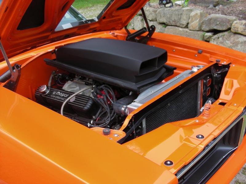

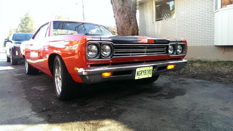

Well we asked for this section so sure as hell better use it. I'll kick this one off.... A bit about your ride, plans and a few pics
AngryBird is actually a 68 Roadrunner dressed up as a 69. 522 CME Crate Motor, Wizard Cooling rad/fan package, currently 4 speed but have everything on hand to swap in a T56 (Thanks in part to custom fabbed parts, a lot of help and a great tutorial by 747Mopar) and also have a D1X Procharger that will eventually find a home with my Stroker. (Stroke and Blow!)

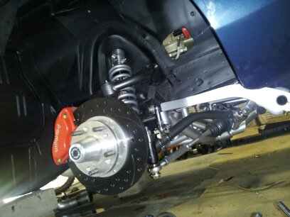

here's some of the parts I have I built 2 of these already,
I purchased 2 of everything almost
1 already done & I still need to do/finish mine, long story
some parts are already installed, some need to be installed still;
Capps/QA1 lower tubular control arms
QA1 tubular K member
SPC adj. tubular upper control arms
Summit 1-3/8" front sway bar
Summit 1" rear adj. sway bar
SSBC 4 piston Force 10 front & rear disc brake conversion
Edelbrock gas shocks
Edelbrock/Halibrand polished kidney slots BFG Radial T/A's
383/479ci Quckfuel parts in the 6bbl
Edelbrock ported alum. heads
full Crane Cams hydr. roller, 1.6 Supergold Rockers blah blah blah !!!
Milodon oiling system & 7 qt. pan
Uni-Steer rack & pinion {I won't recommend it, too limited on headers selection}
custom home fab stepped headers 1-3/4" to 1-7/8" to 4-2-1 Scavenger style collectors
3" mandrel bent exhaust with Series 50 Delta Flow system with a H-pipe
Pro-Car Elite 1100 adj. bucket seat with adj. head rests & track/mounts
S/S 1203 Aeromotive electric fuel pump #8 lines
w-#6 lines from the Aeromotive bypass regulator back to tank
Mancini Racing Alum 3 core large tube down-flow Alum. rad.
custom home fab shroud with 16" Be-cool 2900cfm puller fan
w-a 13" Be-cool pusher fan for just in case
a Mopar Performance alum water pump housing
w-Proform 38gpm electric water pump & A/N upper & lower hoses
3800rpm stall MP Torque Converter reworked, stall to 4200rpm
727tf w-Turbo Action Cheetah rear band apply std shift pattern man. valve body
numerous Coan & A&A internals
B&M Quicksilver ratchet shifter & full round/dual pattern sfi rated Flexplate
{I know but I like the way it shifts & looks}
Calvert CalTracs
MP Aluminum 742 center section, with Yukon 3.73:1 gears
{probably will go with the Dana S-60 from Strange Engineering instead}
I'm sure I missed some stuff, probably about half of it,
but gives you an idea of my style type of build...
Happy Moparing guys

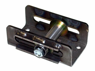

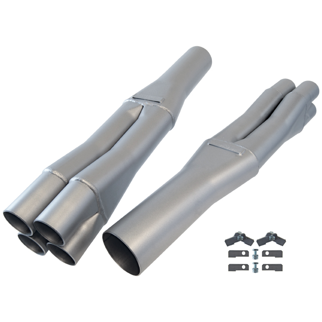

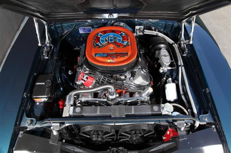

This is the 5.7 I am building for Krissy's(wife) 67 barracuda. Not a B or E but an A My opinion its mopar or no car.
forged rotating assembly
ported 6.1 heads and manifold
bigger 6.1 cam.
Mike if this wasn't going in her car it would be procharged too.LOL

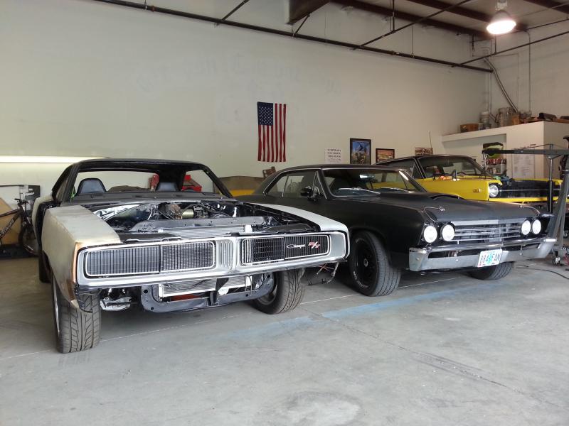

My 68 Charger.

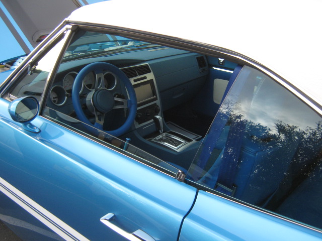

Here's mine, I keep saying it's done but something always pops up. It's a 69 Charger that started life as a 318 auto but by the time I got it it was missing the motor, tranny and pretty much the whole interior so it was an open canvas haha. This was my first Mopar build and I was determined to built every last bit of it myself minus the upholstery work just to see if I could (painfull experience but it's paying off).
Motor..................456" stroker
Tranny................Viper T56 6 speed
Seats..................03 Stratus buckets and 05 Chrysler 300 rears
Wheels................US Mags "Ramblers" 19X10 rears and 18X8 fronts

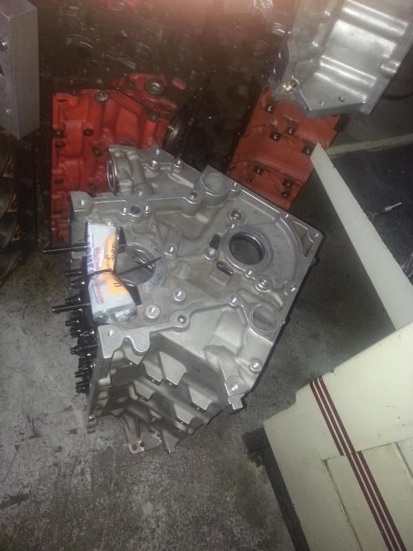

My 66, work in progress. Soon to be a lot more progress.
Gen3 mockup motor
The actual block I am using
Should be a lot of progress in the next few months. Here is the link to the build thread I started waaay back. http://www.forbbodiesonly.com/moparforum/showthread.php?54551-66-Charger-Pro-Street-w-GenIII-426

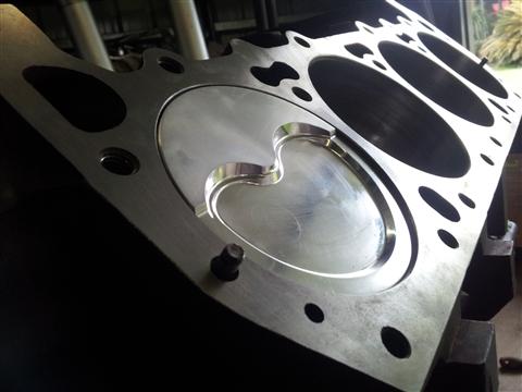

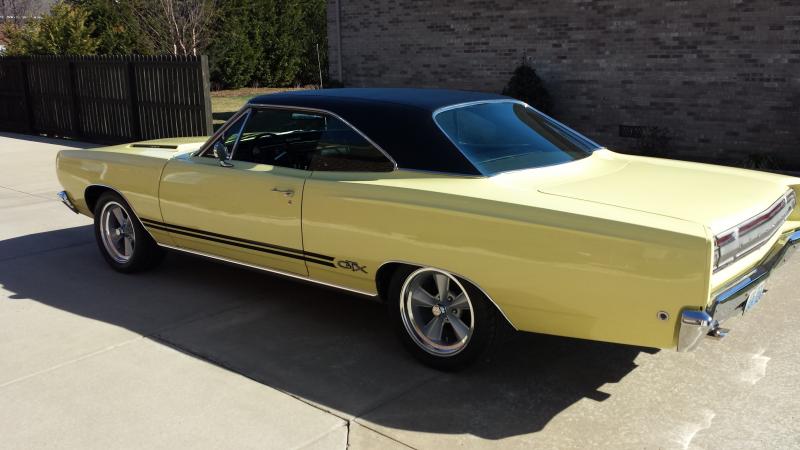

I guess it is my turn, it is a 68 GTX, 440, 4-speed, Dana 60.
20140419_113456.jpg20141005_094129.jpg2015-04-12 01.57.39.jpg20150316_155833.jpg
.060 over
Edelbrock Top End Kit w RPM heads, high rise intake, timing chain and .600 lift springs
COMP XE285HL 241/[email protected] 110LSA, .545 lift- video below
MSD ignition 6AL box
Griffin aluminum rad with Hayden electric push fan
Milodon 8 quart pan with high pressure oil pump
Mopar Performance valve covers and breather poweder coated by Cuda Chick
Hedman Elites ceramic coated with 2.5 exhaust and flowmaster 40's
Hurst competition shifter

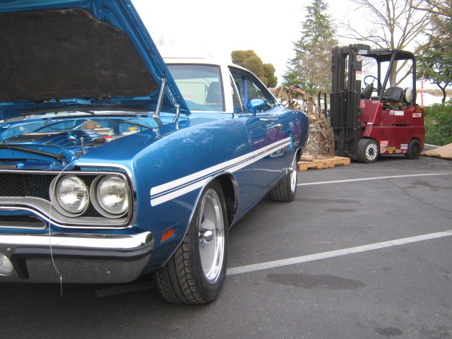

Engine:
440 (7.2L) stroked to a 505 (8.3L), 1976 water block, acid dipped, all new clevite bearings, stainless plugs and freeze plugs. Block was align bored and honed, cylinders bored and honed +.30, block was also decked for 0 deck height . "Muscle Motors" custom made stroker kit was put together for the build including a polished forged K1 crank at 4.125 stroke with ARP main studs, RPM forged H-beam 7.100 rods were used and keith black 26.7cc valve relief pistons were used. "fluidampner was used for balancing along with a comp cams double roller timing chain. "lunati hydraulic flat tappet cam at 250/252 @.50 duration cam (300/305) with lunati hydraulic lifters and comp cams oversized pushrods. Heads a ported and polished stealth aluminium heads with comp cams roller rockers and cast aluminium muscle motors valve covers. cometic MLS head gaskets used with felpro everywhere else and all hardware is ARP studs and bolts. Oiling system is a melling HV oil pump with a milodon 7qt sump, and stroker windage tray with a hemi 3/8" pickup and remote mount K&N filter. Intake is a match ported edelbrock ch28 dual quad intake with 2x edelbrock 500cfm carbs that have been ported and polished, with a custom fibreglass hemi oval air cleaner, K&N air cleaner with airbrushed lid, fuel pump is a massive clay smith mechanical fuel pump which is fed by a "racepumps" regulator, 1/2" aeromotive aluminium and braided fuel lines from the tank along with a check valve and aeromotive fuel filter with a return line to tank. Ignition is MSD 6AL box with a billet MSD distributor which was custom built and phased by FBO, wires are MSD custom made plug wires and NGK plugs. Cooling is an aluminium high flow water pump fed from a "be cool" aluminium radiator with 2 thermo fans capable of 2750cfm cooling power. Also on the motor is a "march performance" billet serpentine belt kit with billet alternator and billet power steering pump. 1 7/8" ceramic coated TTI headers that have DEI heat wrapping on them going to 3" x pipe with dynomax ultraflow mufflers and dumping at the diff.
Drivetrain:
"Lakewood bellhousing and scattershield", "american powertrain" lightened billet steel 11" flywheel with 11" kevlar clutch and a wilwood hydraulic clutch kit put in. Gearbox is a 1976 23 spline A833 4 speed with OD gear, main case was changed out with early style ball detent shifter setup for strength and brand new gear clusters put in and box fully rebuilt, stronger synchros installed. Hurst pistol grip shifter with custom made stainless shift rods for strength, carbon shifter handle, autometer electric speedo installed for the electric gauges. new stronger uni joints installed on the lightened 3" driveshaft. Diff is a Mopar 8 3/4 with the strongest centre the "489" carrier with an "Eaton true trac" installed and 33 spline axles.
Suspension, Brakes, wheels & steering:
Custom silver powdercoated "Magnumforce" chromoly k member installed with chromoly upper and lower control arms with spherical rod ends ( torsion bars were removed) Qa1 aluminium single adjustable coil overs installed, 2" chromoly splined sway bar installed, 2" dropped spindles, aluminium bushes, mustang II rack and pinion installed with power steering, Rear end is a powdercoated magnumforce chromoly 4 link with spherical rod ends with Qa1 aluminium single adjustable coil overs. all suspension is also height adjustable. RSD 8" brake booster with a wilwood aluminium dual tandem master cylinder, wilwood 4 pot adjustable brake bias, Wilwood drilled and slotted 12.19" discs all round and red powdercoated wilwood 4 piston calipers with race pads. All brake lines are custom made stainless lines and stainless braid where necessary. Wheels are custom made "Boze" shifter forged wheels in 18 x 8" front and 19 x 10 rear, polished lip and powdercoated centre with custom engraved Mopar centre caps, Tyres are BF Goodrich g force KDW 2 street tyres in 245/40r18 front and 295/35r19 rears, very sticky handling.
Body:
Subframe connectors installed, stock fuel tank done over and inner sealed, new 1/2" pickup and sender. brand new chrome bumpers, front spoiler, cusom made functional 2" reverse cowl fibreglass bonnet.
electrical:
Entire car has been rewired with a Ron francais wire kit, custom fuse box, LED bulbs in every light on the car, electric windows, automatic thermo fan sensors, vacuum headlight doors converted to electric. Battery located to trunk, Ultima red top 900cca battery
Interior:
Interior is mainly stock besides, autometer electric gauges, pioneer competition grade stereo, flaming river steering column, hidden radio antennae, custom centre console insert, custom rear package tray with speakers installed and baby seat fittings installed. new carpet and custom floor mats. electric windows. new seatbelts installed. boot has been custom made and carpeted.
Stereo:
Pioneer head unit, pioneer 6" door speakers, 6x9 rear speakers, pioneer dual amps, and 2x pioneer 3500w 12" subs in custom made box, with boston capacitor. and fuses.
Recent additions: Hydroboost brake unit, custom ported rpm intake manifold and 1000cfm pro systems carb

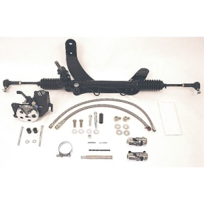

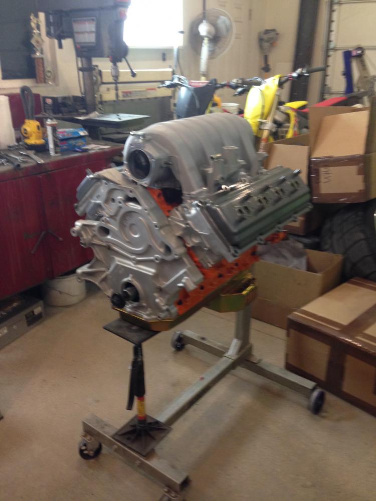

Right now my next 2 big projects on the books are the T56 swap in and Procharger install. Just collecting the bits pieces right now and everything will eventually go in.
Eventually get around to full suspension upgrades and spoke to my bodyguy last week since I need a trunk pan about doing some mini tubs at the same time to give me a little more room under there as I'll eventually go slightly bigger with the wheels and rubber. I love the look of my AR 17's but I do regret not going to a bigger to a staggered 19-18 and likely will end up with a different look.
Most of you guys have seen my "B Body Stiffening" thread so I won't rehash all that here but here are a few pics and basics
5.7, NAG1 from an 07 Chyarger RT. Dash and console as well as all 4 discs from same car.
Haywire harness with a 24 space fuse block and I lost count of all the relays.
Modern Muscle engine controller and harness. Paramount transmission controller
83/4 rear with a 2.76 gear
17" Torq Thrusts with MCP custom caliper covers
Corbeau seats, leather upholstery
HVAC is also out of the 07 Charger
March billet pully system
Custom drive shaft
Autometer gauges
Alterktion front 4 link rear QA1 adjustables
