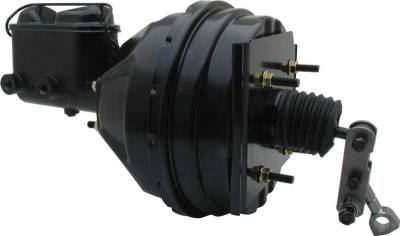

FINALLY I made the order through Dr Diff.....
1966-70 B body dual diaphragm brake booster, firewall stiffening plate and under-dash linkage.
This will sit down lower than the A body unit I have on the car now which means new brake lines to the distribution block.
I am unsure of which master cylinder that I'll use. I have a 15/16" in the car now. Pedal travel with smaller bore master cylinders is always a bit longer but supposedly the pressure is higher. I have other size master cylinders including the new 1 1/8" unit I bought for use with the hydroboost unit that I never was able to get working.
