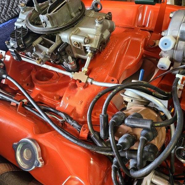

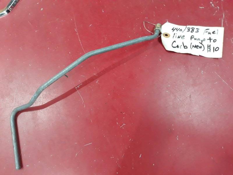

This look like what you need ?

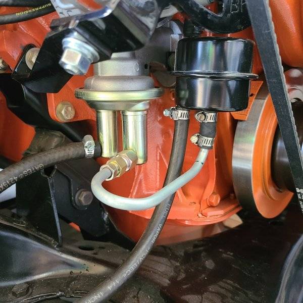

I’ve always been a little surprised how many older engines had factory, short pieces of rubber fuel lines in the engine compartments.
But, I guess back then with straight gas, quality fuel line degradation wasn’t a common issue.
The short pieces of rubber hose allowed easy fuel filter replacement and the whole thing was cheaper to manufacture.. In theory, the filter could have a inverted flare fitting on one end. (can't have it on both ends unless one was left hand thread) Some models do. You don't need the rubber hose for flexibility. (engine torque) That's why there's rubber on the fuel line to the fuel pump.
The rubber hoses are there for vibration and engine movement.
I learned to keep the rubber fuel lines less than 12" to pass tech at the track. The factory used a short section at the sending unit, a short piece from the frame rail to the fuel pump and very short pieces for the filter. The line at the sending unit and frame rail are under very low pressure and only the short pieces at the filter seeing pump pressure.
The only rubber pieces on my set up- will be from pump to line, about 10" or so, and from line to metal line from fuel cell. Both down near the frame rails.
I had Fine Lines/SSTUBES make me Stainless steel lines to replace the EFI rubber, so the only rubber will be at the filter, and the fuel tank using EFI pressure hose, with EFI band clamps, not the worm style clamps. In my opinion, and from what I know since working on cars since the 80's(late 1900's :) )Worm style should be avoided in my opinion, because the can damage the rubber when over tightened and over time, could be a way for the hose to leak.
Not to get nosy, but why? I would assume the engine moving and rubber degradation might cause problems long term. I know repops are available for a lot of cars, or make your own. If you do't have a pattern, use #9 copper wire or coat hanger to make one and brake line from the parts store.

I believe NHRA allows only a foot of rubber line Total....too many cars have burned up from these hoses that deteriorate and the worm clamps loosening up, or no flange on the end of metal line to keep it from sliding off when loose....etc.....I could go on, but you can make one fairly easily out of tubing or buy the factory ones. The factory pieces are pretty safe.
