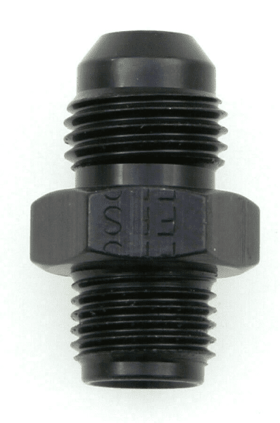

You can use rubber (or whatever the ethanol rated stuff is called) between the fuel pump and carb but as Sam pointed out, it will be subject to more wear than metal. Another option is to use braided 6AN line. It's a little pricey but looks way better than rubber and is less prone to wear.
Use a PTFE rated braided hose if ya go that route.

I wouldn't go with that length of rubber hose from the fuel pump to the carb. Too many moving things and heat around there. Totally go with the AN lines. Here it is for only $14 on Amazon.
How do you cut that stuff? I've tried before and it gets all frayed and a complete mess. No to mention stabbing yourself with 1500 barbs.
wrap the hose with electrical tape at your cut line and use a cutoff wheel to cut in the middle of the tape.
If your not using AN fittings, leave the tape on
Personally I'd go with AN fittings over using hose clamps with covers for a neater install, but that's just me

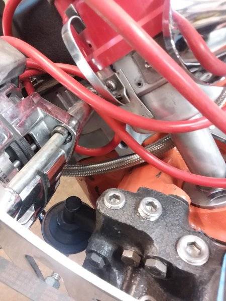

I just made a braided steel -AN fitting fuel line for this very purpose. It was easy. Just get braided steel line with PTFE rubber hose insides, mark where you need to cut, wrap TIGHTLEY with electrical tape, cut in the middle of the tape with hacksaw with lots of teeth or a cut off wheel. Use the cut off wheel to nibble away any stray ends, Clamp the female fitting in soft jaws of a vise, or do what I did and hold it against the side of your workbench while pushing the line into it hard and turn the fitting with a AN wrench until the line is seated all of the way in the fitting. You can tell by looking into the other end and see it. Once you have that, wrap the line with tape right up next to the fitting so you will be able to tell if it pushes back out in the next step. Then take the male fitting half and push it into the center of the rubber inside line, use some WD-40, or assembly lube, screw the two half's together while watching your tape to see if it pushes back out on that end. Yer done. Remove the tape. Make the other end. Bolt it up. While pushing the first end into the female end you may have to use a box cutter blade to stuff any stray ends into the fitting as you push it in. Once it looks like the line is started into the fitting okay pull off the tape. Once you get into it , it will become obvious what needs to be done. But that's how i did it. Also I needed specific AN fittings for each end. The fuel pump end was a 6AN flare x 5/16" tube thread inverted flare. The upper end went into my fuel rail and was a 3/8" inverted tube thread flare x 6AN flare.
