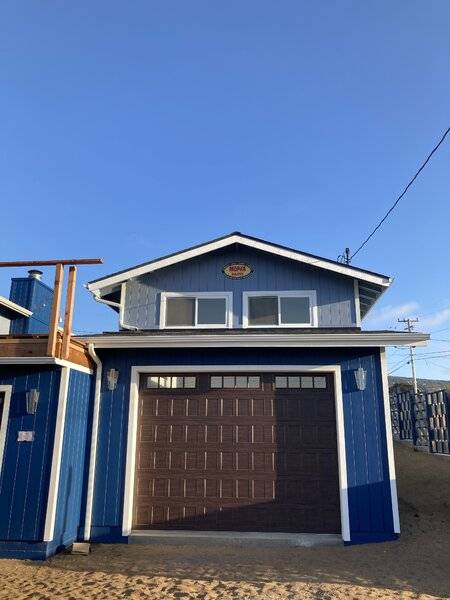

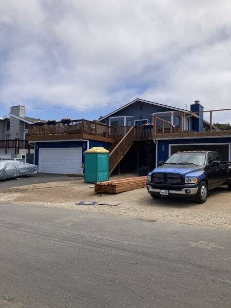

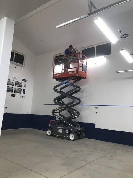

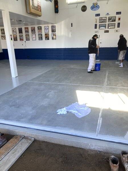

Since we are in a beach town, we went with stick built. We didn't want it to stick out like a sore thumb on aesthetics. Metal would have been way less money and far faster on the build. You can insulate metal buildings too. You can sometimes score on a metal building package that a customer flaked out on. There are the usual industrial looking units but there are some really bitchin looking metal ones too but they cost more. There is a manufacture in Paso Robles that makes one out of pre-rusted exterior panels. They use that for barns and at some of the wineries. When I saw a picture of it, thats what I wanted but my Feng Shui director, wife, reminded me it would look out of place here. With my new one, I have 1125 sq ft of space on the floor, 9' or so height on the short section which has our deck extension on the topside and the other side is 18' at the peak which will be the side my lift goes on.
F77668CC-D021-4A46-B16E-81C1B8FF1F0D.jpeg 4C240B6D-DD77-40B7-B44B-CB1D6F5530F4.jpeg 75BEC15D-92C8-4D95-BC17-1820E87F57BB.jpeg E67D99DB-FF32-4D41-A1CC-8D0C280DDEAE.jpeg 1A226BCB-6DAA-4CF9-914D-C37F60209210.jpeg

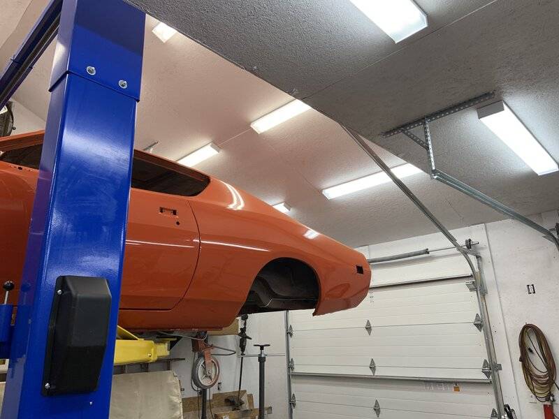

Depending on how big your garage is, use roll up doors. That gives clearance for when you have a car on the list.
Yes I think the roll up doors seem better for clearance not sure about if they come insulated but I have seen regular insulated doors go up at an angle in I beam garages
That's how I ran mine. R19 Cloplays. Roll ups were $$$$ for insulated.

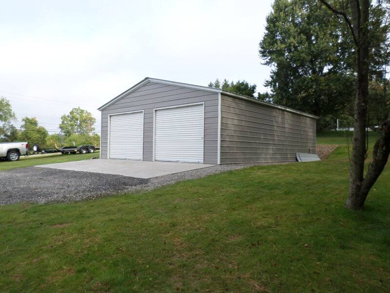

I built my shop with all metal 20x25 with the plan of it being a paint booth.
Looking back at it now I would have saved time and money using a wood frame. As for it being a paint booth after I got finished it was too nice to have paint spray all over everything so
I bought an inflatable paint booth which I would strongly recommend because it cost less than what it would have to buy vent fans for the shop I built hope this helps

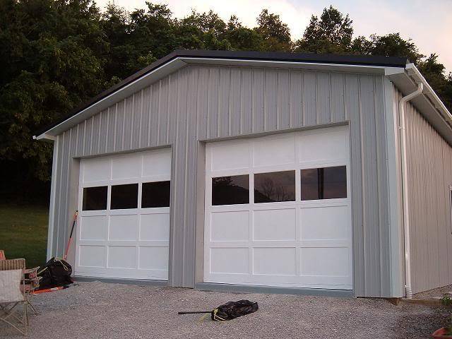

For the budget I had back then and for the square footage I wanted (and get more, because it never winds up that you have enough!), I went:
It's been up over 15 years now and has been zero issues:
Colors match the house pretty much, although metal siding patterns aren't quite exact - close enough.
The doors are bigger than what they sell down at the HomeyDepot and are about 40 years old - they are solid wood, some inches thick, and heavy as hell (my brother found them in Atlanta when a customer was installing modern doors at their estate).
I got a spare door out of the deal too - and plenty of room when pulling the Ram in, which was the goal - all for $300.
Although the building is metal and has open web joists holding up the roofing stringers, it is anchored by massive 8x8 pressure-treated columns, set a minimum of 5 feet in the ground and incorporated into the floor/footer pour.
The building was built to a PE-stamped spec and is designed to withstand 140mph wind and the snow load is ridiculous - like Nanook of the North levels of snow load.
The garage is our official tornado shelter.
Not kidding...
Can you tell I wanted to do this once - ONCE? :)

moparedtn Correct, wood prices slipped my mind they went up tremendously, why the 8x8 wood columns is that part of the specs on that vendors choice. What company did u go with.
The columns were exponentially cheaper in wood than what the equivalent would have been in steel - not to
mention, the steel columns would have been special order, taking time to get ahold of.
Of course, any time you go below grade with steel, there's that chance of corrosion and such, too.
In the end, time and money made me go with the wood ones (the specs gave a very specific choice) and 15 years
later, everything structurally looks like new with the thing - and damn solid.
The way the bracing design is at eave level, with cross-bracing as well as longitudinal, keeps the structure square
and gains those ratings for wind and load.
As you might imagine, those freaking HEAVY doors took a bit of doing to install and I thought for sure I'd have
to add reinforcement for them - but the specifications apparently allowed for such and in the end, all I had to do
to install them was to use the heavier hardware, hinges, rollers and such - not to mention the tracks.
3/4hp openers handle them just fine, too - and the building doesn't so much as shimmy when you hit the OPEN
button on the door remote. :)
I learned more about garage door installing than I ever cared to - especially about winding the springs on them!
As far as vendors go, it was a local company with a good reputation - but they learned a little on mine, too.
The design is basically a "pole building" design gone beserk and they'd never done one all finished off in the
soffits and such like I made them do. :)
They enjoyed the uniqueness of the job and I made sure they were well fed and watered the whole time, too.
I'm sure the same thing can be done with local builders around you, too - the basic design of mine is readily
available nationwide and is tailored to the region you're in.
Just make sure you get an architect or engineer to sign off on the specs if you vary off pre-packaged designs.
Good luck with it!
