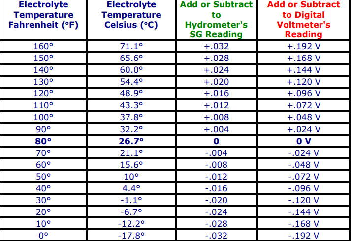

The trace looks like it's on a rev limiter. There is no way a fuel issue could be that quick. I'd say you have a distributor or ignition box issue. Though I never discount the idea of a bad ground. In this case I don't think so. Doubt its a coil either. Why? Because it's rpm triggered. One other posibilty. The tach. Does it have a rpm limiter? As for the battery. 12.66 is 100% state of charge at 80 degrees F. If the temp varies so does the state of charge level. My bet is it's fine. See here
