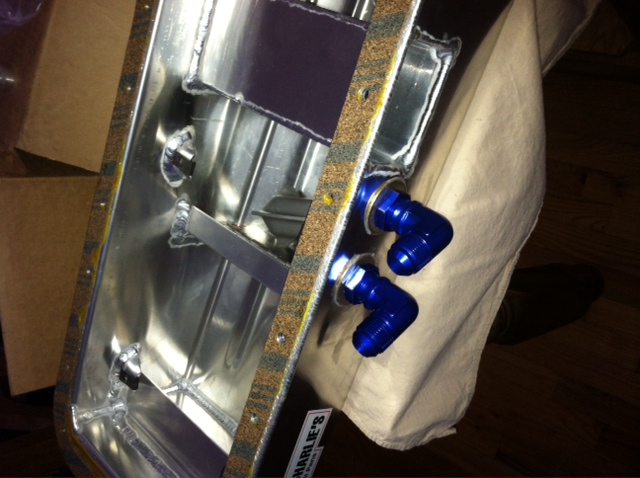

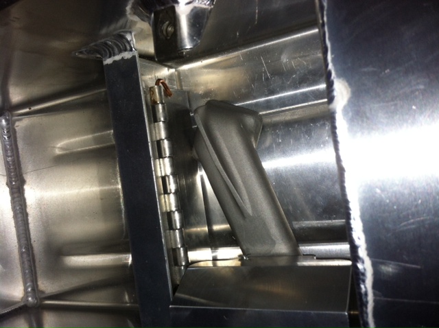

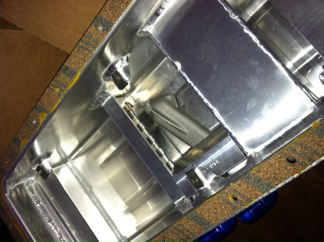

will this work? .just got it all mocked up.

as long as you have the clearance under it so as not to suck to the pan you should be good to go .
Look rite from what I can see.
swinging pickup hits the trap door, only swings 25% one way, towards the door,other way is fine.
my concern is swinging pickup gets caught under door when its on decal and getting jammed permanently in that position,defeating the purpose.
I would think the oil would slam the door closed before that happens ? But if I am ask Why run a Swinging pick up in that style pan ?
That pan has the doors and baffles to keep a static pick up coverd .
I never used a swinging pick up as I alway baffeld the pan to keep the oil where it need to be.
I am running a static pickup in my 65 blue dodge now and im getting 0 psi oil pressure at decel with a trap door for 8 seconds. none of my other cars with swinging pickup ever lose oil pressure so I bought this pan with swinging pickup.
its scary watching your gauge for 4-5 seconds have no oil pressure even with a accusump.
Well with that being said I am with you !!
I don't drag race anymore . I just turn left and stick her sideways ! LOL!!
I realy don't think you will have a problem with the set up as it is. The door will be closed by the time the pick up gets to it.
I mean thay made it that way and there suppose to know what there doing ?
