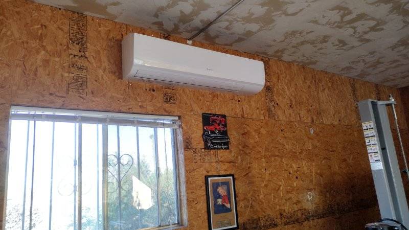

My garage is 1130 sq ft and has 12.5 ft ceilings. I have both swamp and a mini split. The mini split is a 3 ton Gree. I was told regardless of brand name all mini split are manufactured by Gree.
Anyhow, the mini split works fine on triple digit days IF you keep it on to maintain a temperature. I program it for 82F on weekdays operating from 9am to 9pm. Then on weekends, or when I'm working in the garage I'll manually set it for 77F.
If you have a hot garage on a triple digit day it will take about 8 hours for the mini split to cool off. The "turbo" mode seems to be a gimmick as I believe it cools best with the vents pointed upward and automatic fan.
I'm a little disappointed the mini split can't cool off a hot garage, but if you maintain a temperature all the time they do seem to work well and electricity wise seems to be really efficient.

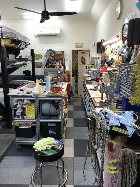

Installed near ceiling.
Mine is up at the ceiling too. Also my ceiling fan is shown. If it goes out I may look for a little larger one but I have to keep clearance for the car on the lift. I agree with all of the above comments on trying to cool down a hot garage. It takes quite awhile. Sometimes I run it at night and turn it off during the day as it stays pretty cool in the spring and fall during the day.
