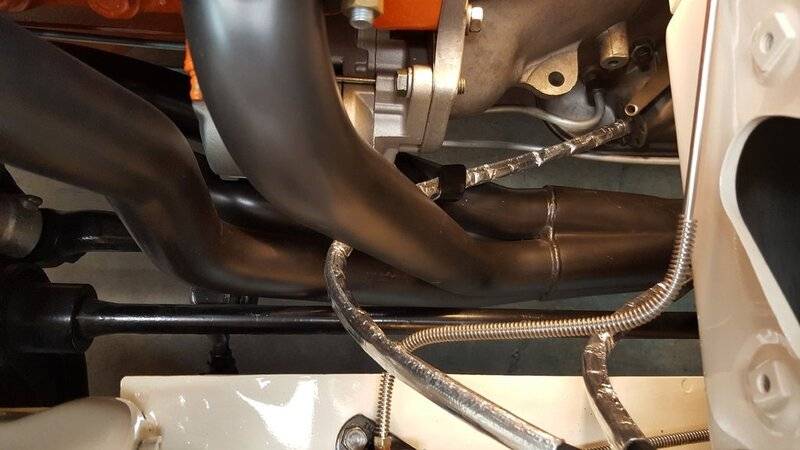

This pic might show what you're looking for.

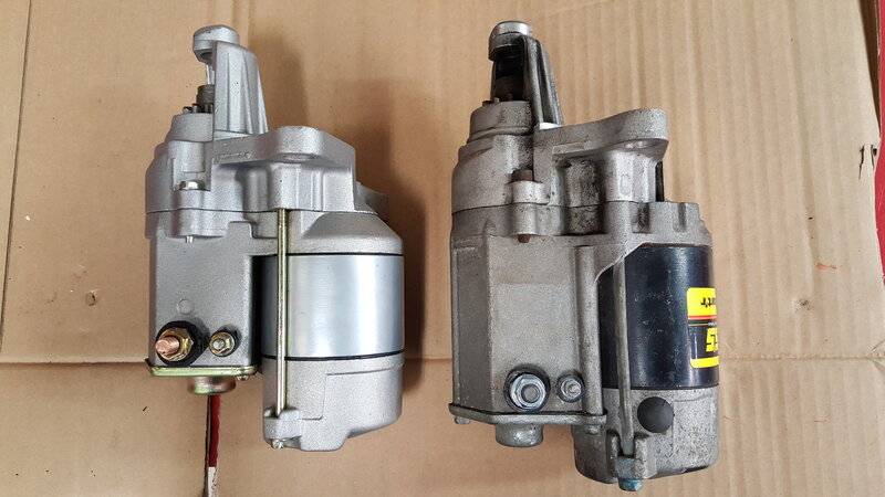

Here's the difference in length that I found.
Thanks, good picture but I can't judge the distance below the solenoid to the pipes. The starter I want to use has the solenoid at the bottom.

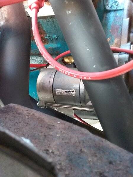

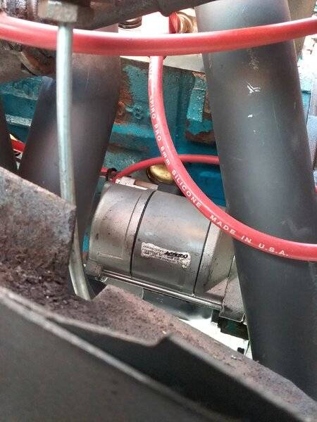

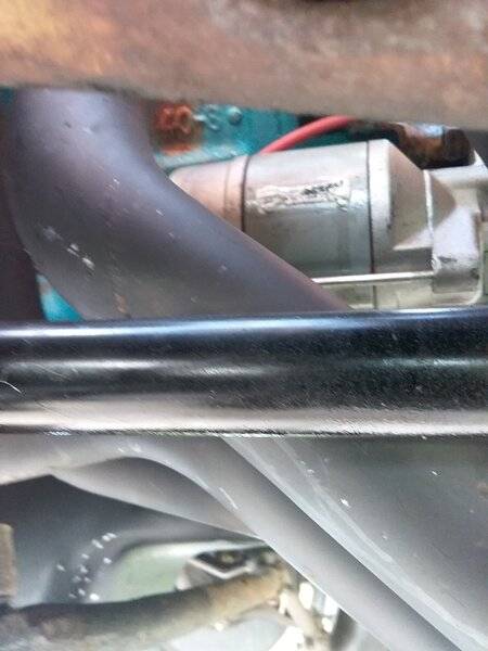

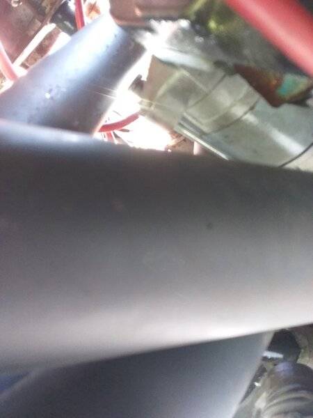

here are some pix of the starter and headers. It tough to see in the pix but there is ample space
Hope this helps
