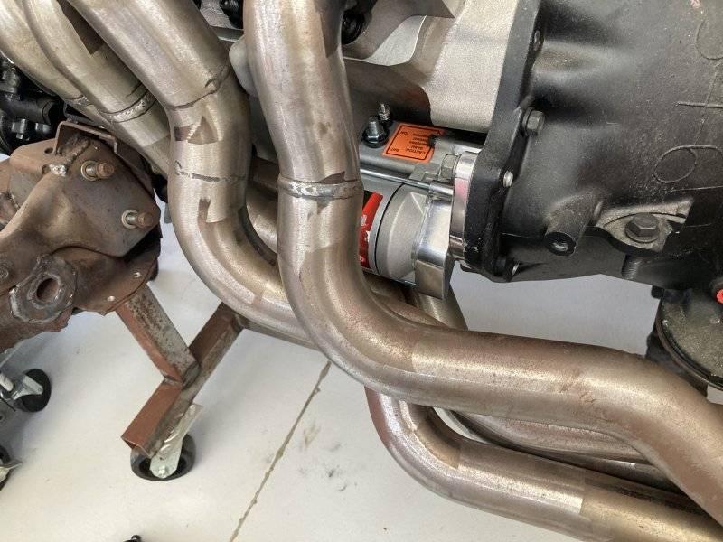

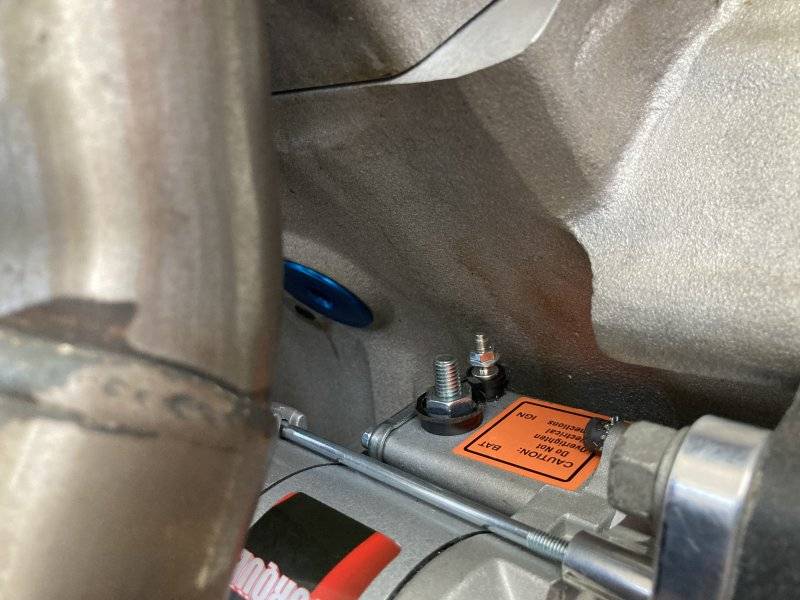

Hi,

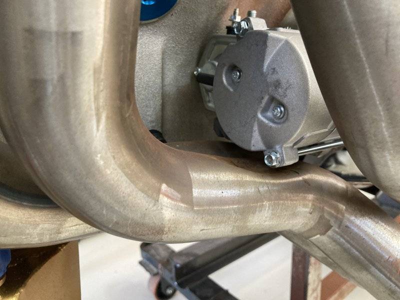

I have a 400 block with TTi 2" x 2 1/8" step headers with a chrysler mini starter part number 3005984 with an 11" flywheel. According to the TTi website the 11" flywheel and ministarter will not fit with these headers. I learned this the hard way and saw my mini starter sitting on the header tube. ok fine, so they say to order a RobbMc mini starter to clear. Now ive heard from people trying this that the RobbMc mini starters have went to a larger design that touches as well. are there any mini starters that dont touch at all for this setup or am i smashing these headers with a hammer no matter what?
...follow up topic... i heard that the stock z bar on a b body touches as well and wondering how much "hammer work" will have to be done there too? dont really want to go to hydraulic clutch.
thanks in advance,
-Steve

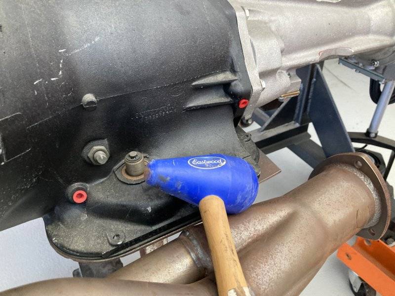

I had to massage mine. One of the reasons I ordered my TTI units uncoated. There were other, non starter, areas to massage even though they were listed for my combo. I used one of my plastic mallets on the offending areas after marking. Used the Powermaster unit thats clockable, found the best overall fit after 4 different settings, massaged as needed.

i seem to have decent clearance on the bottom side of the starter. top side is what touches. id rather be close on the bolt vs the body of the starter like mine. worried the thing will cook!
Use wood against header. A regular mopar starter wouldn't fit without major a major beating?
You have any pix of new/old style MC/Robb starters?? The older (I assume) were fully clockable 360 degrees and I don't remember mine sticking out at all like your pix show. However, they do tuck in so tight, that you may need to do some block grinding on the "B" engines to fit one at all. But I'm pretty sure the header clearance is much better than that, and that's probably why TTI recommends them.
There were NO Powermaster starters that worked for me.

I 100% agree. I had to smash my Doug’s headers all to heck to get them to fit. Paid up and got the TTi and still issues with Z bar and starter. I’ll order the RobbMc starter. Did some measurements and I think I’ll be ok but I have to bend the Z bar or smash the header to clear that for sure.

Apparently the new ones are slightly bigger housings but after some measurements today I just went ahead and pulled the trigger to try it. Z bar is a different story. No easy way out there. Tti makes an adapted bar for A bodies but not b bodies. I’m going to try modifying mine to clear without smacking the header too much with a hammer.
Ever since seeing engine masters header smash episode, "adjusting" headers doesn't bother me as much as it used to. I DO agree that an almost $1000 set of headers should fit, without having to buy a $300 starter.

I don't think I've ever had a set of headers that didn't need adjustment . Currently, a set of old hookers that had to have the collectors lifted with floor jack to get them off the ground (not literally, but close). Number two, I checked fit of the high dollar custom headers, sent em out for coating, and when they came back, they wouldn't fit the new heads with the raised ex ports. Oh well, get out the hammer. Ended up making angled flanges to tuck em closer to the block.
Third set, also custom made, fit good, tight to the floor, under the rollcage down arms, except..... I wanna run a raised port head, and that will make this hit the down bars and the floor. Oh well, I guess no raised ex port heads for me.
For the o.p., I would adjust the headers, and build a heat shield for the starter.... or at least use a heat wrap on the tube that's too close. Or, all of the above.

I’m definitely going to make some sort of heat shield, you are right. Just a shame to pay good money for polished ceramic
Awesome!! Post up some pics of the new starter and the install once you get into the thick of it. Yours is the first mention I've seen about the new/old difference.... I have some pix of the old style and install here, IIRC. Maybe we can help some others down the road??

will do. fingers crossed it works. ill post some pictures of how i handle the z bar as well. think i just need to bend one of the arms
