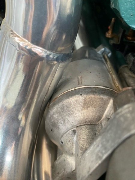

Mini-Starter B block headers touching
On my 512 the starter clearance was like 1/8" of an inch. Bought some lava wrap took it apart and the put it over the areas in question and between the starter. Its been that way for 8 seasons. No issues. But I was very concerned when I got the headers.

That’s impressive. I’ll see how this RobbMc starter fits. From the measurements it should be ok but I’ll post some pics when it’s done.
Must be a "B" block issue. The 2 1/8" tubes probably doesn't help.
I have the D452 Doug's on my 440 with no clearance issues at all. They are 2" tubes and require the mini starter. I bought a run of the mill Dakota starter and there's plenty of clearance. No heat shield or starter rap.
Back in the Seventies I had a '64 Dodge with a 383. Bought a used set of Doug Thorley headers from a guy who had them on his '67 Plymouth. I used the factory starter with no issues. Both the header and starter had to be loose and installed at the same time. No hammer required.
Installed the RobbMc 3005 starter today. It fit really nicely. There is a warning that if you have 130 tooth ring gear you may have to clearance the block but that’s not my situation. I clocked the solenoid at around the 1 o’clock position and had tons of clearance all the way around. It’s not a cheap starter but I didn’t have to bash my tti headers so pretty happy about that. I haven’t tried engaging it yet so I’ll have to see how it sounds but the measurements say good engagement.

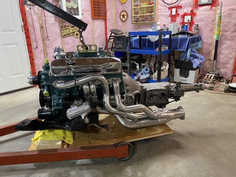

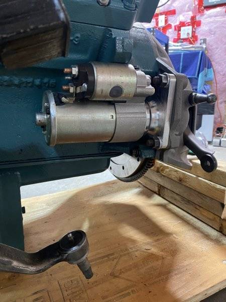

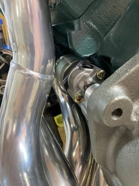

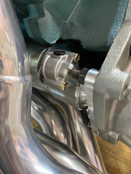

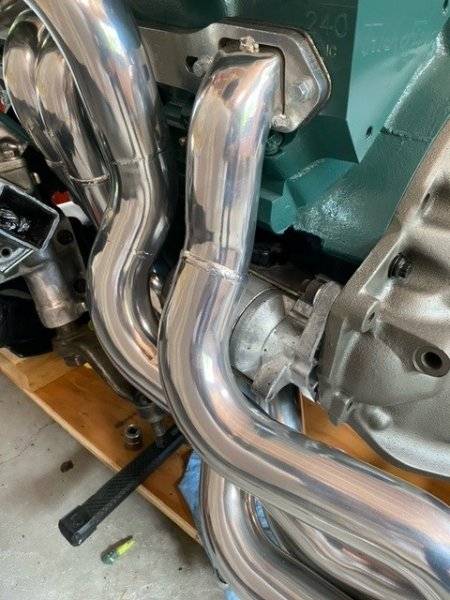

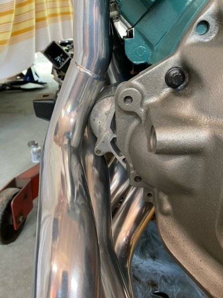

I have a 400 block with TTi 2" x 2 1/8" step headers with a chrysler mini starter part number 3005984 with an 11" flywheel. According to the TTi website the 11" flywheel and ministarter will not fit with these headers. I learned this the hard way and saw my mini starter sitting on the header tube. ok fine, so they say to order a RobbMc mini starter to clear. Now ive heard from people trying this that the RobbMc mini starters have went to a larger design that touches as well. are there any mini starters that dont touch at all for this setup or am i smashing these headers with a hammer no matter what?

Was the Powermaster you used a 9523? When I called RobbMc they did tell me that they are now making a Generation II starter which has a bump sticking out on the header side. My Gen I RobbMc fit with a little side clearance however hard to tell how much as the previous owner wrapped the TTI tube running past it, the previous owner also had to dimple the tube behind the starter about 3/8 on an inch.
AI believe a single Remflex would still be thicker than 2 Felpro's.
Thank you. In the end a Powermaster 9523 mini starter was ordered as well as a set of Remflex gaskets. The Remflexes are 125 thou thick with a 50% crush and the Felpros are 60 thou with no crush. I am hoping once the gaskets come in they won't crush the entire 50%. On the driver side the previous owner had a doubled up set of TTI gaskets which are 1/16 inch thick and have no idea if the TTI gaskets have a crush rating..
