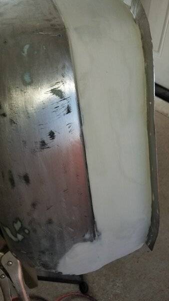

Have you got those welded in yet? I trimmed mine to mimic the factory rail shape. I think it looks better.
Mike

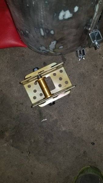

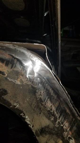

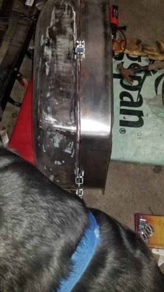

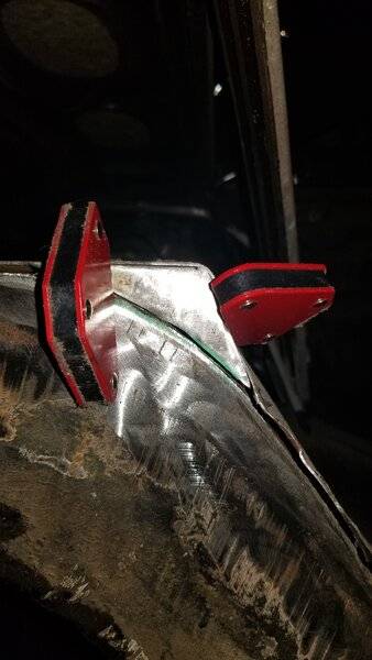

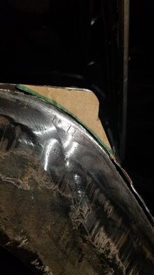

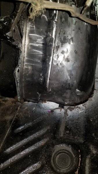

Not yet I can't purchase the welder I want until this virus is over. I have one tub ready to weld and purchased a set of Afco roller shackles. I still need to sand the trunk and cut the drivers side frame. I left the lip on the inner fender

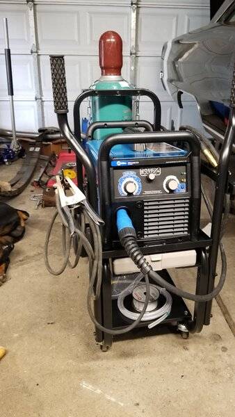

My new toy. Its been 20 years since I used a welder. This company I worked for in Taylor MI sent us out to Indiana to get training in mig and tig. The company was Arvin we did exhaust for the Cadillac. Millermatic 211

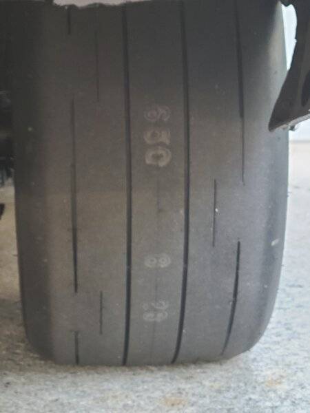

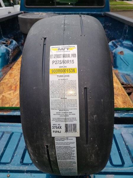

My 255 60r 15 Mickey Thompson tire would rub on left turns with 15x8 and 4.5 backspacing. Iam hoping to run a 295 60r 15 if possible. McCormack racing is a couple blocks down the street they have a big selection in stock

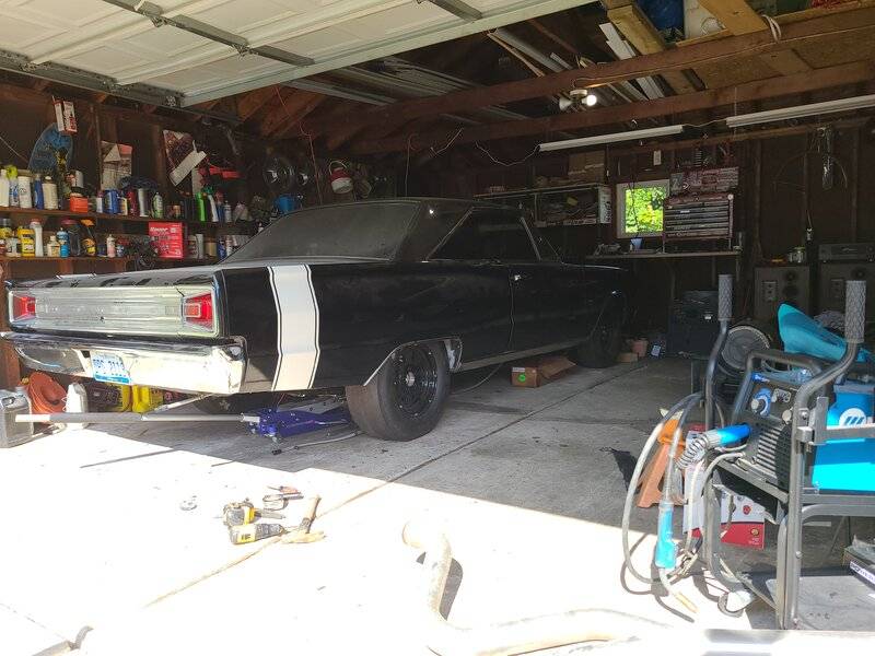

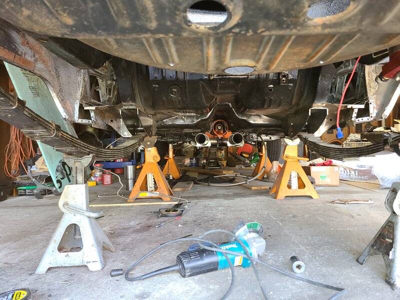

Before putting the wheel tubs in for the last time. I welded the trunk pan back to the frame and patched a spot on the frame

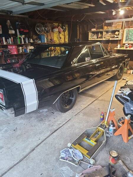

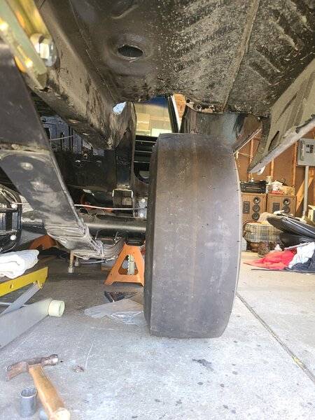

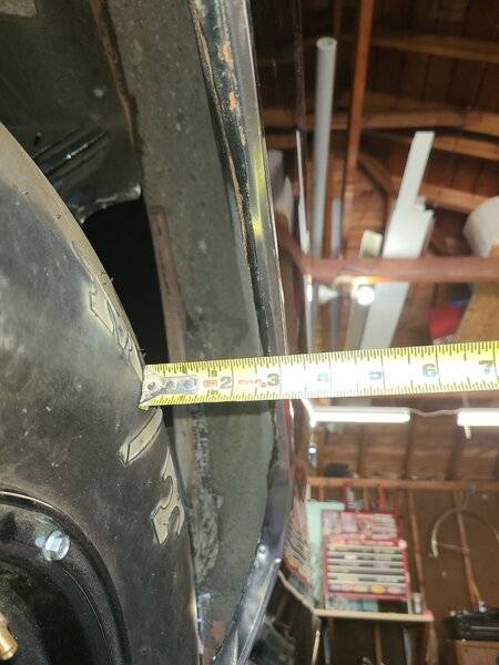

Mocking up the rear kept the old perches on for reference. My old 28x9 with 5.5 backspacing would hit the leaf spring now I have plenty of clearance. I have 4 inches to the leaf spring

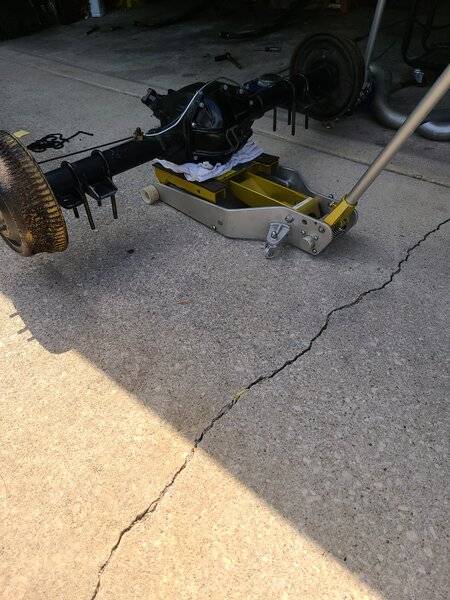

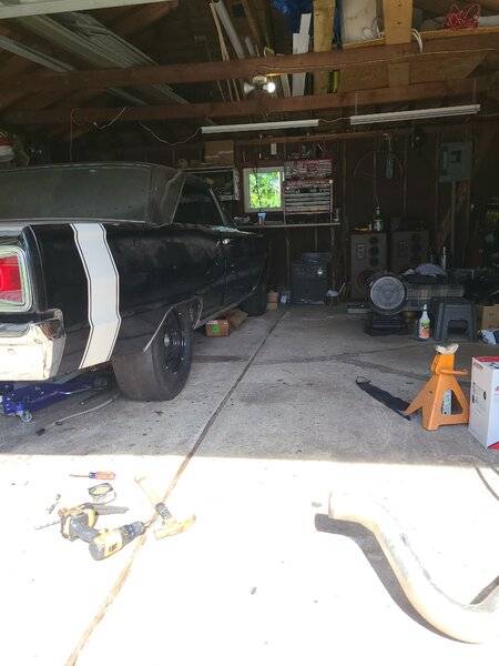

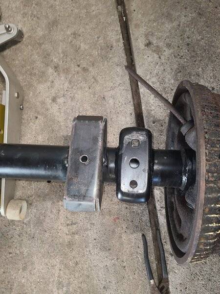

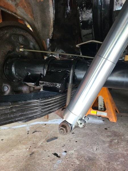

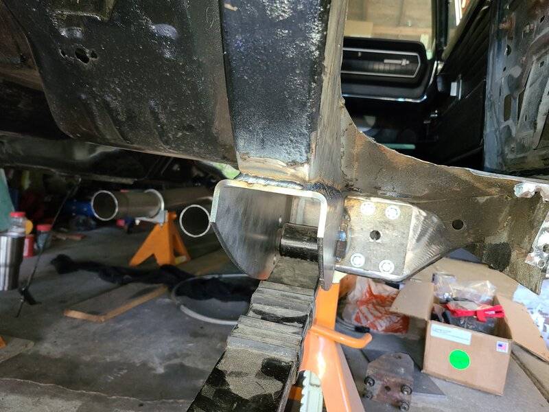

Finally have the car on the ground setting pinion angle and welding the perches on. The 28 inch tire gives the car a nice rake
Used this HF motorcycle jack for several jobs low profile excellent for transmission jobs and differential.

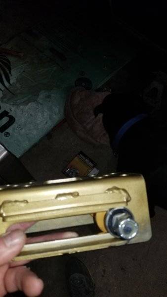

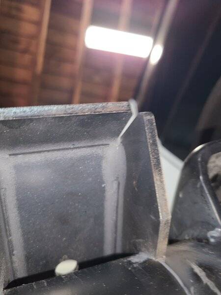

Spring perches are huge from US Car Tool compared to stock should be easy to box in

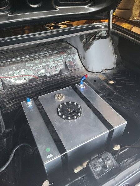

Well the trunk is going to be a winter project. The perches are boxed the interior is done and she got a bath

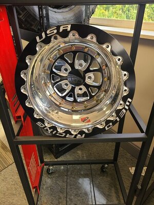

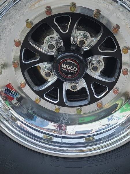

Going with M/T for the street. Six weeks before my wheels are here. Tires are nationwide backorder
Love those wheels, What backspacing did you get? Any full side pics of car with new wheels?
