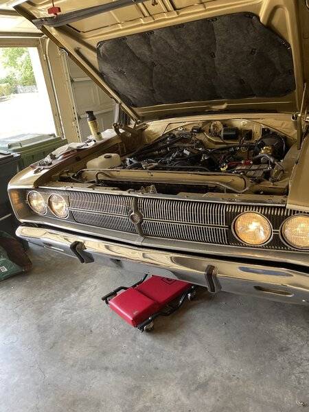

Mn Gold has lights!!!!
Took everything apart, cleaned it out in some new stuff here and there. Got a few gremlins still, but progress made.
1. Issue: when I use the turn signals it wants to blink both tail lights
2. Issue: Headlights come on, but right one does not come on when not in high beam
I would try a different headlight, if you haven’t. Possible t/s switch problem, poor ground for taillights?
New harness, ground seems ok, but it’s interesting that both tail lights blink like an emergency brake . Interesting

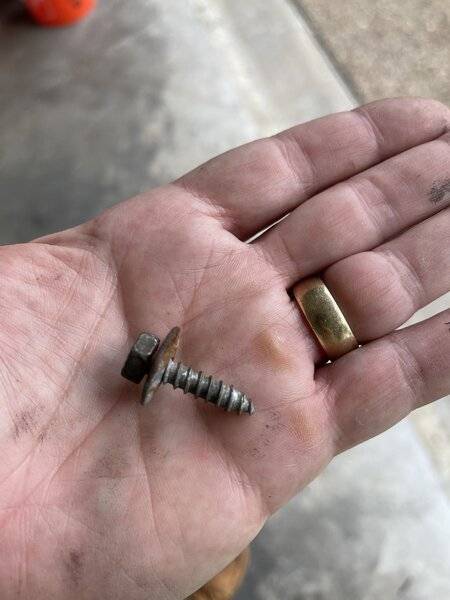

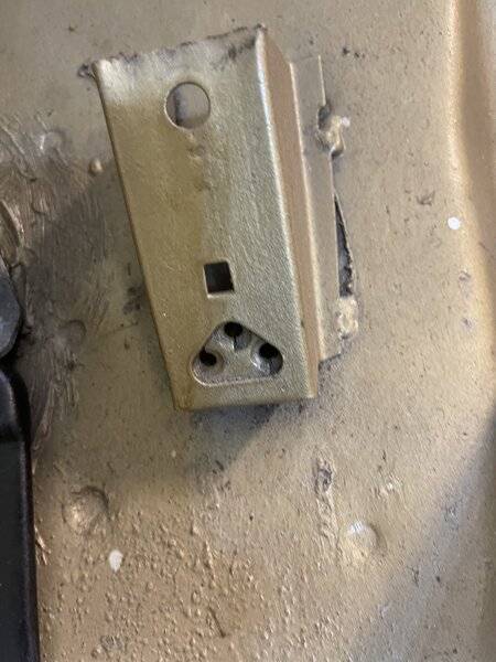

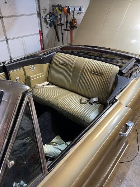

Ok, almost ready for seats. It seems I may have misplaced the two bolts to affix the rear back seat upper . Can anyone verify what those two bolts look like?

Check the high beam switch those tend to burn and give you headlight issues. I just replaced mine and added a new pigtail solved two problems
no headlights sometimes and a burnt plastic smell
Replaced it, along with a vintage NOS headlight switch I'd been hoarding. Works great now.

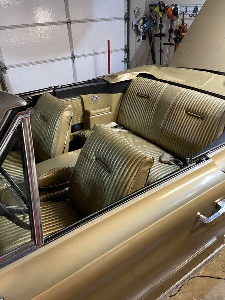

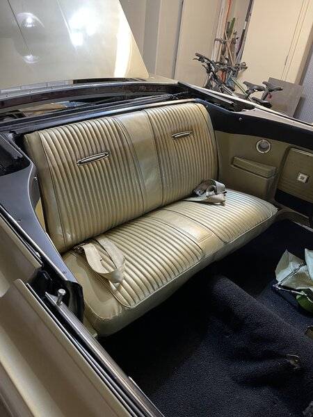

Front seats looking good . Sort of sprinting to the finish a bit, but all that’s left is the top, and I’m getting that done.
View attachment 1139010 View attachment 1139011
I was going to take a look at my Belvedere to see exactly what was there and there was nothing that looks anything like your bracket. I'm wondering if I knocked them out or if it's different because my car is not a convertible? I took my back seat out years ago while I was still driving it because I was sort of using it as a truck back then......
