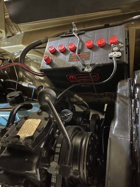

Looks really good in the car

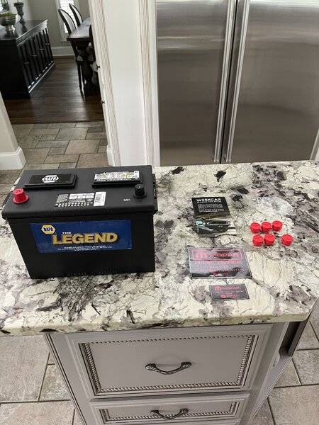

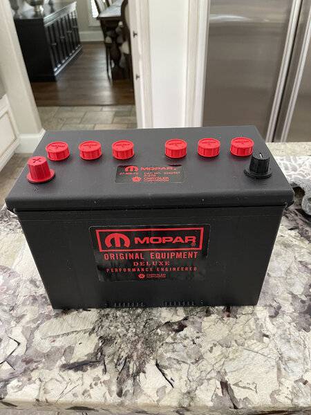

Actual battery. This thing is very, very close to the old school dimensions. NAPA sell sit right off the shelf. Caps on new battery pop off, leaving six 3/4 holes to plug the red caps into. Battery deck and face are smooth so the stickers go right on.

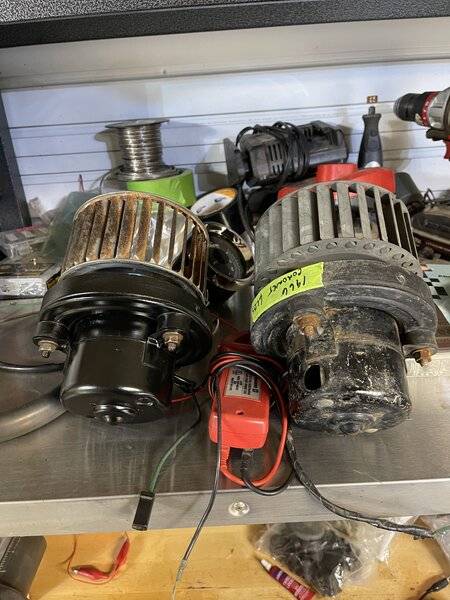

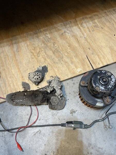

Just about done with all the electrical stuff and got around to testing out the blower motor. Spins freely by hand but no go. Got the power supply on it at 12 volts….nadda. Pulled the unit and found a surprise…..
33EDD64E-7826-4216-9FD5-2EAFFEE82FCE.jpeg EFFFE7B0-7FEF-4D82-A374-04A519F6E8FB.jpeg
I'm assuming the motor is bad, but will take it apart to see if I can service it, polish and clean up the coils/windings ect.....
Ok, motor not bad. I just did not add enough current. Motor was great . Just cleaned it out and added some grease to the bearings

So got the old and replacement apart….cleaned and lightly oiled with lithium grease….just a touch. These things turned out great Very strong after cleaning.
I may sell the 66/67 one …. Squirrel cage is perfect. Mount seal is good too
Cages are a bit different between years . 66 is way more detailed with nice access points for the hex key….but the 67 seems to flow better

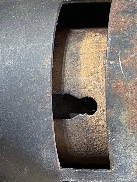

Been working on the reverse lever pin issue and had to pull the column…again.
having done that, I noticed that the pin hole is different than the two I’ve seen so far, but lended a solution just as nicely.

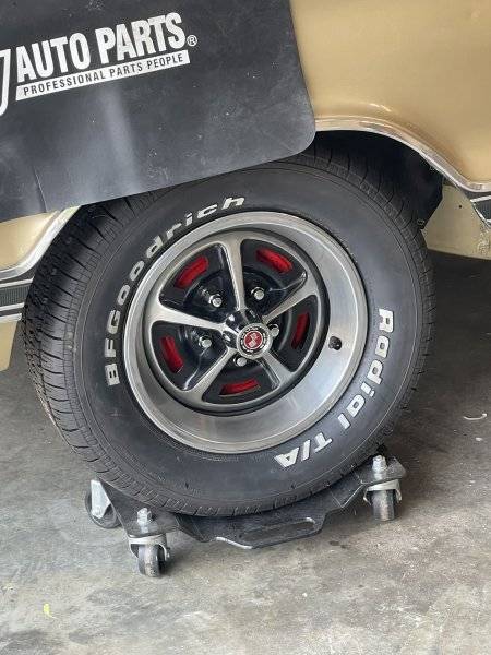

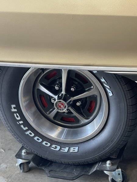

Ok, trim rings and centers on. Took so much to get these 500’s back into shape….but I’m proud of them
