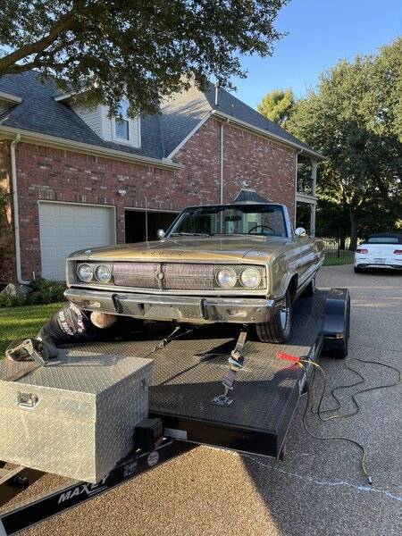

The Gold is getting a ride from a Chevy. Going in for a proper tune and transmission check out

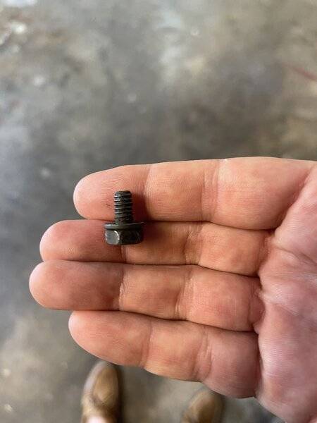

727 shield bolts
3/4 total length 1/2 just the shaft

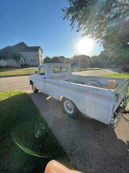

What year 1960's pickup is that? Spent a good bit of time in my dad's 65 and drove it quit a bit once I got my license. Found it pretty fast that you can't shift them quickly lol

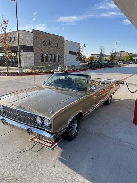

Gold made it to the gas station for the first time today since Carter was persistent!
Filled her up , but noticed a leak when I got home at the sending unit seal. Drained 5 gal out and will see if it’s loose or if I got the o ring seal goofy

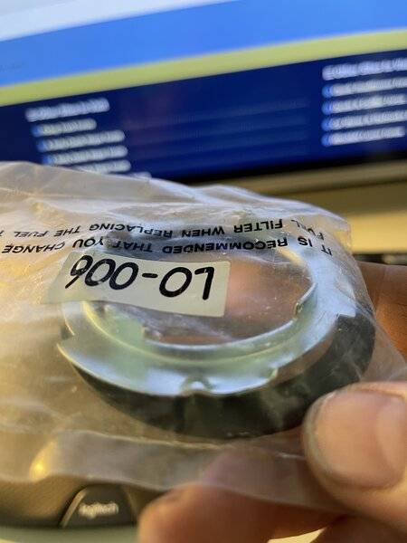

Is it a new tank/sending unit/seal?
Not sure if you are aware, but the lock rings that come with new tanks are thinner, easily bent junk.
Also, the seals are not good quality, either. Mine didn't last 2 years
I replaced my seal with a red toilet flush valve seal from Lowes.
MUCH better quality.
Well, Gas leak issue was pretty straight forward. Putting the gasket seal on the wrong side of the sending unit....(wtf) was pretty clear. Getting the sending unit out and getting it figured out was not hard. Just FYI, no need to remove the tank on this issue or sending unit calibration. Just get the car off the ground so that you can center yourself under the rear diff and then back the retaining ring off, and carefully pull the sending unit out while rotating it clockwise. The float may required you to push it down slightly to get her out.....but it will come out fine. Getting the ring back on can be a bugger, but if you grind the ring edges down a bit (like a nice slope edge) and press with a little force, you can get it started enough to use the special wrench to get her snug. No leaks so far, and that's with the standard OEM brand name seal.
.....ok, slight update. Locking ring is a bigger pain in the *** than expected. The fact that one needs to rotate it clockwise until is locks on the indents slipped my mind.....until it leaked like a sieve. Needless to say I got it on there correctly in-car, but needed a few more steps.

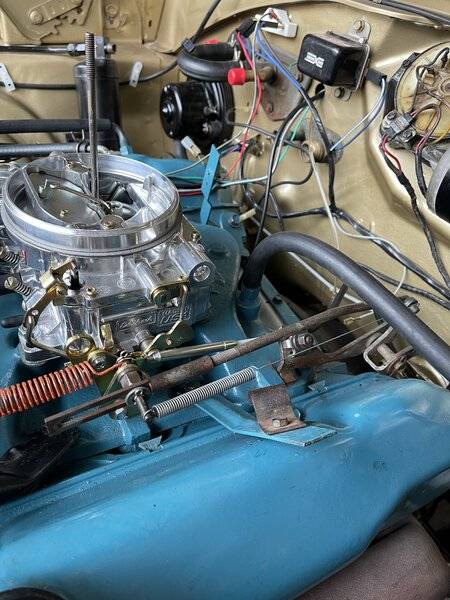

See a lot of posts on linkage configuration on 67/68 383 cars . Let me drop a few pics of my stock set up
