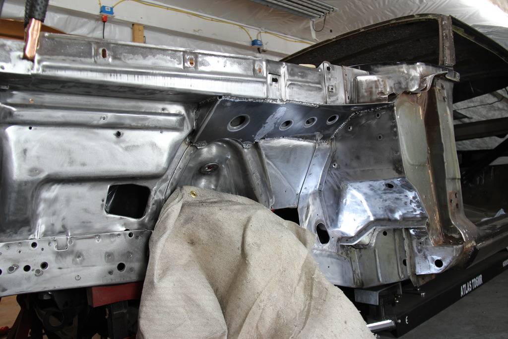

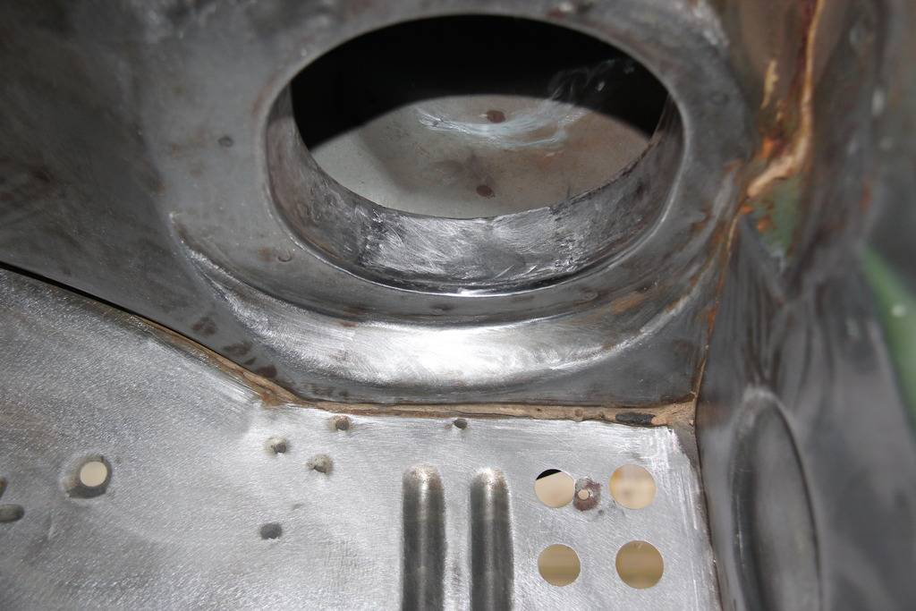

I had one bad spot in the right side cowl vent that needed asmall repair, but fortunately it was accessible. The right side cowl vent isnot used with new Vintage Air system; there is a plate that will cover it. NowI can water test it with a rust converter and spray it down with sealer. Ifanyone has a proven method for access, cleaning, and coating the inside of thecowl please let me know.
Thanks
Pat

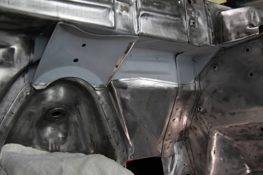

I fitted and welded in the left side US Car Tool innerfender brace. It needed a littlemassaging but fit really nice. Right side is next!
Thanks
Pat

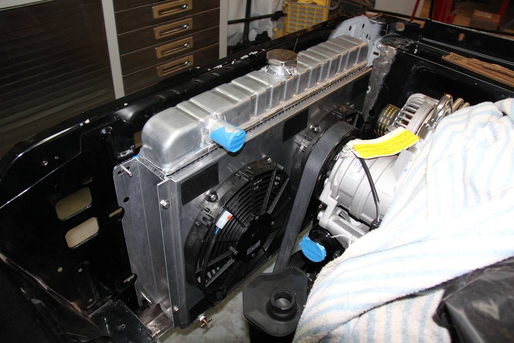

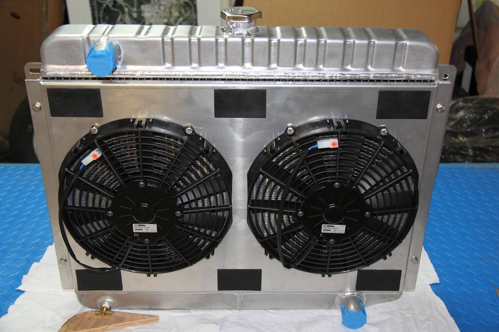

I received my Griffin radiator yesterday so with themotor still in the car I test fitted it. I’m going to weld a 90 degree pipe onthe thermostat housing so it will have a short top hose.
Thanks
Pat

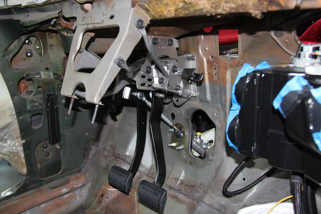

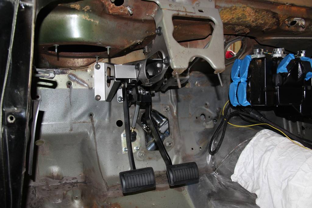

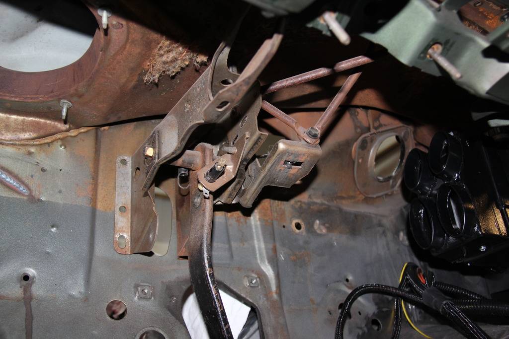

I test fitted the pedal assembly and had to weld overthe original brake booster hole and cut a new hole in the firewallreinforcement mount. Also test fit the hydroboost and clutch master cylinder. Ineed to make the hydro boost and brake lines next.
Thanks
Pat
Why the new hole for Hydro boost??
The hydro boost is setup to go in a manual brake car and my original power brake hole in the firewall reinforcement bracket was to high. The actual firewall needed no modification.
Thanks
Pat
Got ya, something to check when looking for a Hydro boost..

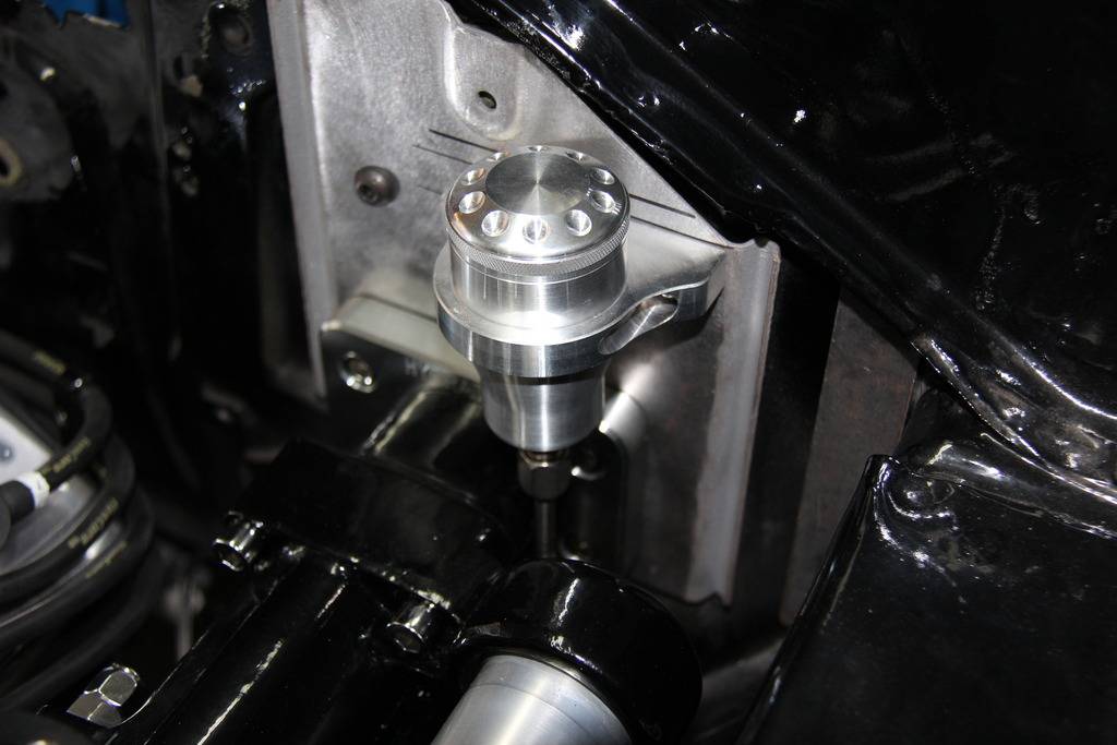

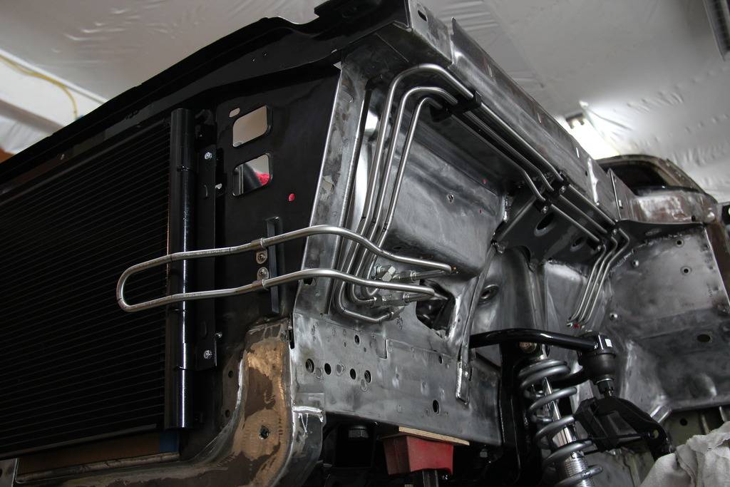

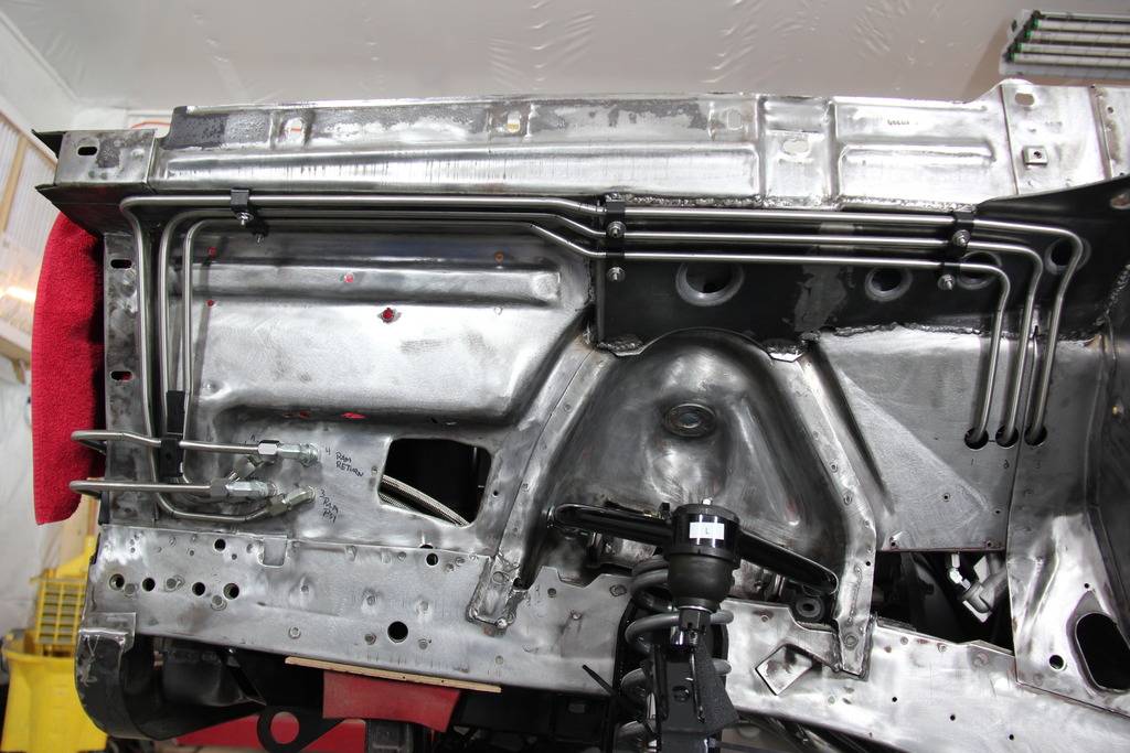

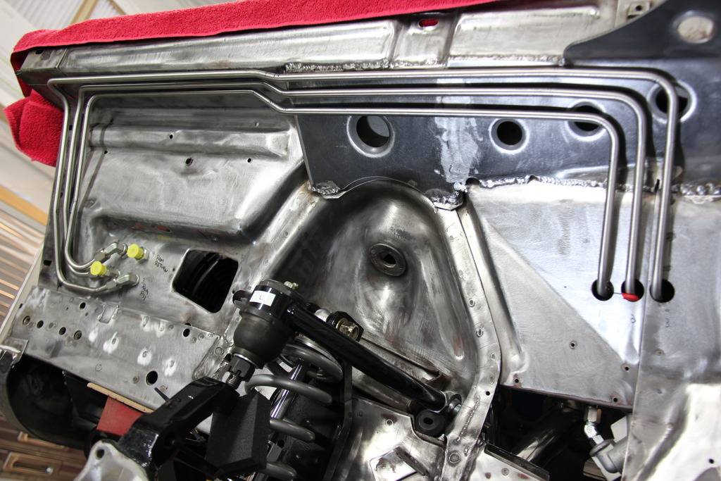

I bent the Hydroboost and power steering lines to fit in theleft side inter fender well. I used 3/8” stainless steel .035 wall tubing. All this test fitting,wiring, and line bending just to pull it all out before the bodywork starts isa lot of work!! I’m sure I will enjoy having all this work behind me after thecar is painted. Wait that sound like I’m looking forward to the bodywork ;-(
Thanks
Pat

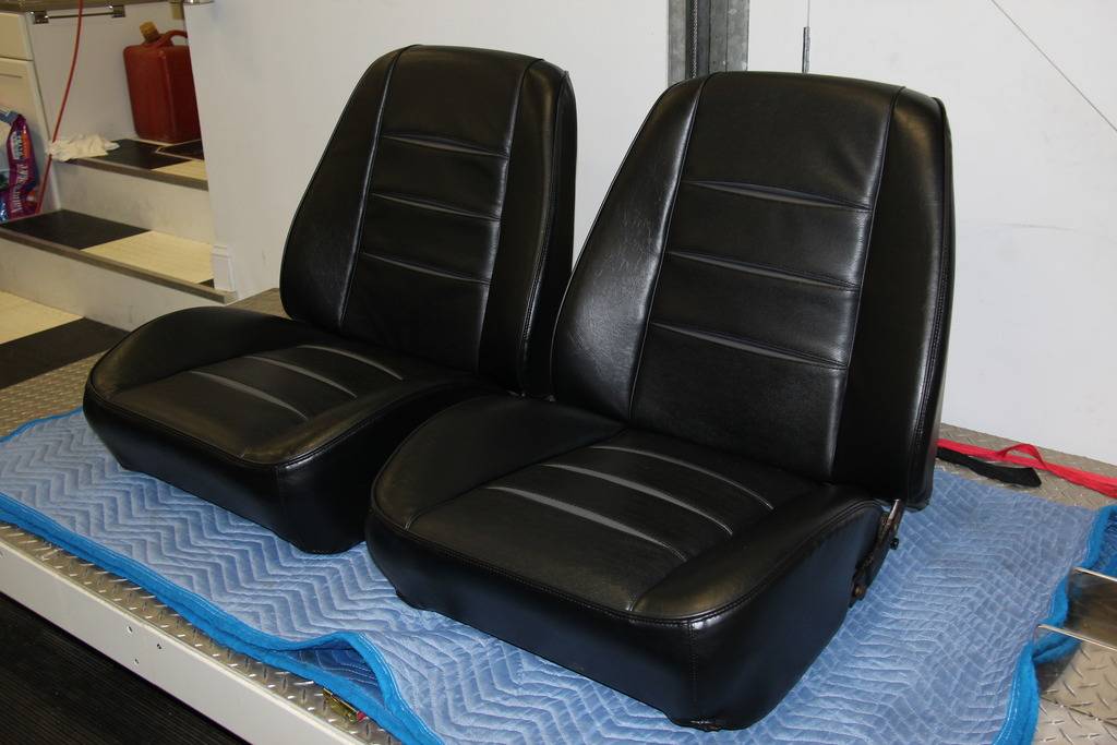

Went to Carlisle today and pickup my original front and backseats that I had dropped off with Legendary this past spring. They recover thefront & back seat and I went with their Rallye front seat upgrade. I’m veryhappy with the look, shape, and fit!
Thanks
Pat

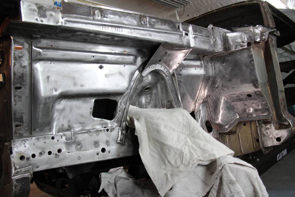

Today I replaced the right side radiator core support so Ican use the larger radiator. The new part fit nice and I spot-welded it inplace. I hope to test fit the new radiator next week.
Thanks
Pat

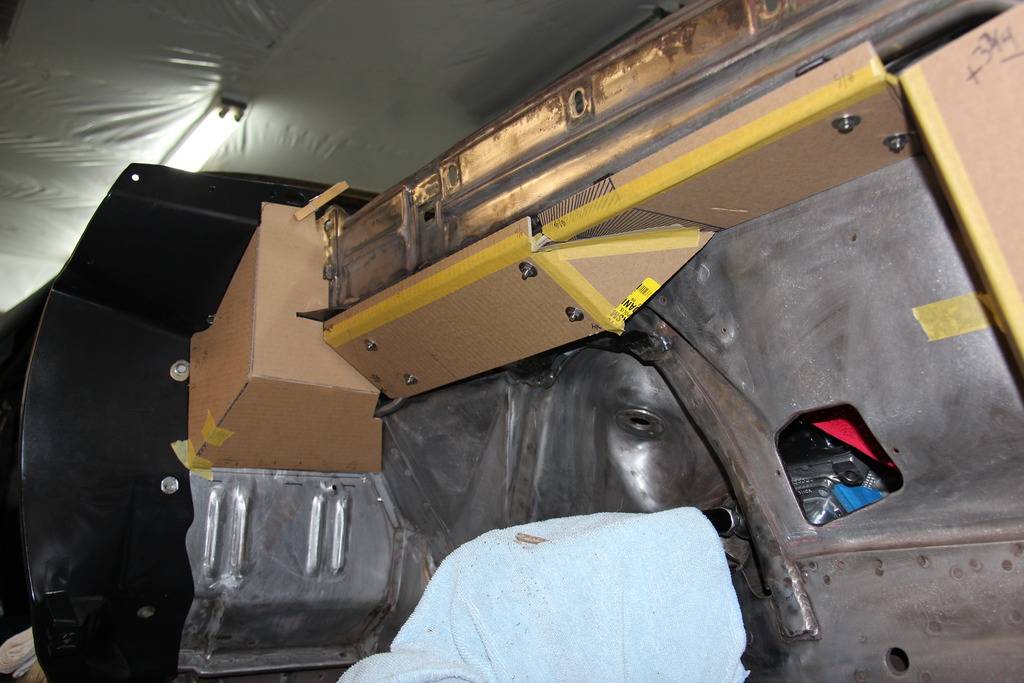

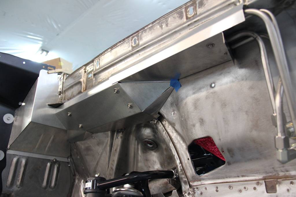

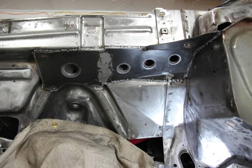

I decided to go with aluminum for the AC and heater linecovers. They will be painted with Bed-liner after a few seams are welded. Ileft the front cover long and will cut to fit the fender.
Thanks
Pat
Left side inter fender covers are fitted and just need a fewseams welded. Getting close to pulling the motor and mount the body on the rotisserie.
Thanks
Pat
