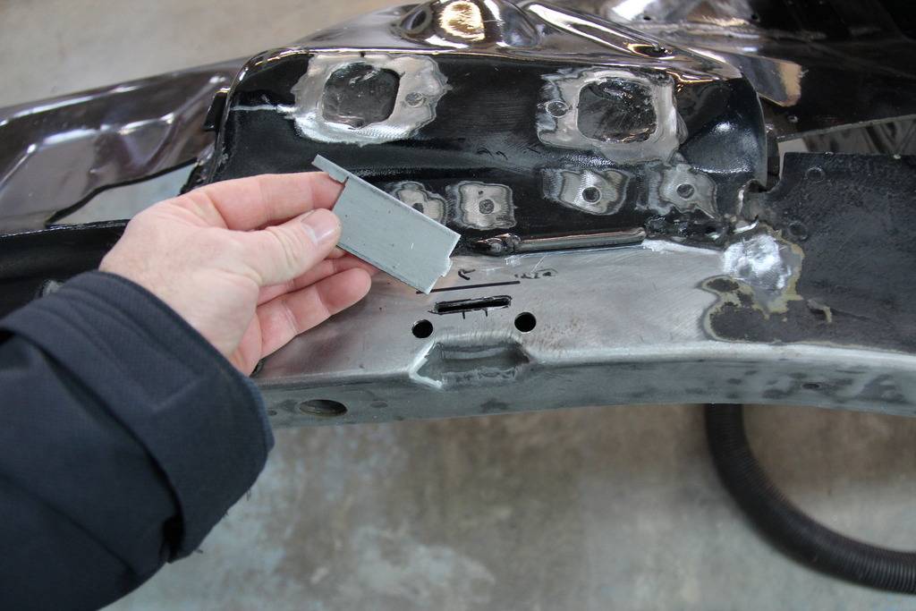

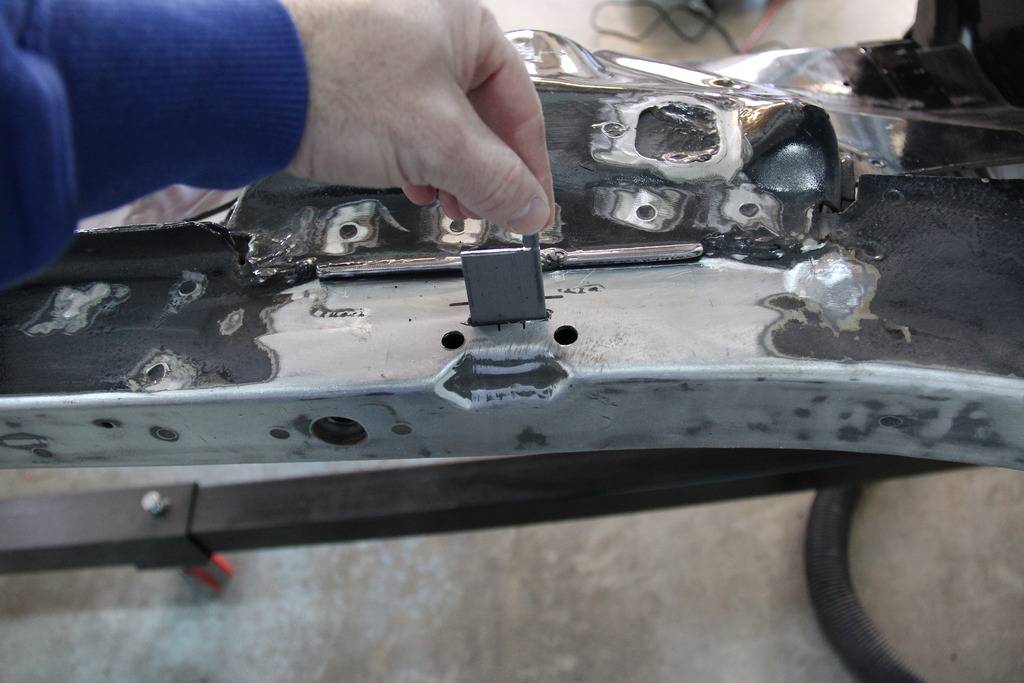

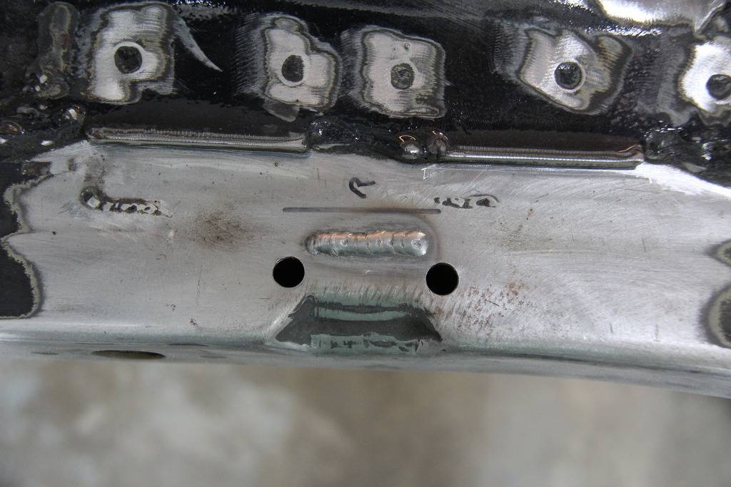

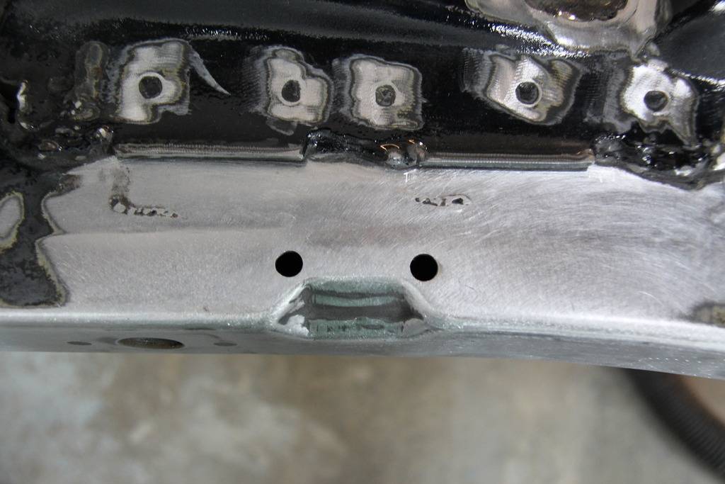

The RMS suspension requires a few holes drill throughthe frame and they tell you not to over tighten these bolts so you don’t collapsethe frame. So I welded in 2 reinforcements to help prevent that from happening.The 1/8” plate is welded on both sides.

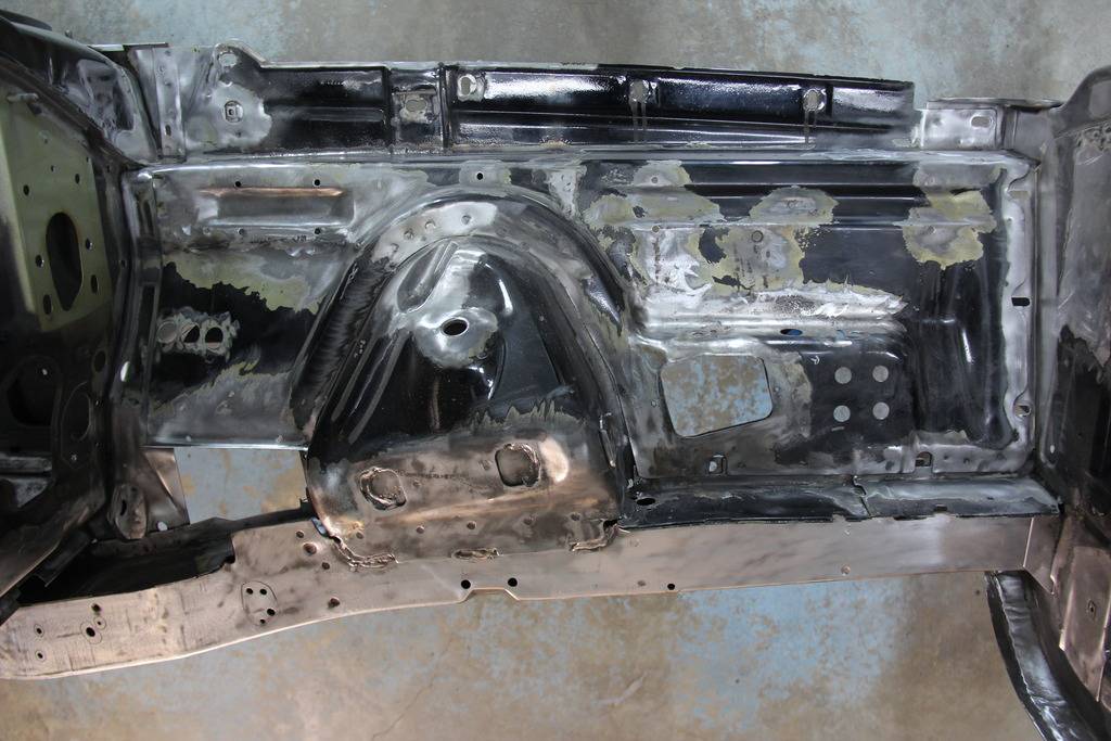

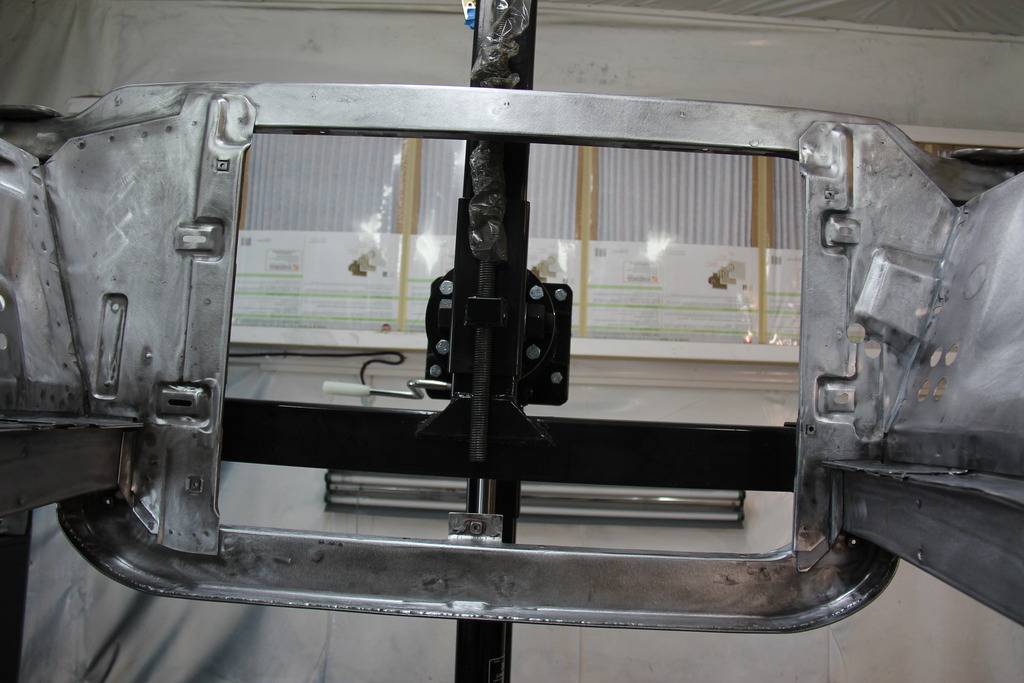

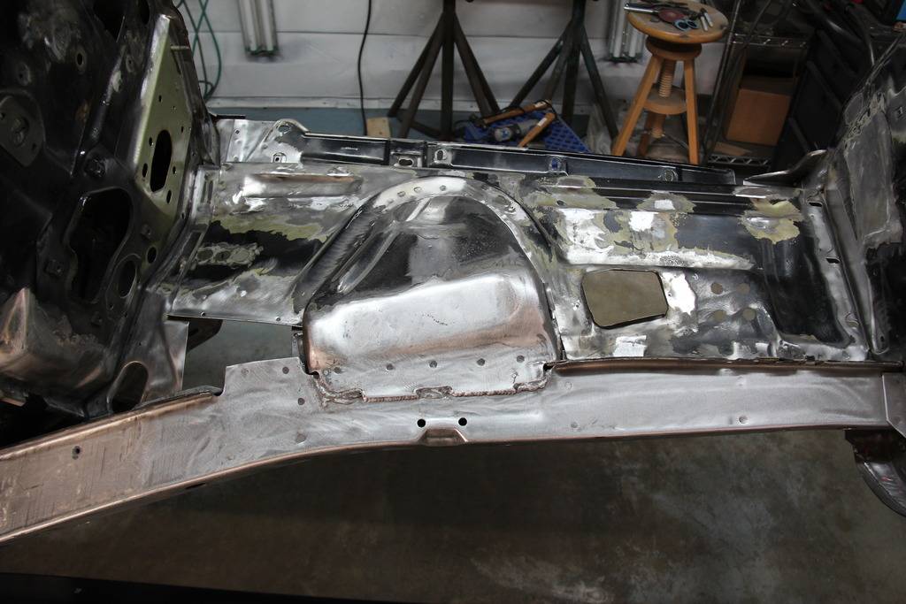

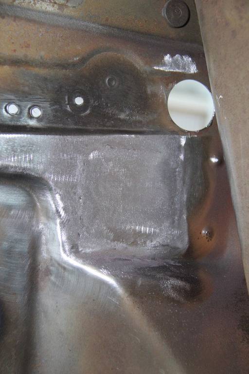

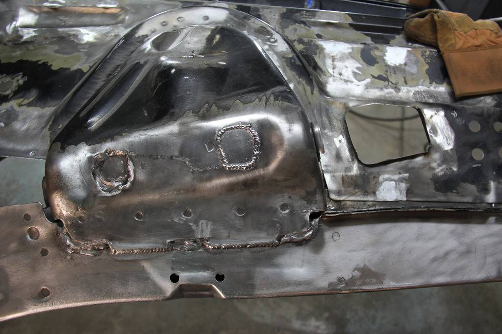

I started filling all of the unused holes in the engine welland have the left inner fender and core support finished, so far over 50 holes.

I used a mig welder for the holes I filled and I find working with 20g steel that holes smaller than 1/4"you can back with a piece of copper and weld over, anything larger than that I'll make a metal plug. With the larger holes hold the mig at 45 to 60 degree.

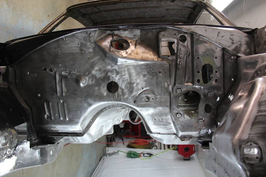

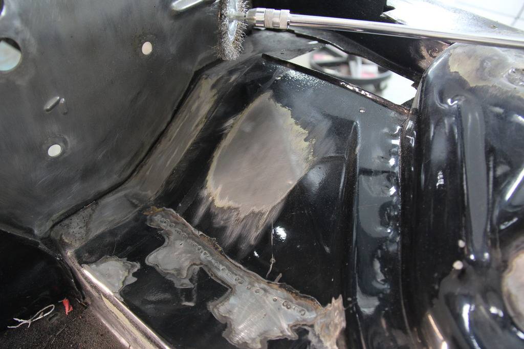

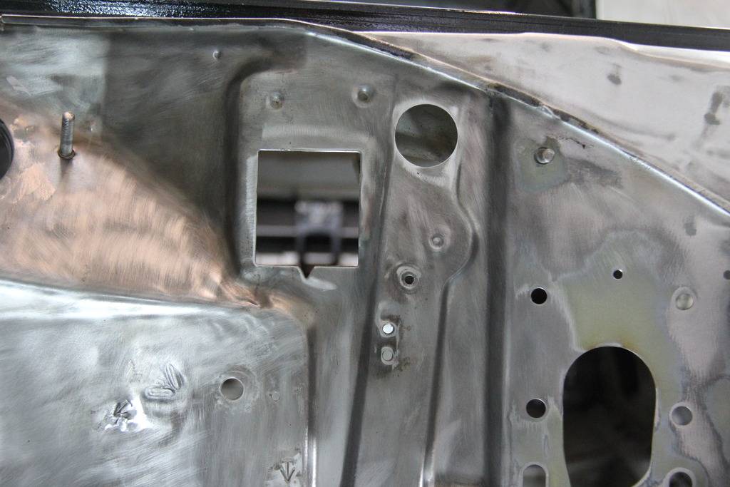

I’ve had a few people ask how I remove the paint, clean themetal and finish off the welds, so I thought I do little right up and somepictures on what has worked for me.

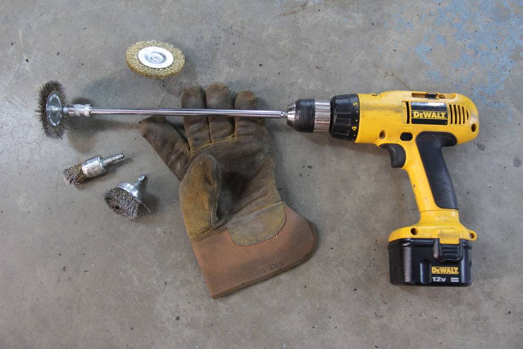

In the engine bay I have found a heat gun and wirewheel on a drill works great removing the paint and original primer from all thenooks and crannies. I like using a 12” quick change extension to hold the wirewheels. The advantage of the drill over a grinder is you can change thedirection of the drill which allows the wirewheel to work more aggressivelyremove the paint and primer. With theheat gun I blister about 6”x6” of paint and while it is still hot I use thewirewheel to remove that section ofpaint, it goes quick and no fine dust.

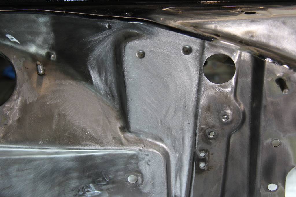

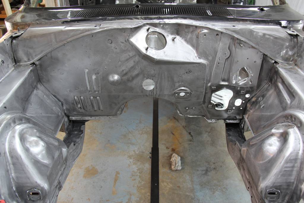

Here is a before and after of the firewall using only theheat gun and wirewheel.

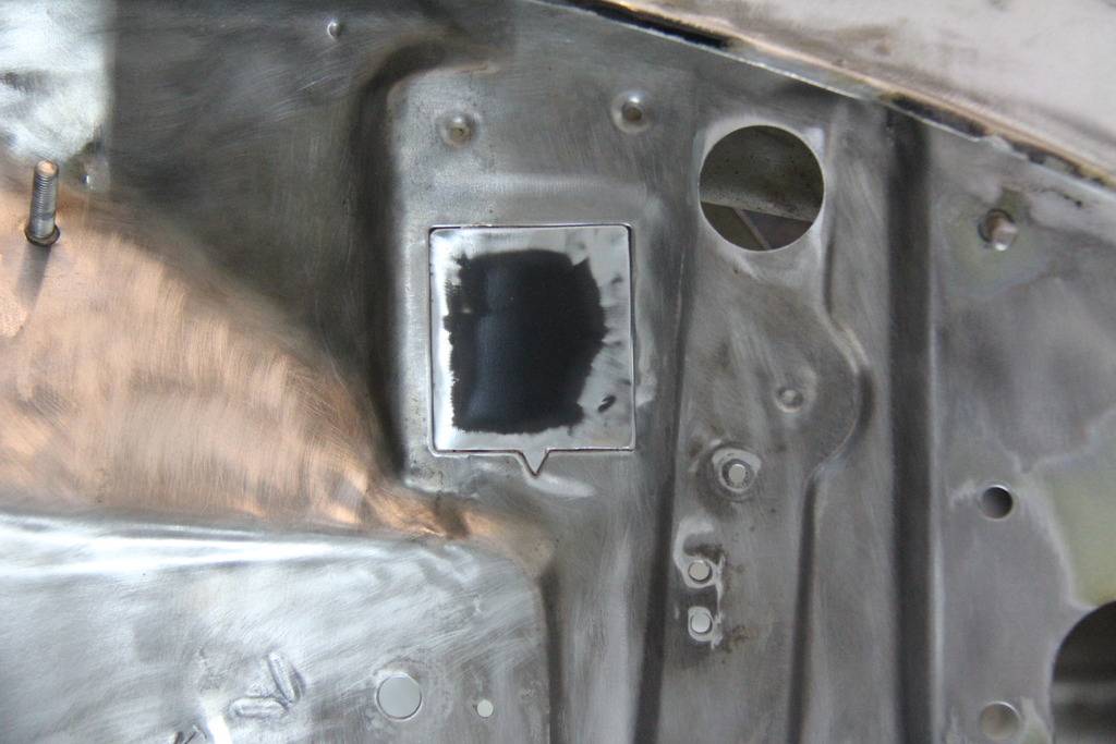

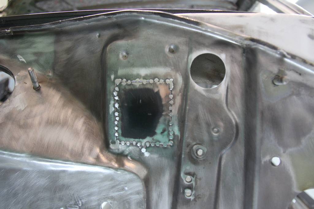

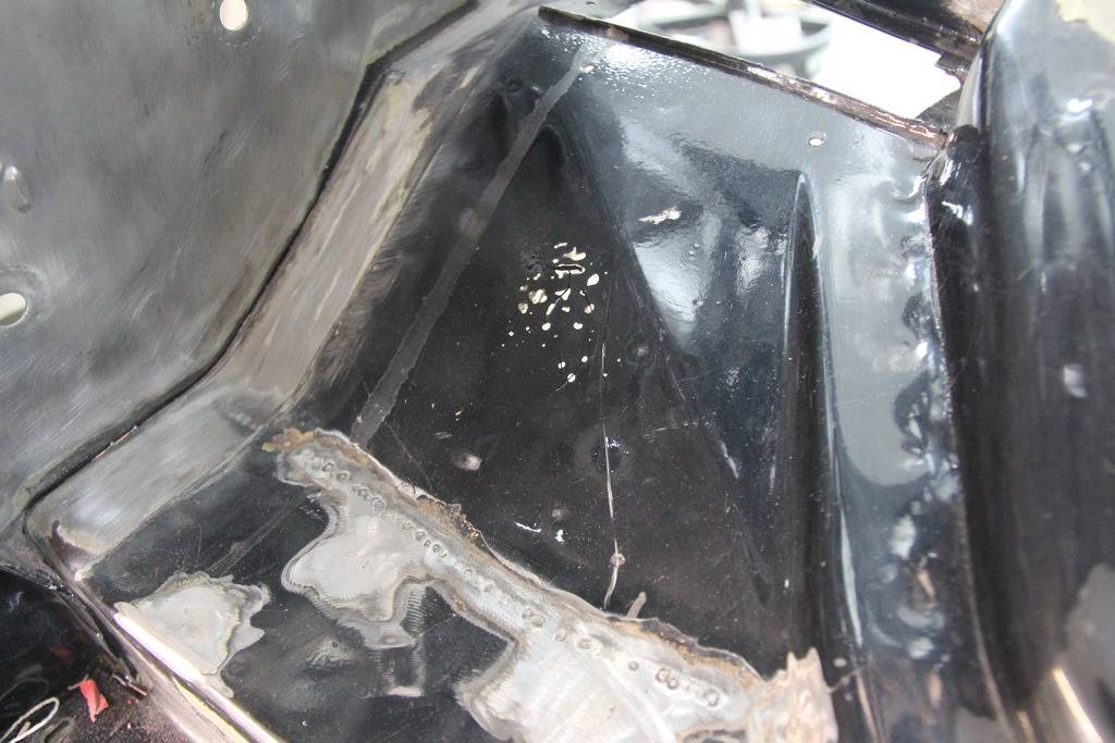

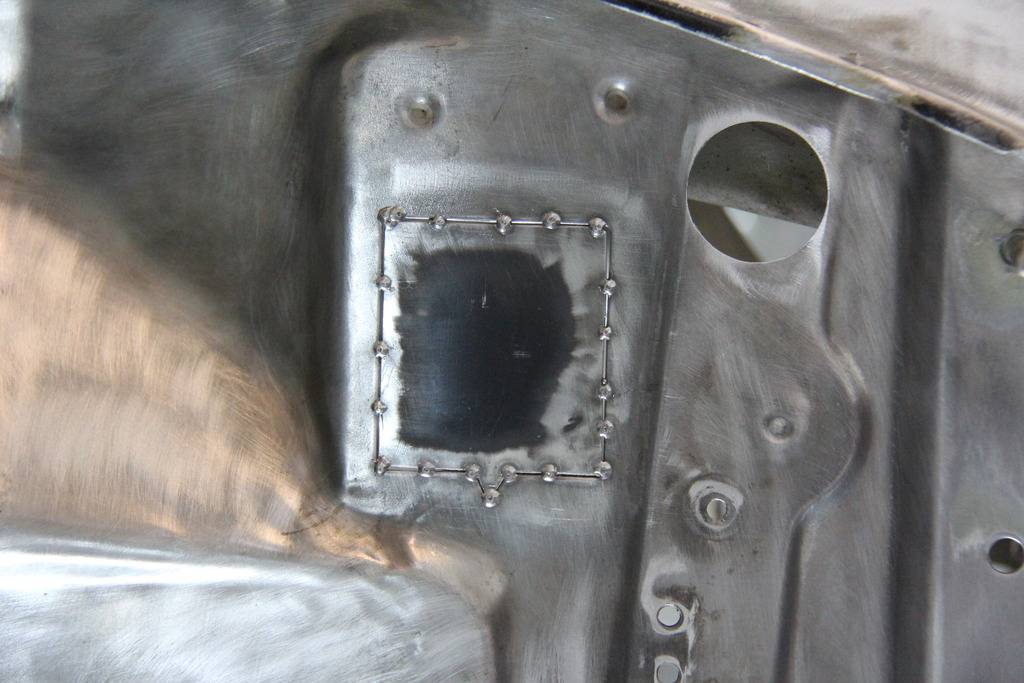

Here I’m welding over the wire harness plug hole. After tackwelding the cover in place I grind down most of the welds before finishing thewelding, this helps keep the heat down and make it easier to connect the weldas thickness of the metal is similar to the welds.

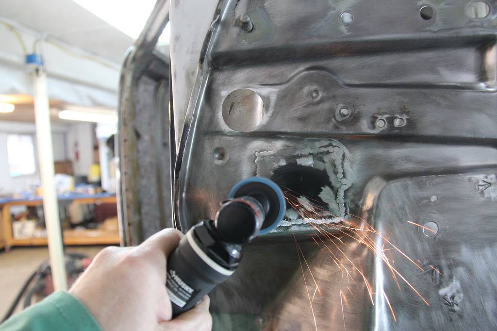

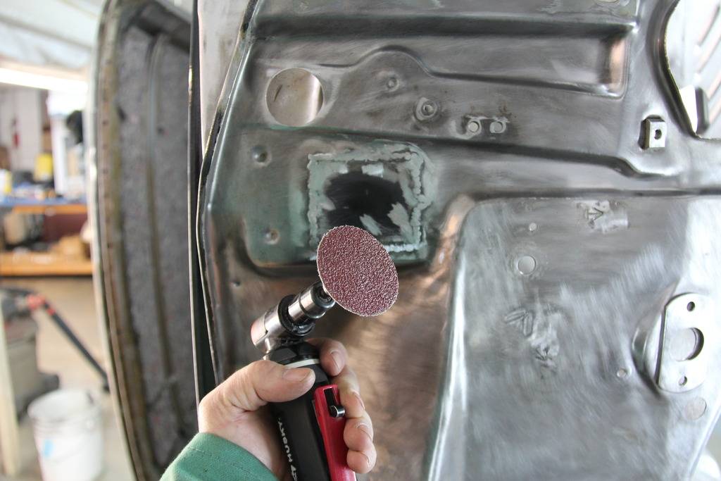

I like to use a 90 degree Die grinder with 2” 36 grit discto take the welds down. Keep it moving and always use new disc when workingsmall areas as worn disc will just heat the metal instead of cutting the welddown. When the welds are mostly cut downyou can hammer and dolly the panel flat and then finish off the leftover weldwith a 60 grit disc.
Note before hammer and dolly the panel you will need togrind down the weld on the back side!

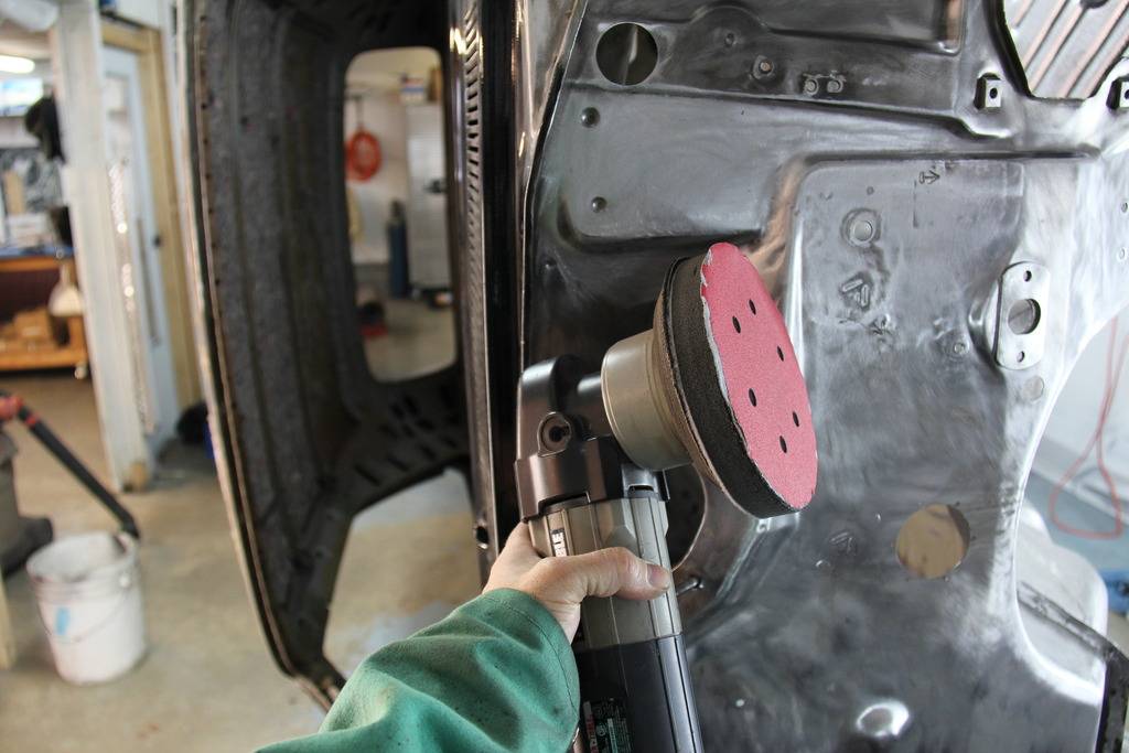

The last thing I do is use a 6” random orbital sander with a¾” foam pad and 100 grit paper to clean the metal.

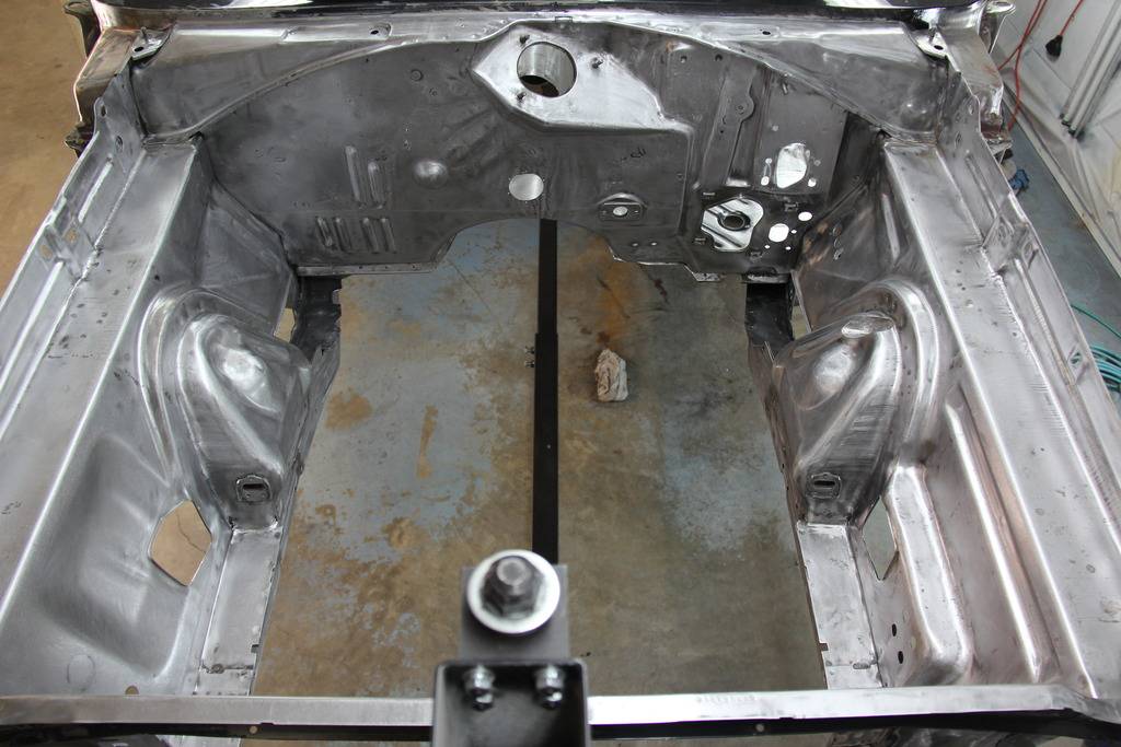

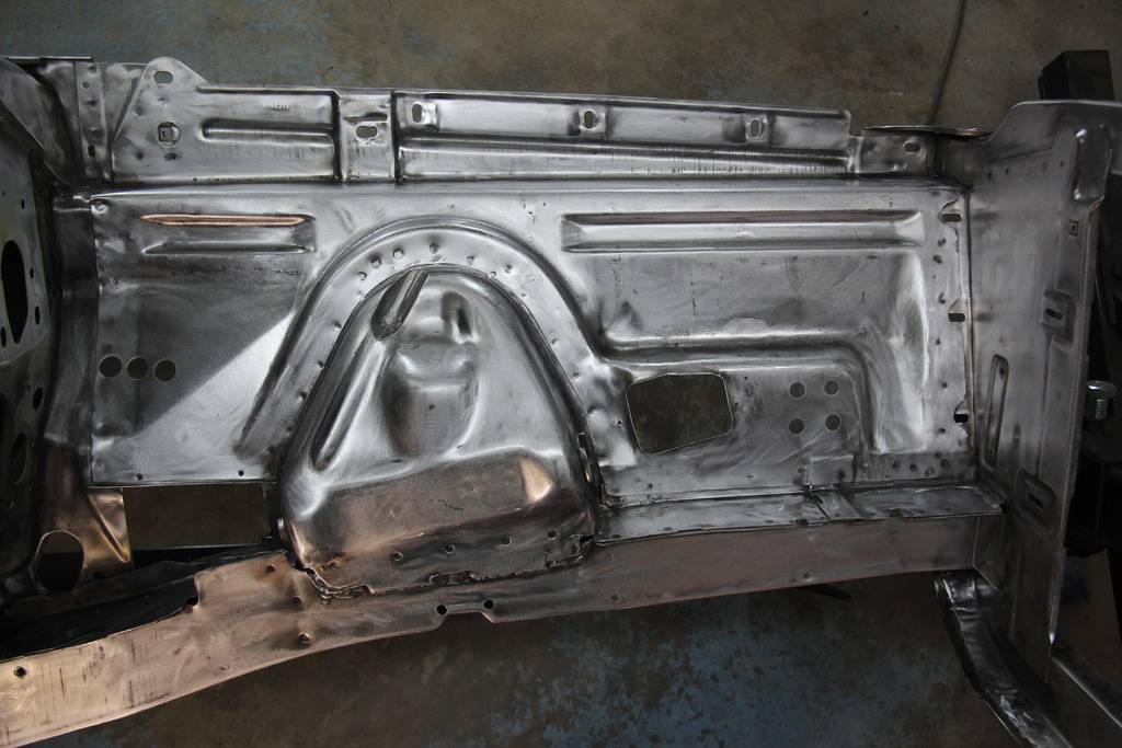

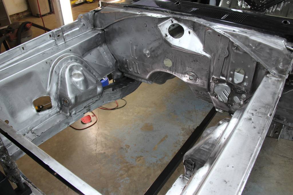

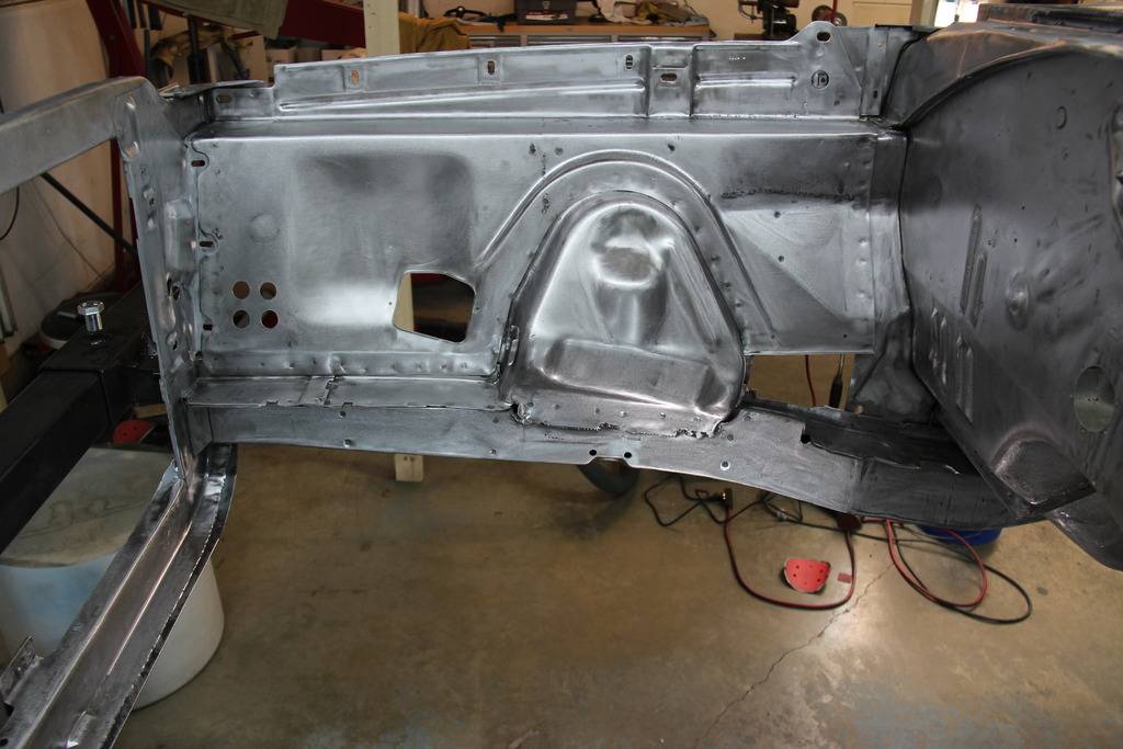

The paint is removed and all the unused holes are welded upin the engine bay and ready for epoxy primer.

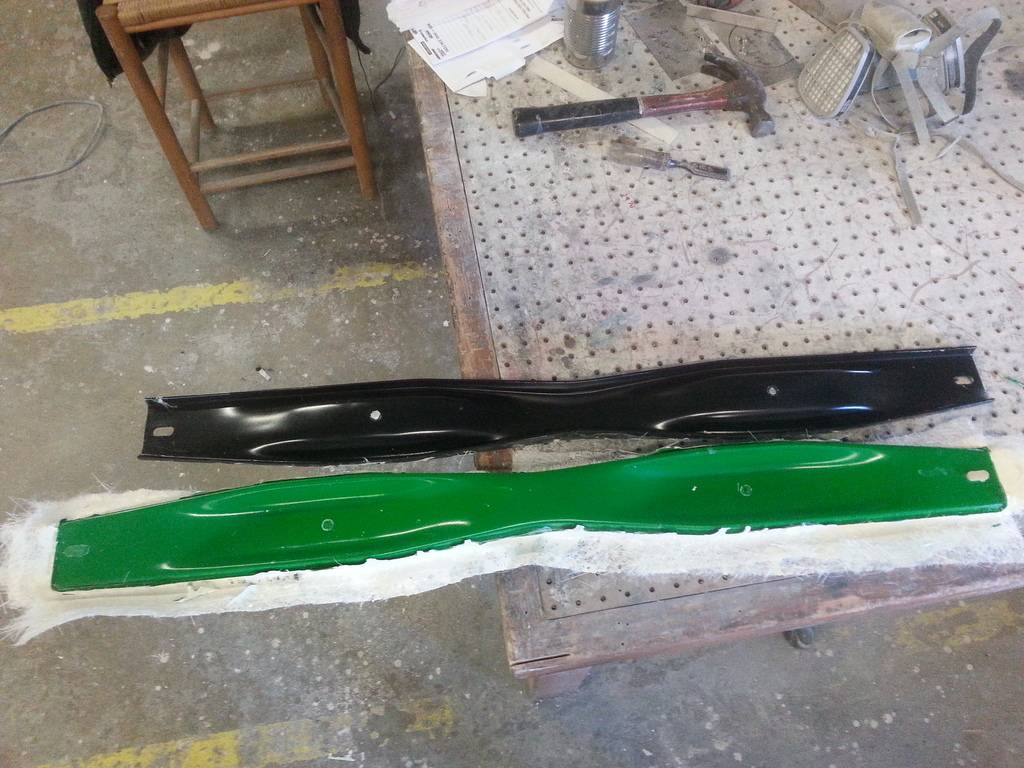

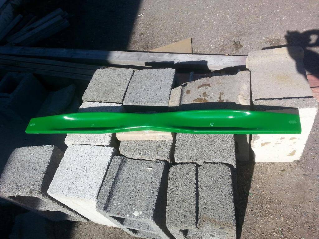

I had a mold made of the front bumper guard mount so Icould make a carbon-fiber version of it. The steel mount weighs about 6 lbs andthe carbon-fiber replacement will weigh about 1 lbs. After I pull the 1[SUP]st[/SUP]part I’ll post a few pictures and if anyone is interested I could make a fewmore? I think I will paint mine black to look original but they could be leftclear to show the carbon-fiber if you like?
Thanks
Pat
Cool! I’m only going to make a few to cover the costto make the mold and materials. I will know the price after the 1[SUP]st[/SUP]part is pulled.
