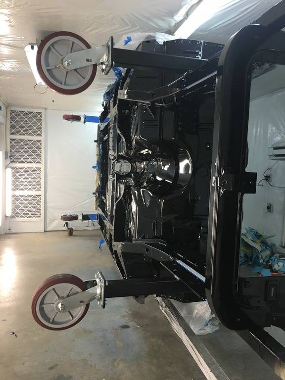

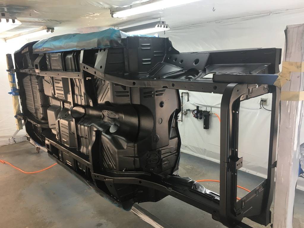

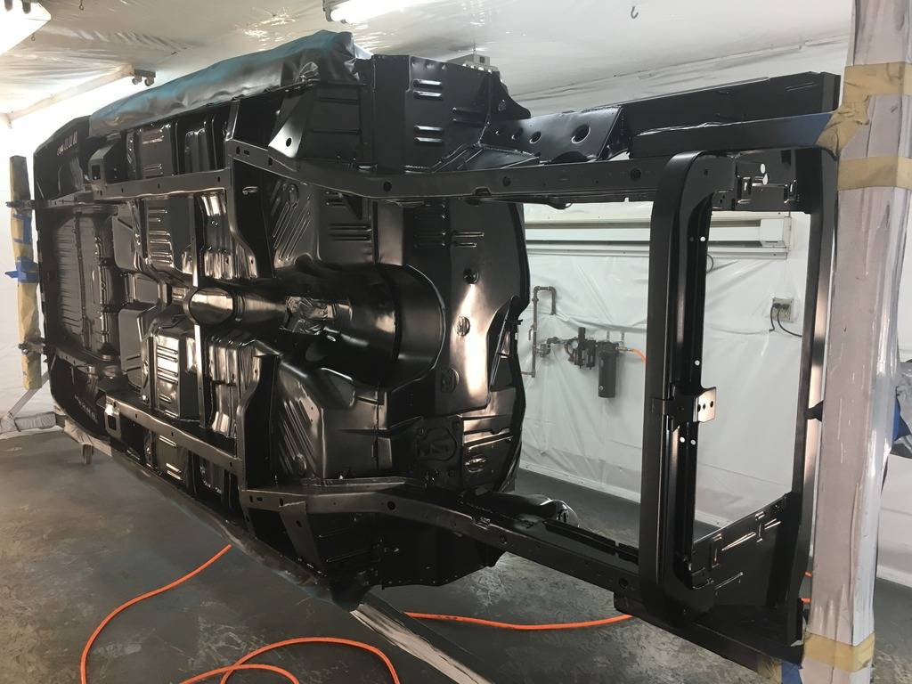

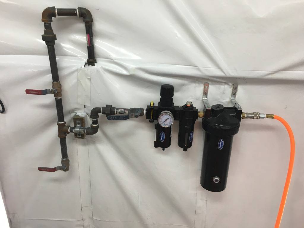

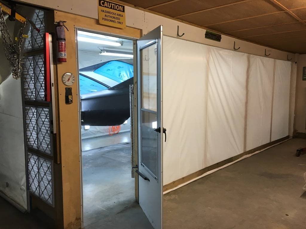

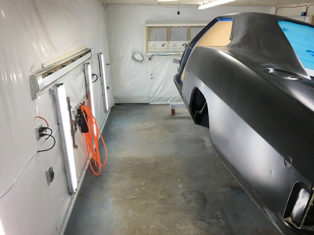

Reassemble my home made paint booth over the weekend. I used boat shrink wrap for the walls and ceilings.
These two walls can roll up to get the car in and out.

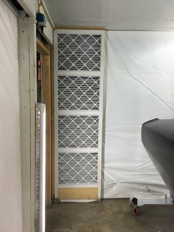

Four 20x20x4 intake filters.

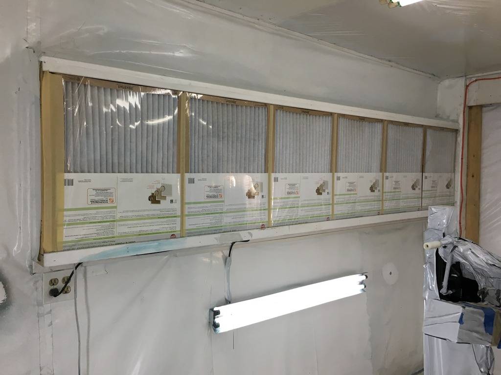

Window box holds two 20x20 fans and track for quick change 20x25x1 discharge filters.
A little clean up and the paint booth will be ready. This will be the 3rd car to be painted in this home made booth.
Thanks
Pat
I built a booth awhile back (15X25 all metal with an exhaust fan and furnace filters for airflow), the thought was make it all easily washable for a clean paint area..... I'm about to go back to your way of painting after my luck with my booth! Doesn't seam like it matters what I do I get dirt and believe the static in the plastic may be more beneficial than I had thought.
Building a new garage right now and am looking for new ideas for a new booth. I may just build a curtain rail for plastic and forget it?
Can't wait to see the paint!
If possible you want slight positive pressure in the booth so dust is not drawn in unfiltered
One thing that I've been told is to be careful with plastic on top , it will collect water and paint and can drip on your car - been told that cloth ( bed sheet ) would be better above the car so it can hold the drips and paint and not drip . . .
Not sure first hand but wanted to pass this on to you . . .

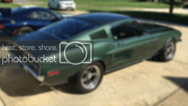

No problem with moisture in the paint booth on the ceiling, and the room is under a very slight vacuum, pulling air in from the four large filters close to the door. I'm sure there are other and possibly better ways to build a homemade paint booth but I had great success with this booth so I will stick with this set up. Here's a pictures of the last two cars from this paint booth.
Thanks
Pat

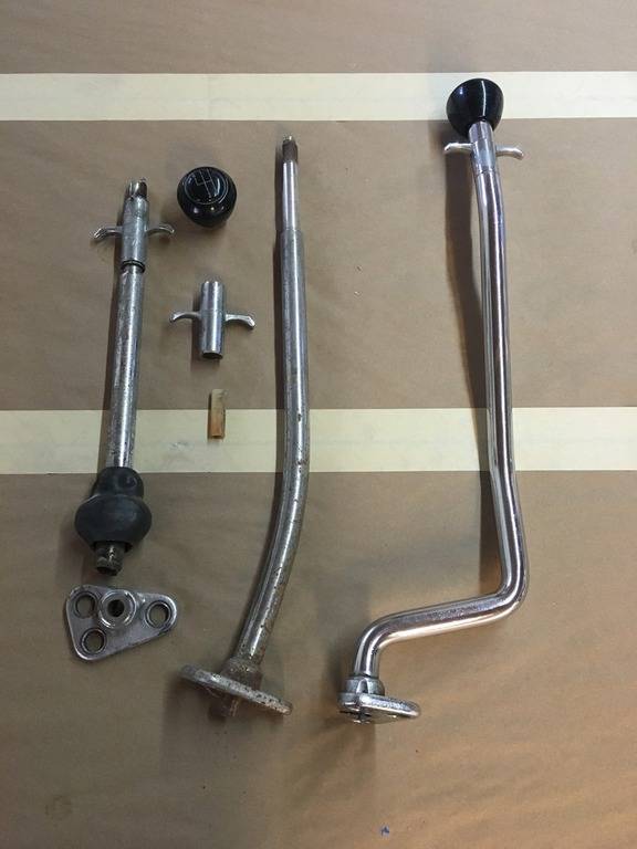

Scored a nice 68 console Inland shifter on craigslist. My plan is to cut the base off and modify the shifter for my T 56 six speed using the T handle to engage a micro switch to operate the electronic reverse shut out on the T56
Thanks
