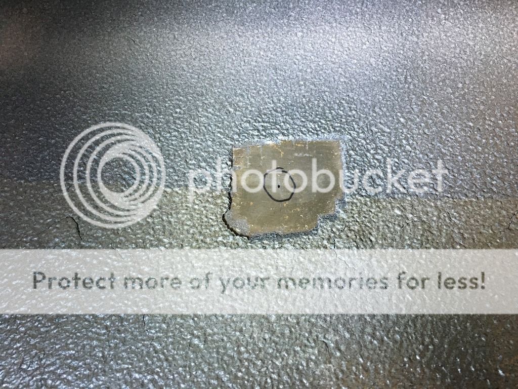

Very cool trick, makes sense and cures the problem of limited space for hammers and dollies. Thanks.The subject of small dings and dents was brought up, so I thought I would post a few pictures of how an old body man showed me an easy technique to work them out if you have access to the other side. Using a spring-loaded center punch with a filed down blunt end.
Start with locating and marking the dent from the backside. Then unscrew the spring-loaded center punch a few turns as to lessen the blow for the first try. It may take two or three strikes to get the panel flush, along with changing the tension on the spring loaded center punch. You may need to move the impact point a 16th of an inch in either direction to work the dent out.

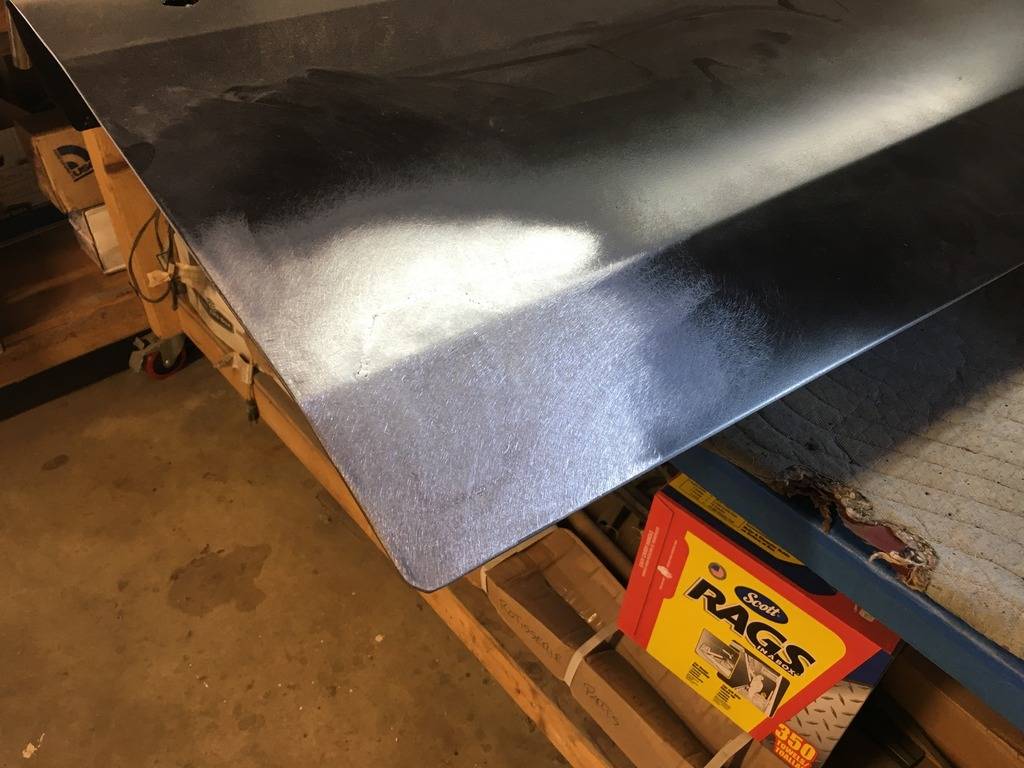

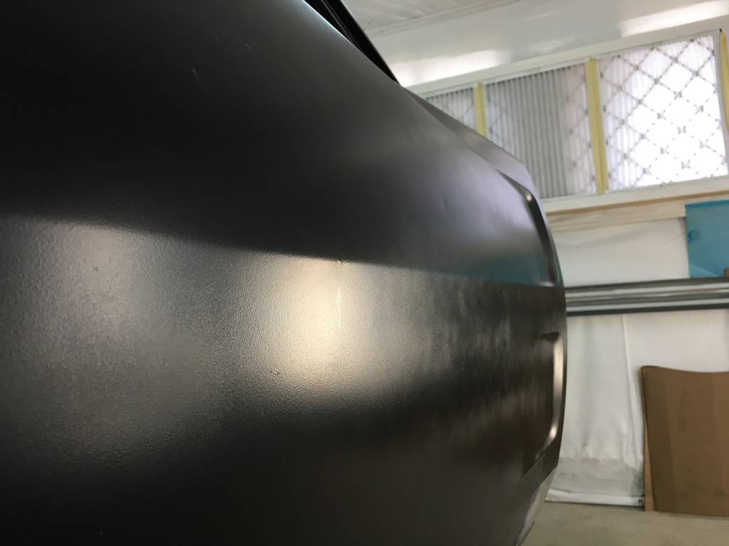

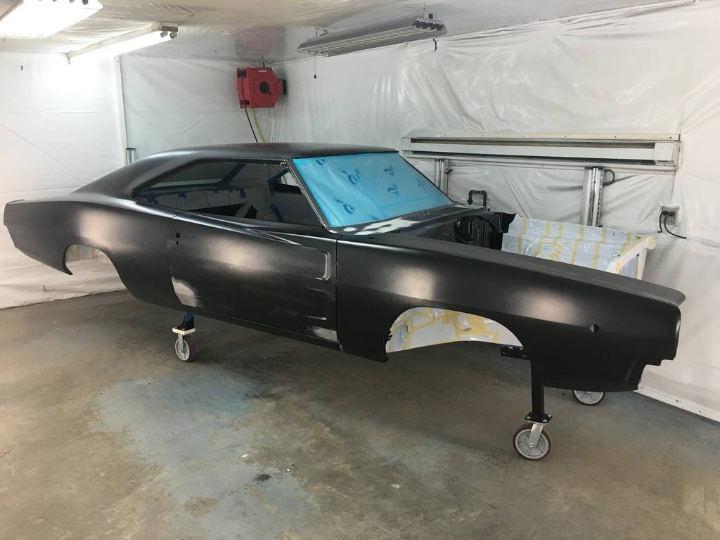

Pat, I can help teach Road Runner block sanding 201, as I have just completed first block and high fill primer with 80 grit. Starting tomorrow with second block with 150. Just finished 10 hours filling/blocking yesterday on the hood. I know why no one wants to do body work any more. using a 30" block on about everything, and finding there are about no straight lines on the car. I think I have 90 hours in blocking whole car so far (not counting major metal work and filler). The hood, deck lid, fenders, doors are not on the car yet. there is no way I could have done the 40 and 80 grit with parts on the car. I think my arms are stronger than they have been in years.
My wheels and tires should be here in three weeks and I want to have the car "Roll-able" and ready to go to the spray booth (even though I probably wont be ready). I did do the CV3C Forgelines.
