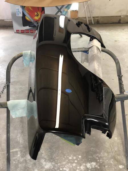

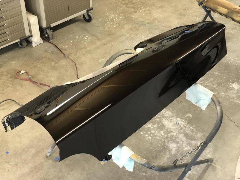

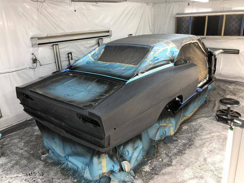

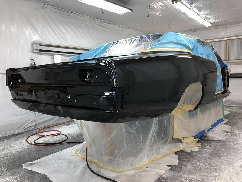

Getting there Pat and looking GREAT! Been nice watching it progress the past couple years.

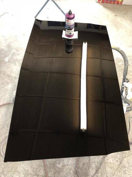

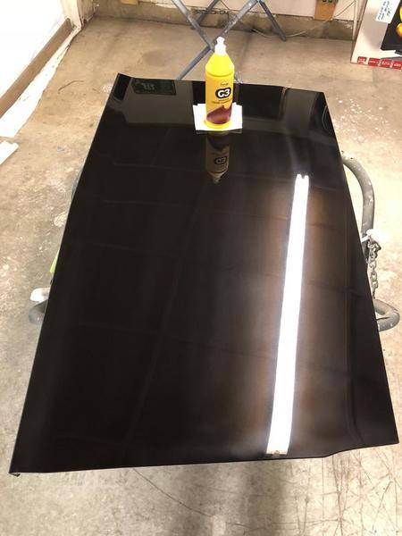

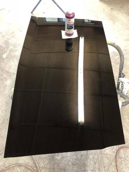

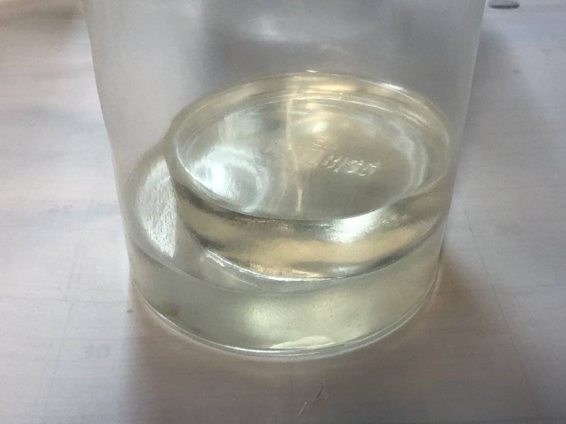

Color sanding/cutting and buffing is what makes the car. Blocking in the primer super time consuming. Painting car takes no time. Color sanding is the reason people charge 15k for paint jobs. This ain't no scuff and bake stuff that he is doing. Keepat this is great looking work. How long do you let the first clear sit(shrink up) before you sand and reclear. I try to wait four or so days. At least one day of full sun.Looks great! What is 'color sanding' and why is this done after the clear coats?

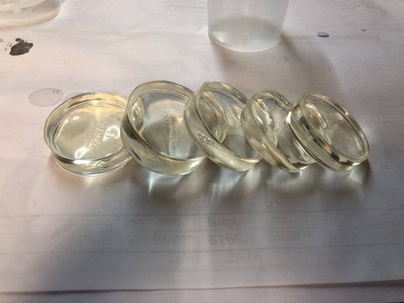

Never seen that done, do you keep measuring them until they quit shrinking? Fenders look terrific, great job!
Thanks for the update. I was starting to get the shakes, but I’m good now.
David
You've turned the corner now Pat! It will be really fun to see pieces start to be assembled permanently onto the car.
This is a multi magazine cover car for sure.....
