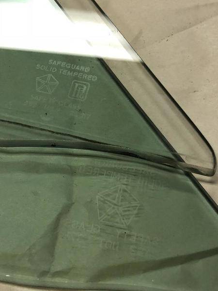

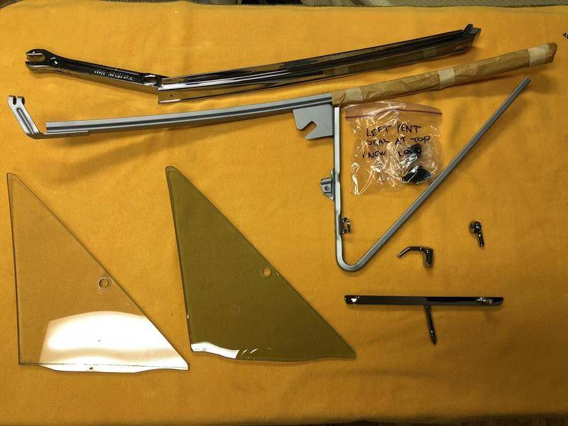

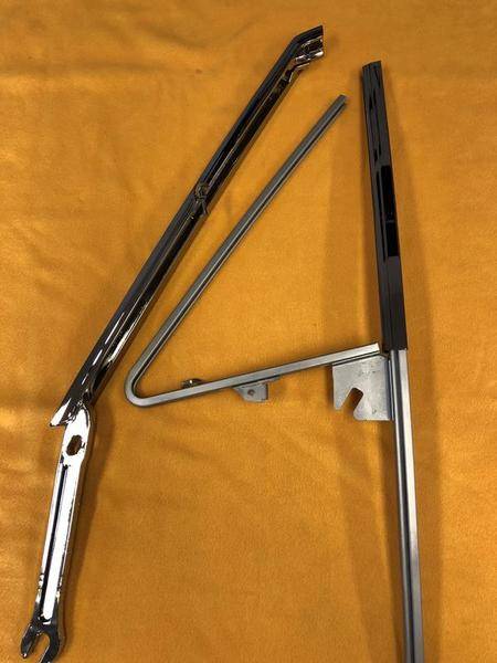

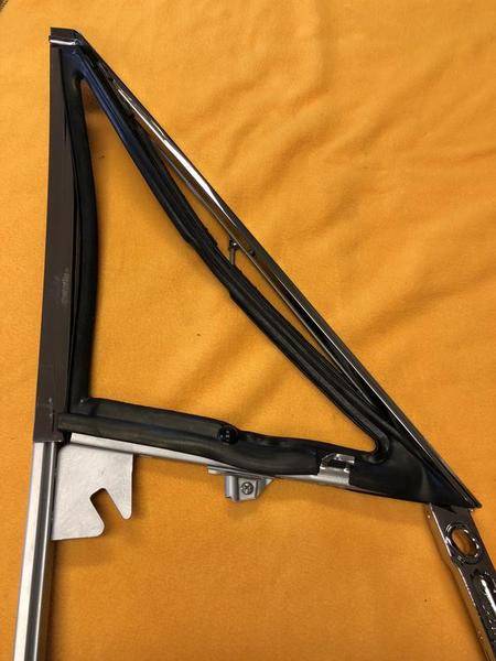

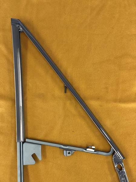

I picked up all the new tinted glass for the charger at Carlisle 2 weeks ago. So I put the vent windows together using Metros vent window gaskets. The gaskets fit great and required no modifications. I tested all of the new window glass against my original glass and for the most part the cut and shape seems to be very close, however the etched labeling for the vent windows was not only on the wrong side but it was also much larger than my originals. Ordered the tinted glass as that’s what the original Bullitt charger had.

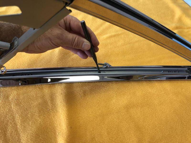

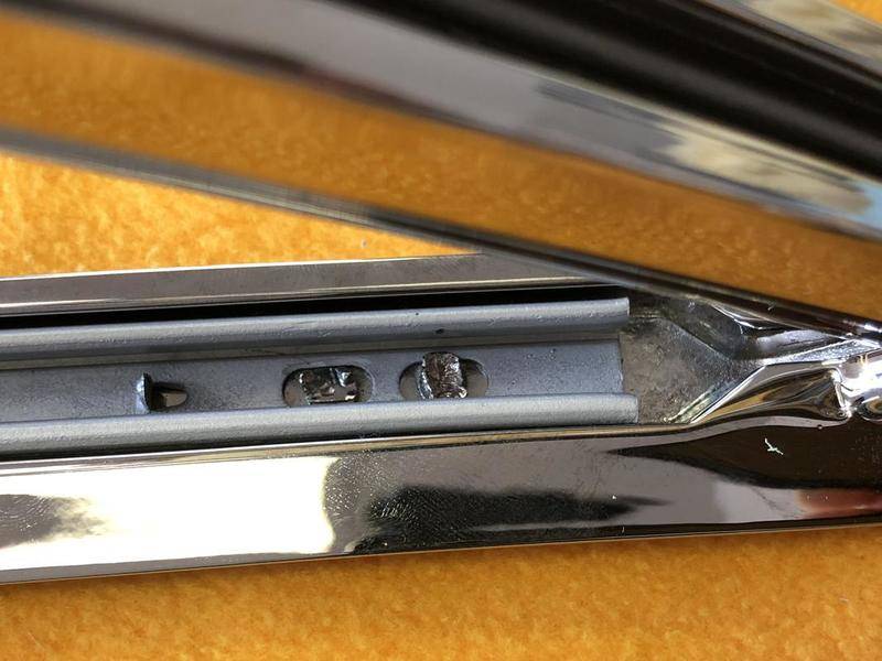

I had all of my original vent parts re-chrome by Paul’s two years ago, and I polished stainless steel. I used a commercial grade black double stick tape to reattach the lower chrome trim to the vent glass. (This worked very well on my 1st Charger 10 years ago) There are 6 raised rivets that are part of the chrome vent Frame used to hold the steel track in place. And on the two chargers I have restored the factory only uses 3 of these which makes it very easy to reattach the chrome to the steel frame in the same manner that the factory did buy peening over the rivets to hold the frame. Be careful peening over the small rivets as the metal is soft and you can dent the other side easily which I found out on my 1st Charger 10 years ago. Then reinstalling the vent glass along with the stop pin and locking handle is relatively easy after cleaning out any excess chrome plating left behind in the small holes.

I see that the etchings are a bit larger than the original. Are those AMD's? I am surprised you didn't go with ECS.....Furthermore, the etchings can be inside, outside, flipped etc....I never realized that until I ordered my glass form ECS. The GTX had all its original glass but was in poor condition but when I inspected the etchings there were two styles and most were etched inside and two were etched outside.....
That aside thanks for the info and pictures of the vent window installation. Did you use glass setting tape?
My brother is a Glaser and he hooked me up with the tape to set the glass not sure what it is called or the manufacture, and Yes AMD glass. I was not concerned with the correct date code, just would’ve been nice if it was similar;-) I did use ECS on my 72 Trans Am which was an factory original restoration. It would have to be a very special car for me to go through that again ;-) my hats off to you with all of your research and work restoring your dads car!

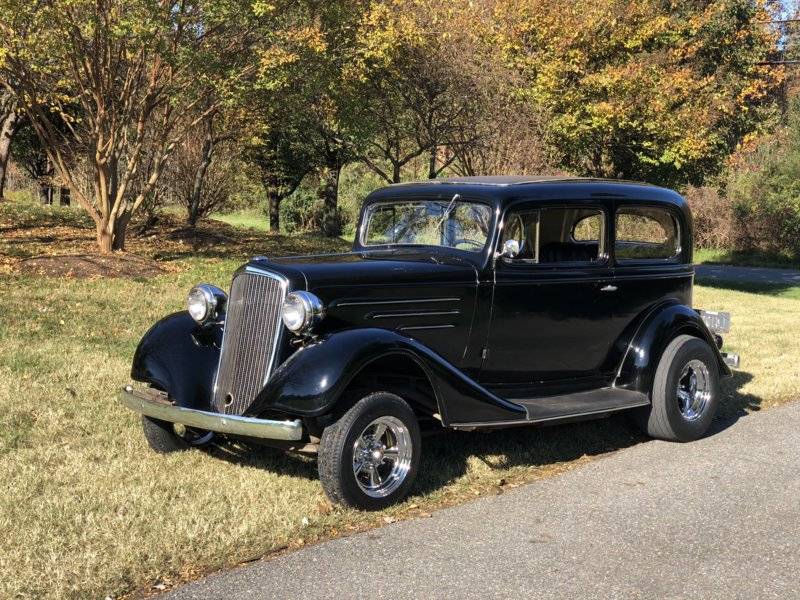

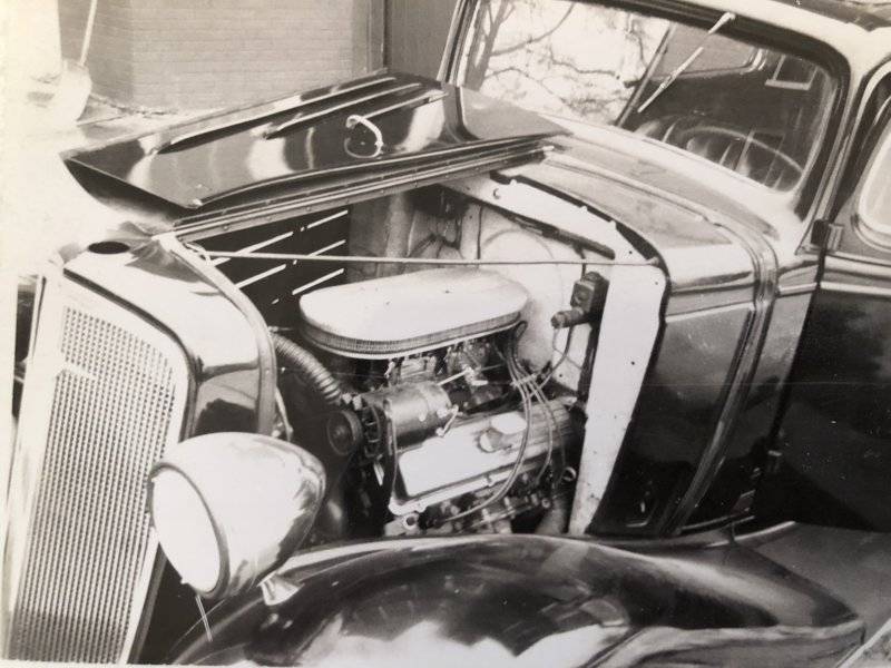

Can’t change how he built the car! He built a gasser by putting a Ford straight axles on the Chevy, and custom made fender well headers for the Olds 394 engine. Pictures are from 1963/4

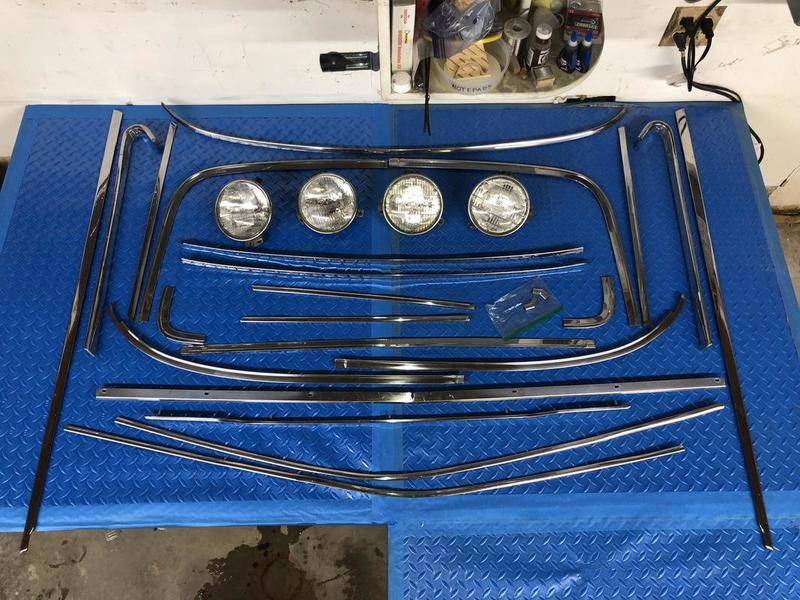

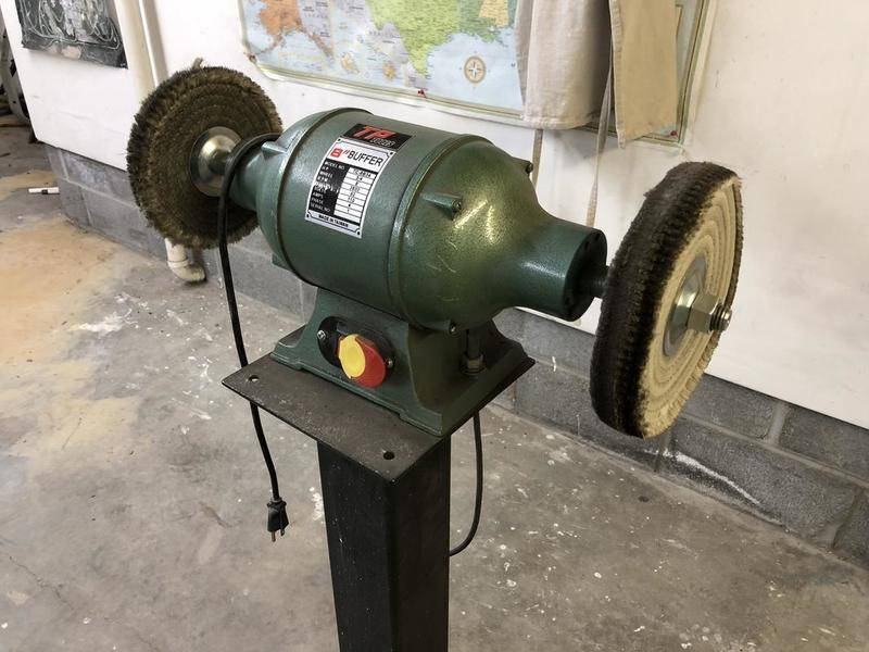

Just starting the restoration and polishing of all of the exterior stainless steel. Fun!

We might be the only old dogs still using that stuff;-) For the record the picture of the trim is a before picture, after pictures to follow.
Thanks
Thanks
Before pic?.....Some very nice trim to start with!
