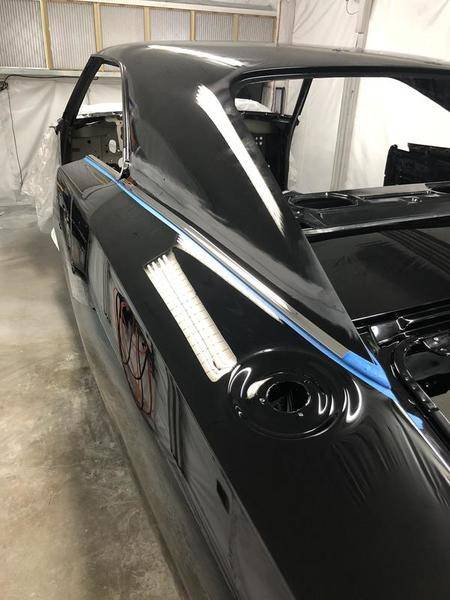

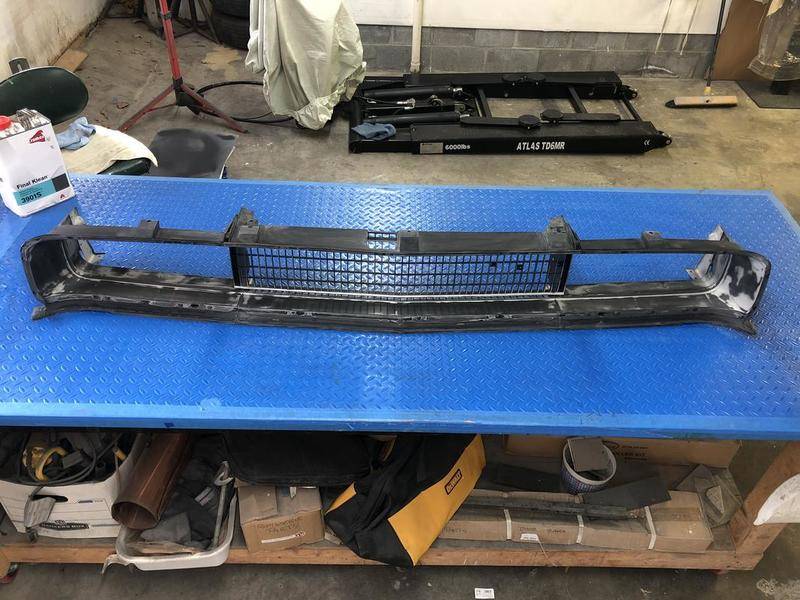

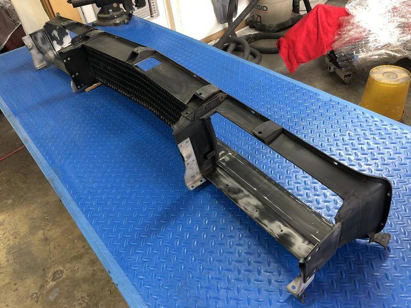

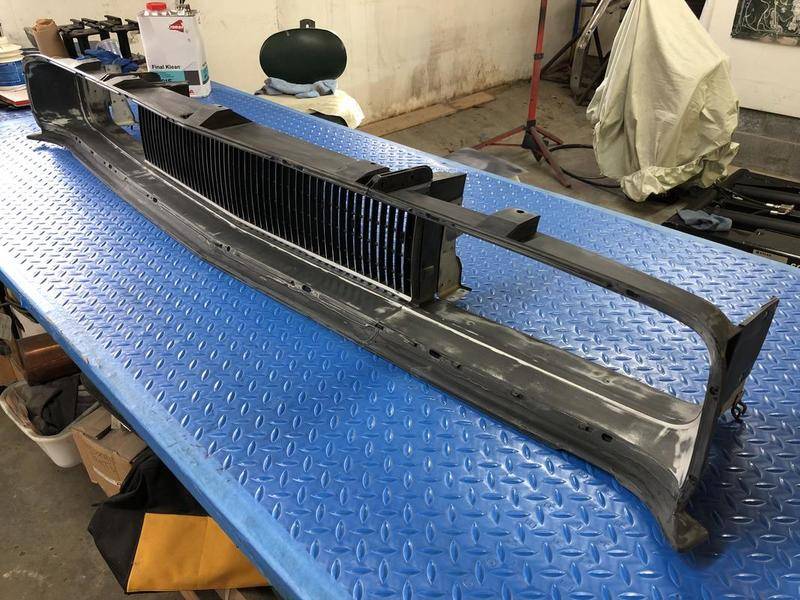

The grill repairs are done and it’s all sanded to 600 grit, time for paint!

Yes, this grill in great shape! My 1st 68 Charger (12+ years ago) was warped along the upper center grill. I made a form clamp it back in shape, It worked well.

Did you heat it in the clamps to help it reset back in shape?

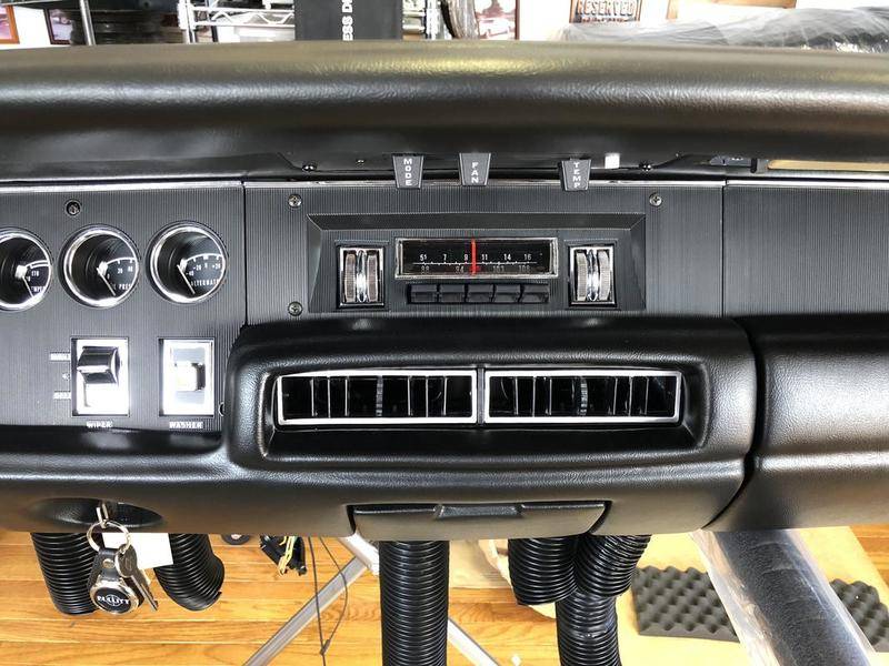

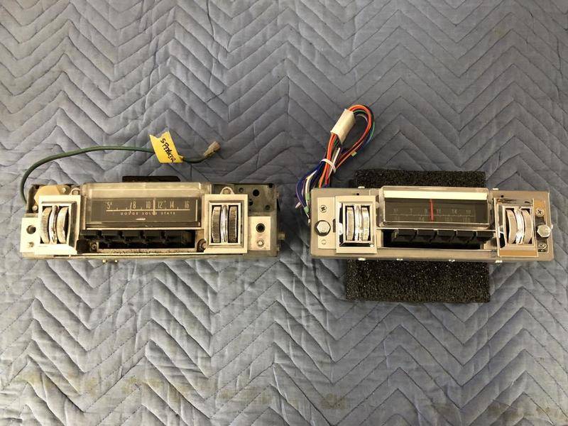

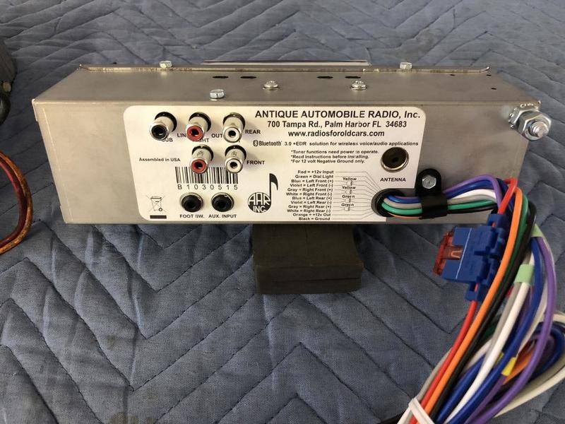

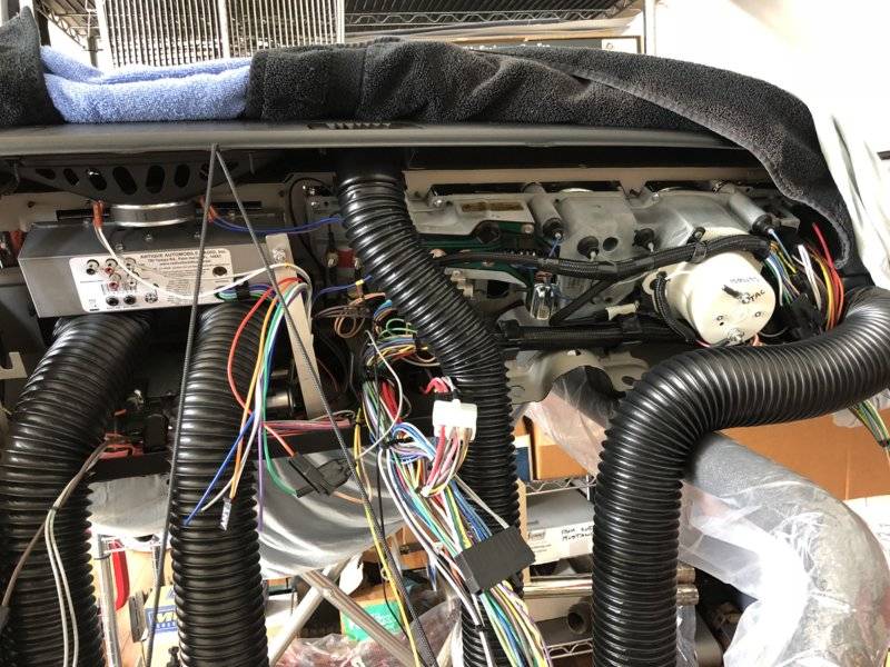

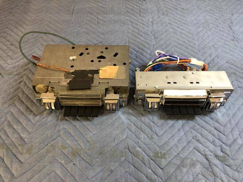

I finally received the backordered AAR radio so I could complete the dash. Radio is Bluetooth audio as well as hands-free phone, not sure how well it works but it looks and fits great!

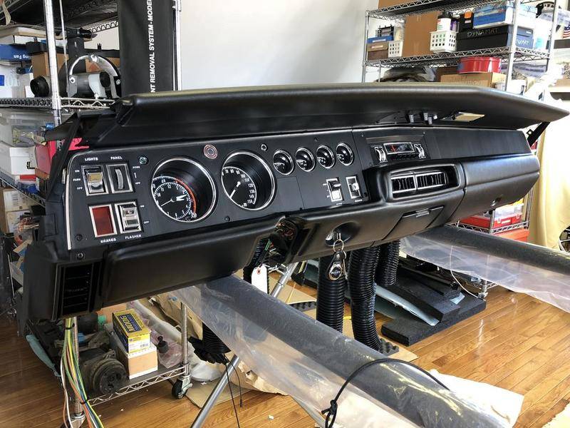

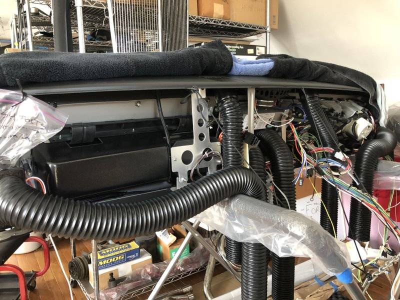

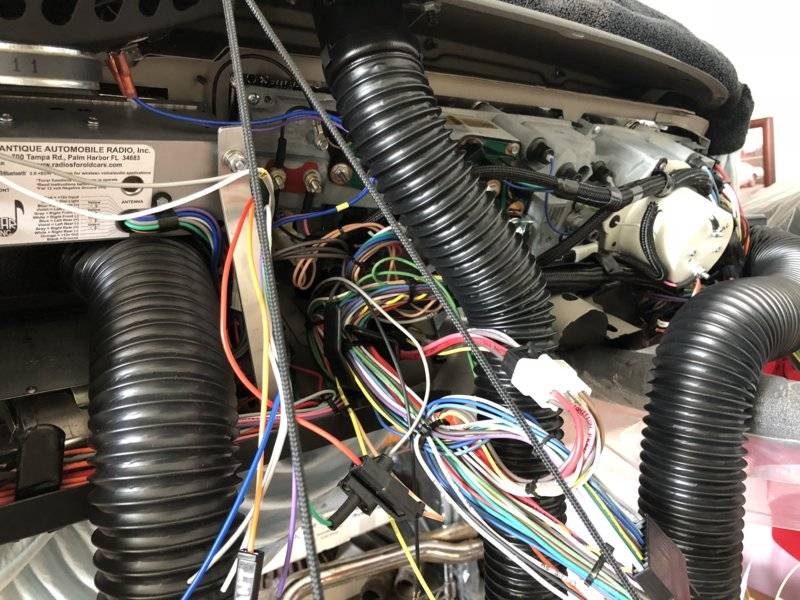

Where are you running the front end wiring through the firewall ? And into the engine compartment ?
Hi Pat - I'd be grateful of a pic of the back of the dash if you have one to see how you routed wiring.
Thanks!

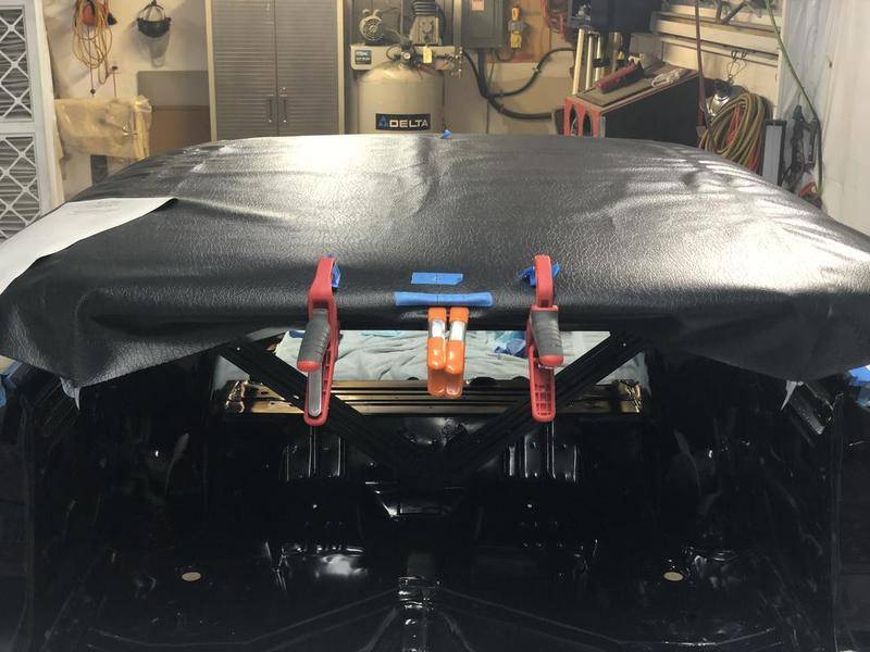

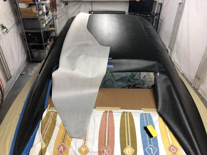

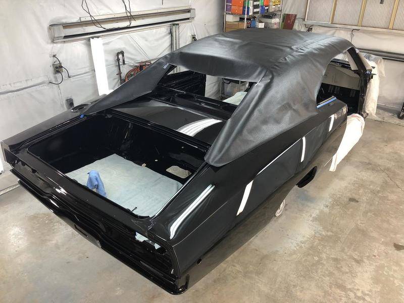

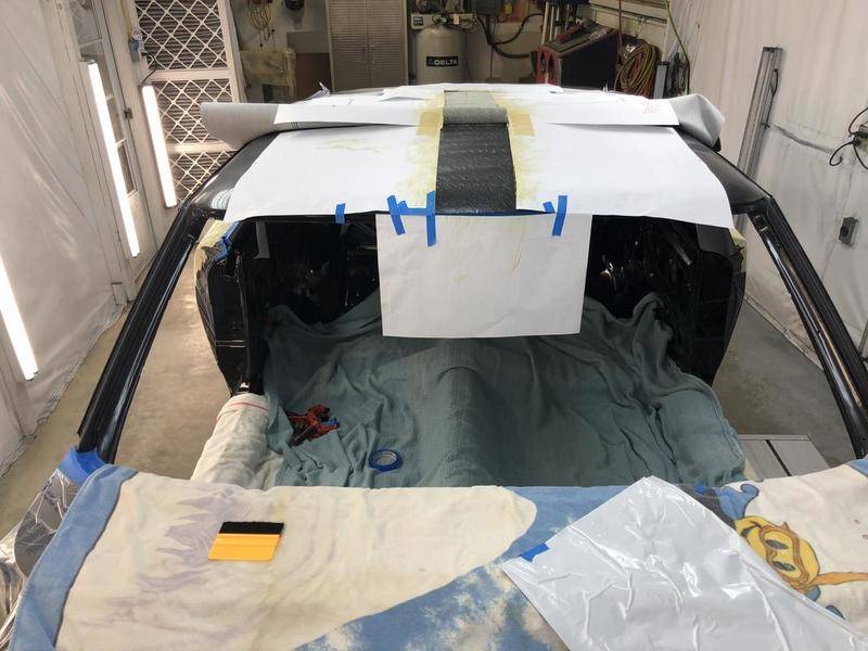

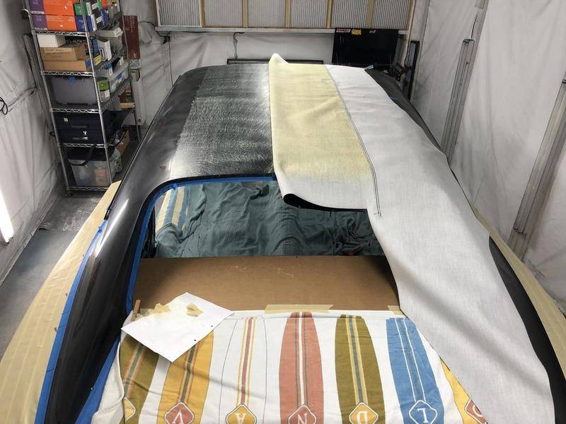

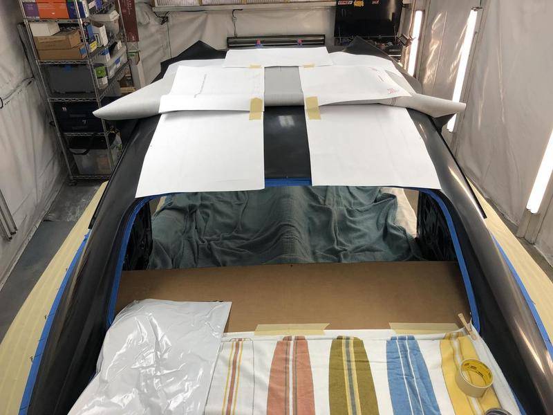

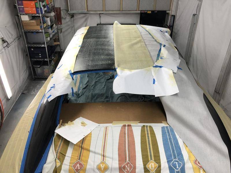

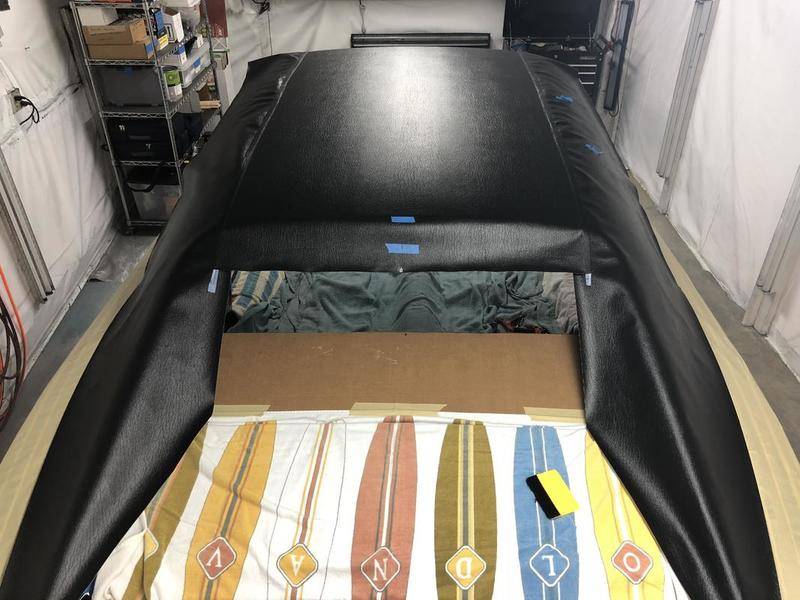

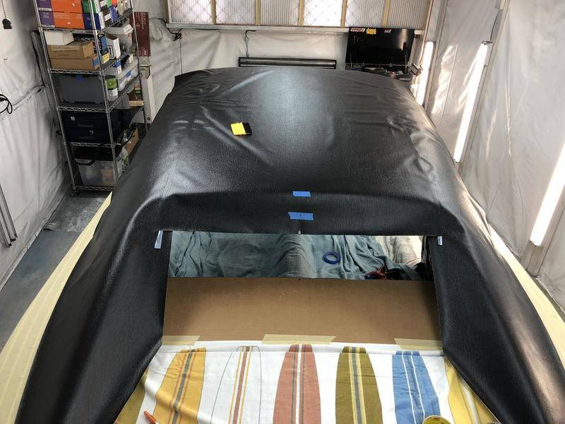

With the vinyl seams even and clamped at the front I glue the center 6” back to front. Then folding over the drivers side I glue over to the seam and then the same on the right side. After spraying the glue on both the roof and vinyl I put some plastic down to let me flip the vinyl over without sticking. Then holding and pulling the vinyl up I remove the plastic and stick the the vinyl down. Now with it glue seam to seam next will be down the pillars.
