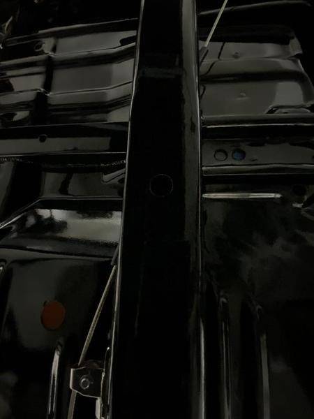

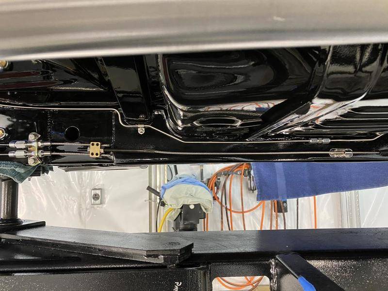

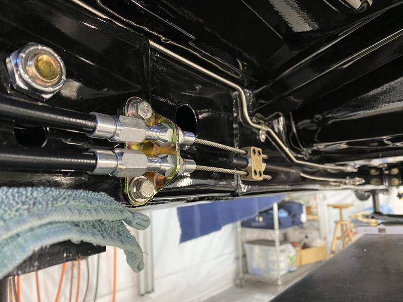

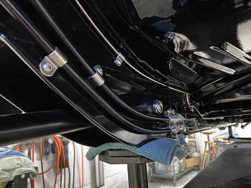

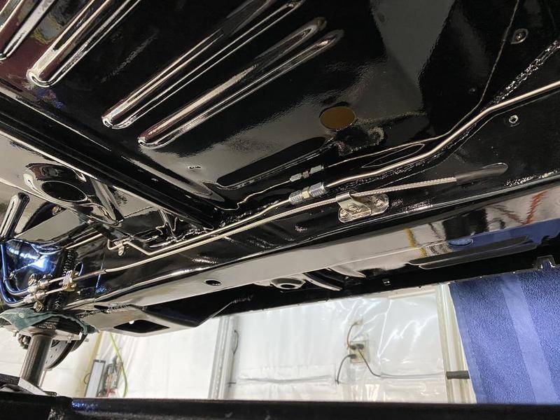

Emergency brake cables installed using a small stainless steel roller that I got from West Marine. It guide the E brake cable after it passes through the sub frame connector.
Thanks
Pat

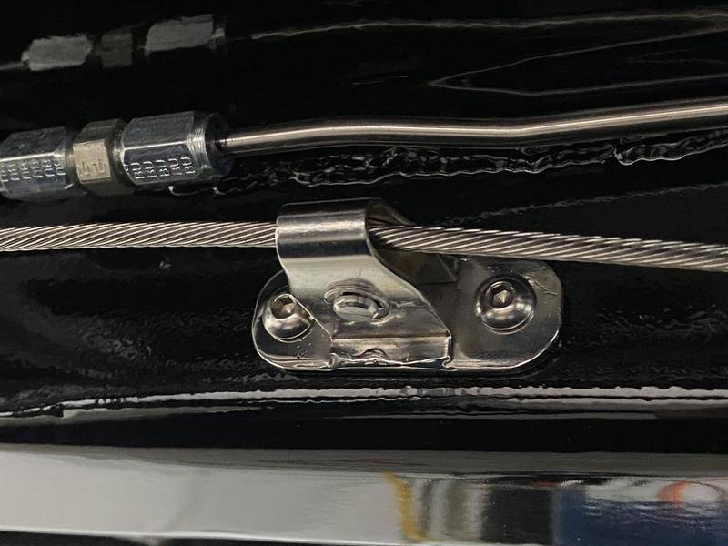

Great build. On the last pic, are you using a nut and bolt or just a bolt to hold the e-brake cable mount? Also, may I ask where you got the e-brake lines? My new factory ones don't work well crossing over 3" exhaust. I want to do as you did and split the cable just before the rear. I was thinking Control Cables, Inc. but have not committed as of yet.
It’s a Wilwood kit design for their disc/drum emergency brakes. I believe is from a Ford explorer?? Locar also sells the same kit.
The mount in the last picture is 1/4-20 bolts drilled and tapped into a 3/16” steel

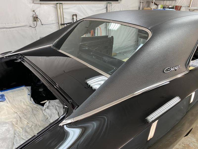

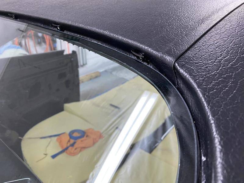

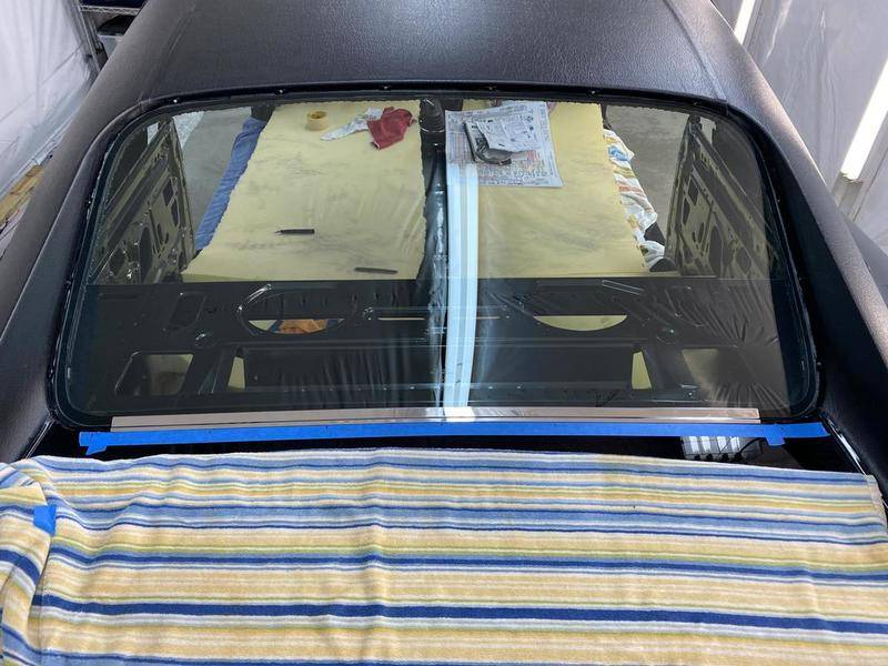

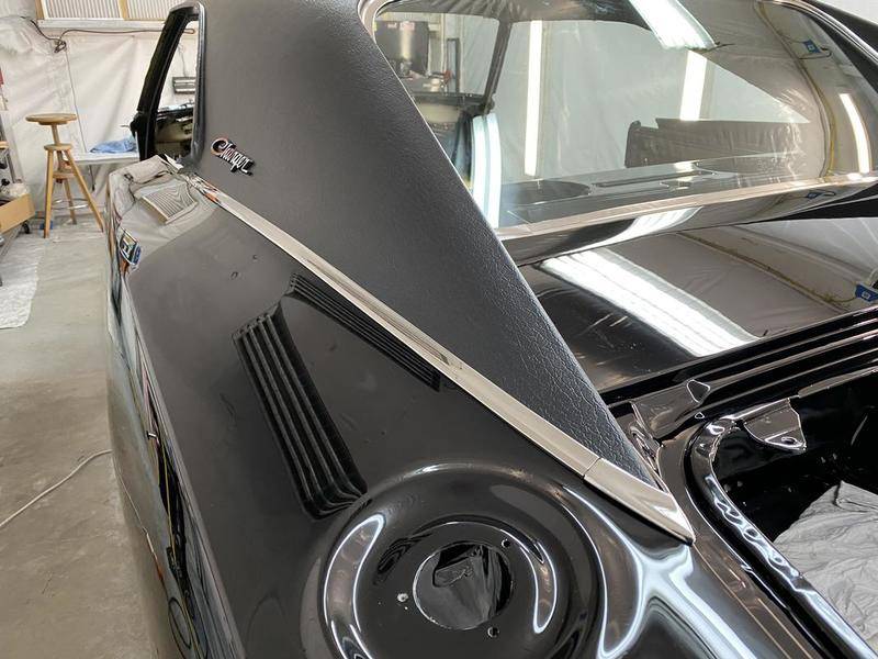

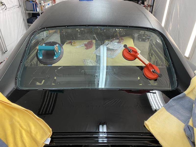

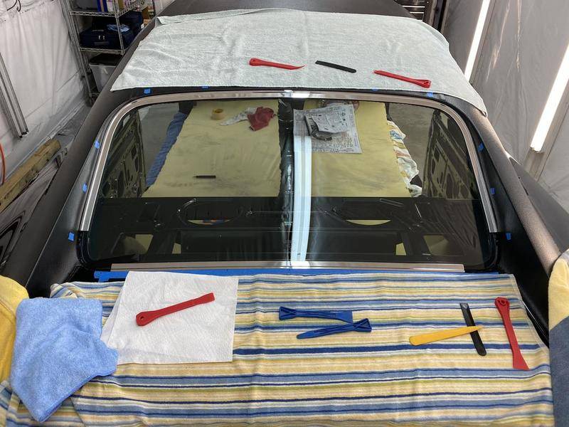

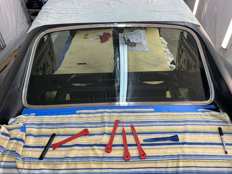

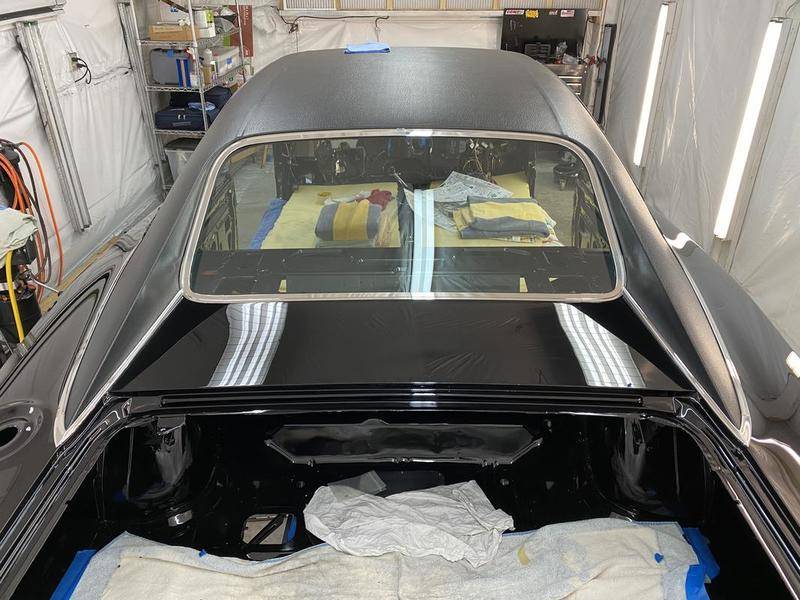

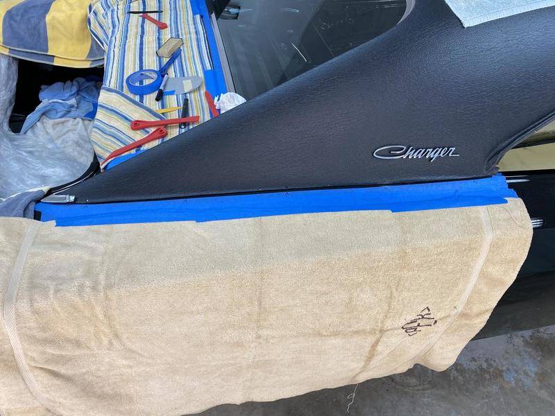

Not a fun weekend installing the rear glass and trim. AMD glass was not a problem but fitting the trim took two or three times to get everything just right. Fortunately no chips or scratches just a lot less hair on my head ;-)

I HATE the window trim. It's a beast to install. I especially like it when you have it all in but that last little clip and ........ Wham. Five clips let go. So take it from me I know seeing those beautiful after pictures are great but no way do they come close to explaining the trouble you went thru. I hate them. But love them so much when they are done right.
Dumb question here Mr. Pat but can these rear windows be put in backwards? Its been awhile since I removed the one from my car but yours looks like the window curves outward and I swear when I removed mine it curved inward. Mine was just laying in place with no trim installed. As always your work is the greatest and I try to follow your way of doing things closely in my own build.

It’s an easy mistake to make, but the glass should curve out.

Rear glass and trim is a PITA but you did a wonderful job!

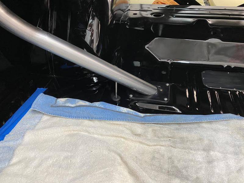

what was the black material you used on the package tray?

Really? Wow that's interesting.
Well I know of a certain sport satelite I did for my brother in law that has the glass in backwards. Face palm.
I painted the package tray the same time I painted the trunk and interior using single stage black paint.

No....the cover you use to protect it during your glass install
