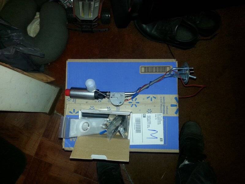

i bought a 90 degree strainer so it sits on the bottom of the fuel tank so it will pick up all fuel . to install i had to remove the float then with the unit in the tank poped the float back on to the unite inside the tank was not e-z .

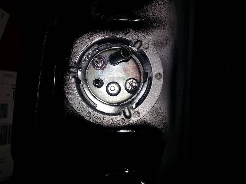

That is what I did with the 90 on the strainer on my 72 RR, its functions ok until i have less than 1/2-1/4 tank. then the sloshing around will sometimes cause fuel starvation.
