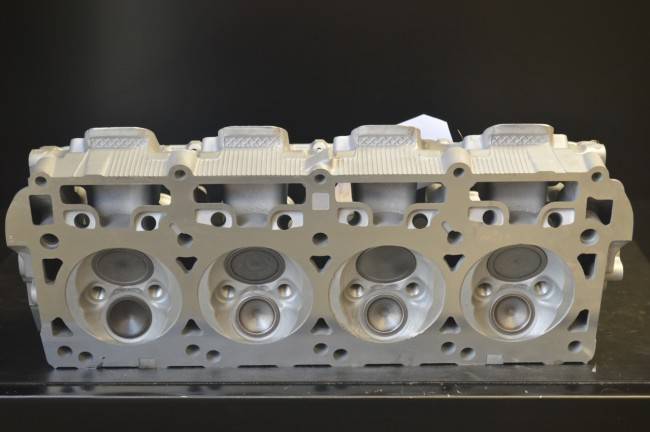

Truth be known they arent hemis. They are polys.
Yes, Captain Obvious, everyone walking the planet knows the 5.7 isn't a true hemi.... :rolleyes:
It's actually pretty darn close, though:
No, not everyone does Private Smartass.
Many people who arent really car guys think its the same as the 426. Heck, how many people call the 440 a hemi?

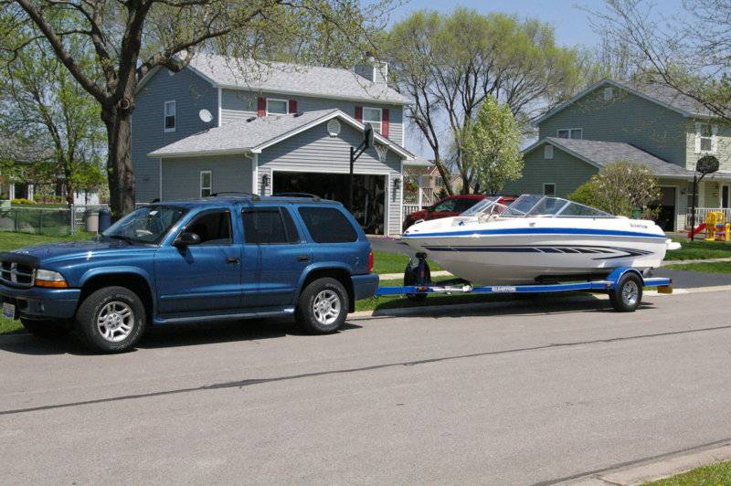

My 4.7 was dragging this around till the '02 Durango got totaled. About 3500 pounds total back there. It labored just a touch to get moving. Found I didn't use the "tow" mode very often. I was happy with it.
