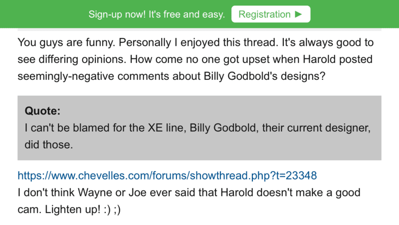

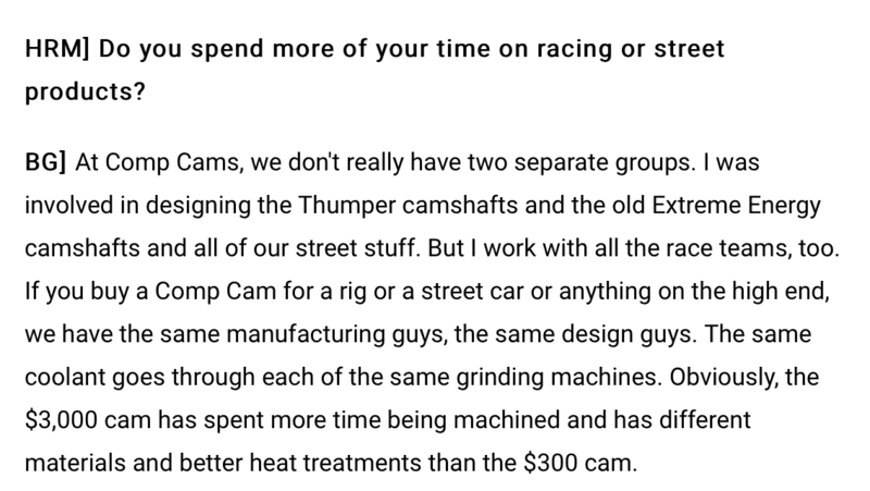

As an aside, because I’ve seen this mentioned on a few forums...... that UD Harold designed the XE lobes.
When the XE lobes were designed, UD was going strong. Why would he have designed lobes for the competition?
I was a UD dealer from 1990 until they closed the doors.
After the first XE cam I tried(since I thought they looked good on paper and wanted to try one), I was talking to Harold about them and he was telling me there were spikes in the rate in the lift curve...... and that it wasn’t the way he liked to design a lobe.
I didn’t specifically ask him if he had designed them(since I wouldn’t have expected he was doing lobes for a competitor), but nothing he said led me to believe he had any involvement with those lobes.
Next time I’m talking to Comp I’ll see if I can find out who did them.
Now, Back to your regularly scheduled cam thread.....
