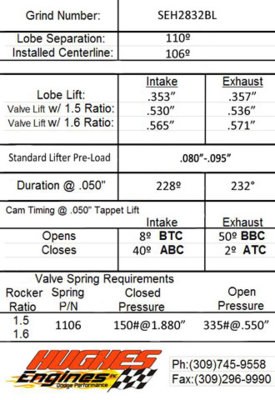

Thank you for the replies. Very informative. I spoke to Hughes a few minutes ago. I gave them all my information, and below is the cam they suggested. Thoughts?

Howards grins Hughes cams but
YOU CAN'T TELL WHAT THE SEAT DURATIONS ARE ON HUGHES CAMS and .050 is meaningless except for degreeing in a cam
that's a lot of spring pressure
that's more cam than you want or need

IMHO the Hughes suggestion is too big for what he wants to do
more like the 285HL comp

I think you can look up hughes profiles on Howard's master lobe list and find the seat durations. Kind of silly that hughes doesn't list as much information as Howard's when they are the same. Imo the Howard's/hughes profiles are very aggressive and go beyond what other companies use for lift in there profiles. But, plenty of guys run them. I'd be more enthusiastic about using the aggressive ramps for racing then for a street build.
