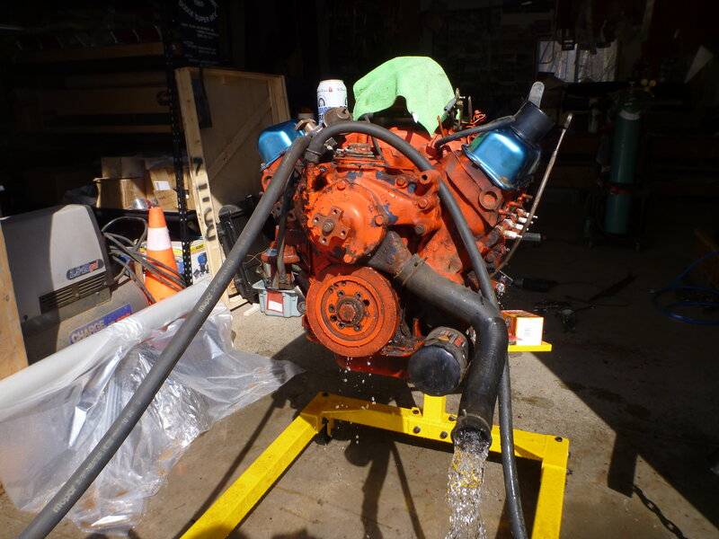

I flushed my block and heads before replacing all the frost plugs in 2016. First time it's been flushed since engine rebuild in 1978. Radiator stock 2 row, fresh core, 053 x 22". 7 blade fan, no shroud and a 190F thermostat. Right where the temp runs.

This is what your up against,if you have installed that rad n run it on your car the rust n calicum build up is through the whole system.You will need a complete flush witch the rad shop should do,n than have them either flush it if its in good condition or recore it.Thats a damn good price for a recore,n when you install it put the blade fan back on n the proper shroud n it will be better than new
save yourself a lot of money if that rad shop is good,if you have the proper mopar tanks they will clean them up to looking like new so the solder will stick n than paint it with a special rad paint n it will look like stock,rad paint is rad paint n solder is solder.
