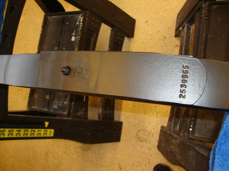

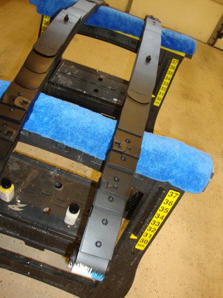

Found my pics of the Eaton springs that were converted to concours. Several of the small leafs were replaced from the original set. Eyes bushings are NOS. The liners, pads, clamps etc are from Frank Badalson.....Holes had to be drilled in some of the leafs to accommodate the correct factory clamps with tabs.
This is only if your going for an OE type look.....If not use them as is....
