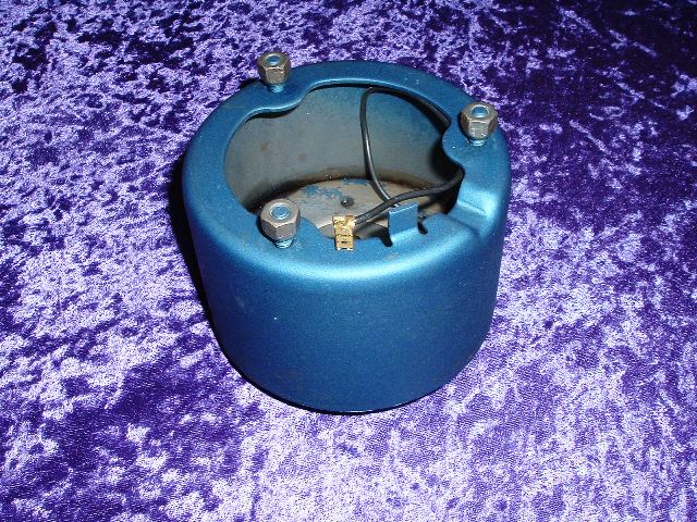

You definitely will need an adapter if your car did not have one already. The short smooth side one like in the picture below is the correct one for A and B bodies. I found an aftermarket one made out of aluminum by Flaming River that I think will work. It was on Classic Industries sight for $119 Part number MW 716.
