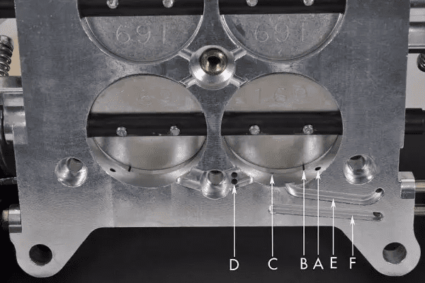

I believe you are incorrect... Ported vacuum increases with the velocity within the carb venturi, ie when the car is under WOT. The velocity through the venturi runs across the ported vacuum port on the side of the venturi (or a little under it) sucking vacuum out of the nipple, or creating vacuum. Its just like a header evac system... or a venturi vacuum pump that uses compressed air across a pipe end to create (a lot of) vacuum. The faster the velocity across the port, the more vacuum it creates, ie draft tubes in the early 60's cars for crankcase ventilation didnt work unless the car was moving. Manifold vacuum is almost the opposite: It is highest when the carb is restricted, ie at idle. When the carb cracks the throttle, vacuum (below the throttle plate, ie manifold) is bled off and manifold vacuum goes down. There is 3 times when both ported and manifold vacuum are the same, one is when the car is accelerating and the ported vacuum is rising due to the increase in the velocity of air through the venturi, and the manifold vacuum is falling as it approaches WOT, The vacuum values will cross at one point. 2nd is the opposite circumstance, they will cross again when decelerating. 3rd is when the car is not running. The vacuum delay valve (from what I have read in a Mazda FSM) allows vacuum (ported in this case) to pull the advance in a typical manner in real time to meet engine demands, but will HOLD that vacuum level between the valve and the distributor for 2-8 seconds to allow the distributor to NOT snap back to 0 vacuum advance when the throttle is closed abruptly, ie braking. This reduces NOx emissions, Thats all it does.
That is not all correct. Ported vacuum is not connected to the center venturi itself and is not relying on venturi pressure drop. It operates just like manifold vacuum with the main difference that it only begins to function after part throttle tip-in. At wide open throttle, both ported and manifold vacuum will be the same; nearly zero. Ported vacuum, in this example, is 'C', waiting for the throttle plate to move to expose it to underlying manifold vacuum. Regular manifold vacuum would be routed through 'E'.
Photon is correct.
