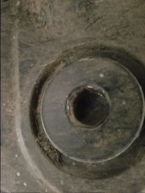

I move alot of snow in the winter. My dad kept borrowing my backhoes to move snow in town so I didn't always have both of them when needed. So he went and got his own loader tractor. A 2015 CIH 115 6.7 INVECO and a loader. A bit more than needed but a tractor that hopefully wouldn't involve anything more than basic annual maintenence. The hour meter say 200. Barely broke in. The salesman told him the oil had never been changed. He looked at it and bought it. We've used it about 75 hrs and I decided to change the oil today. This is what I found
some knuckle dragger has rounded out the drain plug. It's a (I believe) 12mm hex. Or was anyway. I don't have an easy-out that will work because they are all too deep. The plug is recessed into the oil-pan so no vice-grips or channel locks. I'm hesitant to weld a nut to the plug because I don't want to **** up the electronics. Kind of a serious buzz kill. I had to walk away from it for the night. I was feeling good because last week I assembled and built an adapter to mount the sand/lime spreader on the 2 pt.

Two ideas :
1 - use standard size hex or something snug, off normal size. I've used Torx bits on hex heads that were rounded like that. Tap it in with a hammer.
2 - use a cutoff wheel and make it like a slotted head screw. At least it will give a place if you want to tap it out with a chisel and hammer.
I never thought of the second. Good idea, it would take a chisel. There is a drain plug on either side. One completely rounded, the other 3/4 rounded.
That sucks. Guess that's what happens when people use standard tools on metric fastners.
If you ground on the pan, close to the plug, or on the plug, then you can weld a nut to it. Path of least resistance.

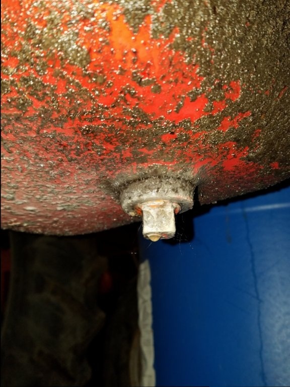

why couldn't they just stick with this?
Time to find a set of blunt nosed extractors. Northern tool - Klutch Screw Extractor item #42124. A little pricey but will do the job. Your local NAPA may have a equal.

Drill it and use an easy-out and replace the plug
make sure you get all the metal out

I thought about that. The tractor has DEF and several other electronics. I don't wish to void any power plant warranties. The machine was purchased private sale from a salesman at a CIH dealership. Just goes to show all vehicle salesmen are soul-less bastards

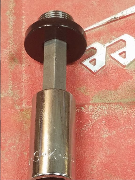

Had to throw down $18 to get this hex/socket that will only get used once a year. Had to drive it in with a hammer
