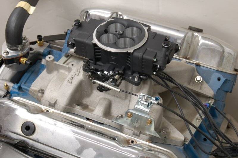

I just got the new 4150 style Holley Sniper today. Looks cool. I haven't fired it up yet but I like some features on this model better than the original one.

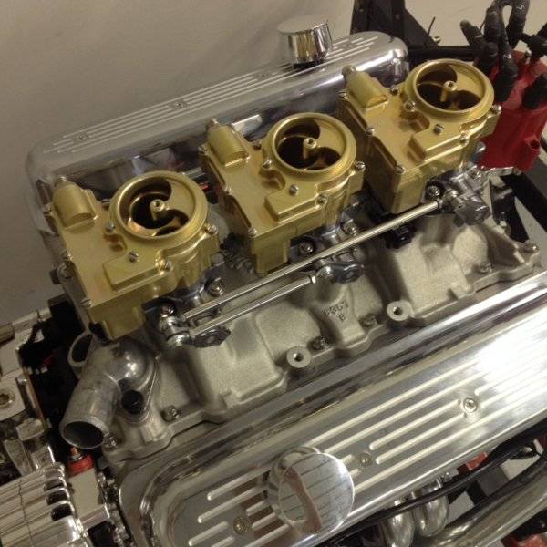

Back to the GTO. I had All American Carburetors "restore" the 3 Rochester 2bbl carbs on the built 421 right before Cruisin the Coast 2018. I had always had problems with them leaking fuel from the surfaces that are where the body and top plate of the carb comes together. Fairly common, because of the 3 bolt design that holds them together, so common we had a couple of Tripower GTO owners say "they all leak"...:rolleyes:
Well I found that unacceptable, and I had a local mechanic use "parts store" rebuild kits go through them, that took care of previous owners using ethanol laced fuel without any additives to fight the effect of "gooping up" the various non-ethanol compatible parts. That helped, some, but not long before they were leaking again. So that's when All American Carburetors went through them, made them look like new, NO MORE LEAKS, but they rebuilt them to stock specifications, and the 421 is a good bit far from stock.
So I'm sending them to :lowdown:Dick Boneske, an expert with the Tripower setups, especially modifying them for high performance, even stroked performance Pontiac engines. THAT is going to be the LAST shot for the Tripower carbs. Now I expect great results, but if I get another call from my wife, who is screaming so loud into the cellphone I can't tell what she's saying, because the carbs failed again, killed when hot, wouldn't start after a brief stop, or other problems, that's when we are going to EFI, if we have problems with the carbs after Dick works his magic. The other factor is we certainly don't want to "leave any power on the table" after having invested in the parts and labor when the already massaged 421 was rebuilt by us through a local shop and taken several steps up beyond where it already was. By having a fuel injection system dialed in by experts who have the equipment, software, and experience to tune an EFI system to it's full potential, along with the way EFI "adjusts" to the environment it finds itself in, we can be assured that we get the full value of money already invested.

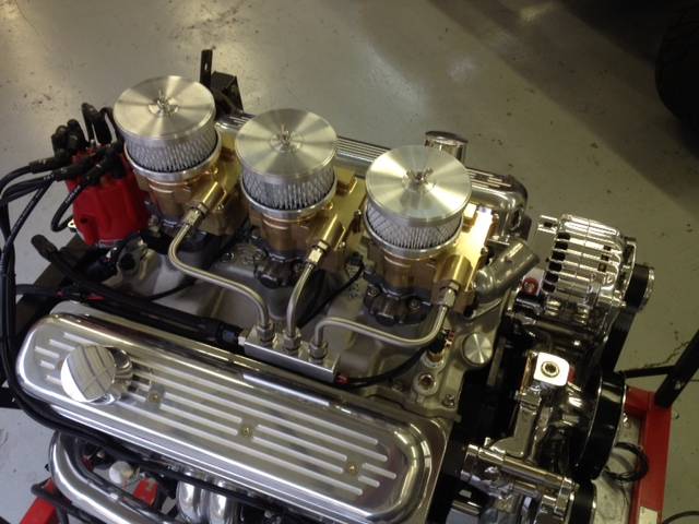

A local couple who have a 65 389 Tripower GTO got the finest EFI system I've seen specifically for a Tripower setup on a Pontiac (although the F&B system is outstanding as well) and when the Rochester look alike setup was done along with the supporting hardware (fuel lines, fuel pump, etc) the owner said it was the best :eek: EIGHT thousand dollars he'd spent!
I know the FiTech 3x2 system would work great on the 421, but that looks like my Holley 6bbl, and of course my wife wants the one that looks like Rochester carbs.
