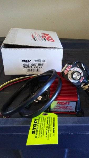

When I was running the 500 stroker I found that the vacuum advance in the stock distributor was too much, so I disconnected it. I liked the idea of being able to dial in more advance for cruising. I bought an MSD pro billet distributor, which has an adjustable advance curve, and this MSD timing control where you could dial 15 degrees in or out. Never got around to installing it, and now that I have sold that engine, I may not end up using it. This is not high tech or automatic, but it does give you an easy way to add or subtract timing.
That one is very nice. I already had the basic control box, so I went with this as an add on.

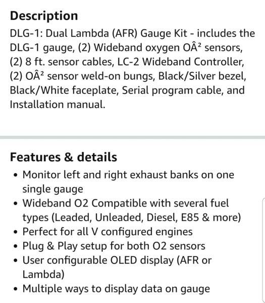

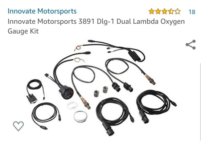

I saw a cool piece from Innovate Motorsports that will shut off the nitrous solenoid (and fuel solenoid I assume) if the A/F ratio goes above or below a user defined preset.
I have the Innovate Motorsports Dual Wideband O2 sensor system and got it installed a few months ago.
It's really cool and incredibly informative, even for a rookie like me. The point is that I am trying to incorporate modern technology into my carbureted 50 year old car, and it's obvious when you have 3x 2bbl carbs how this O2 A/F ratio data can help.
Innovate Motorsports 3891 Dlg-1 Dual Lambda Oxygen Gauge Kit https://www.amazon.com/dp/B013UG0GHC/ref=cm_sw_r_cp_apa_i_ZPC6DbM02GVYC
