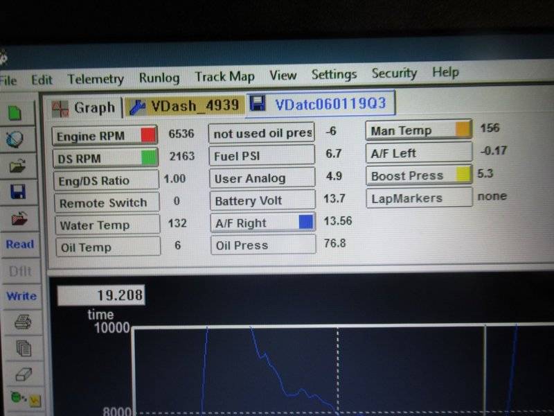

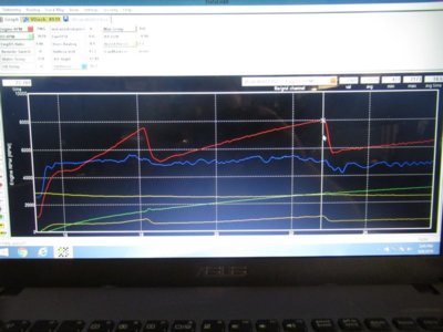

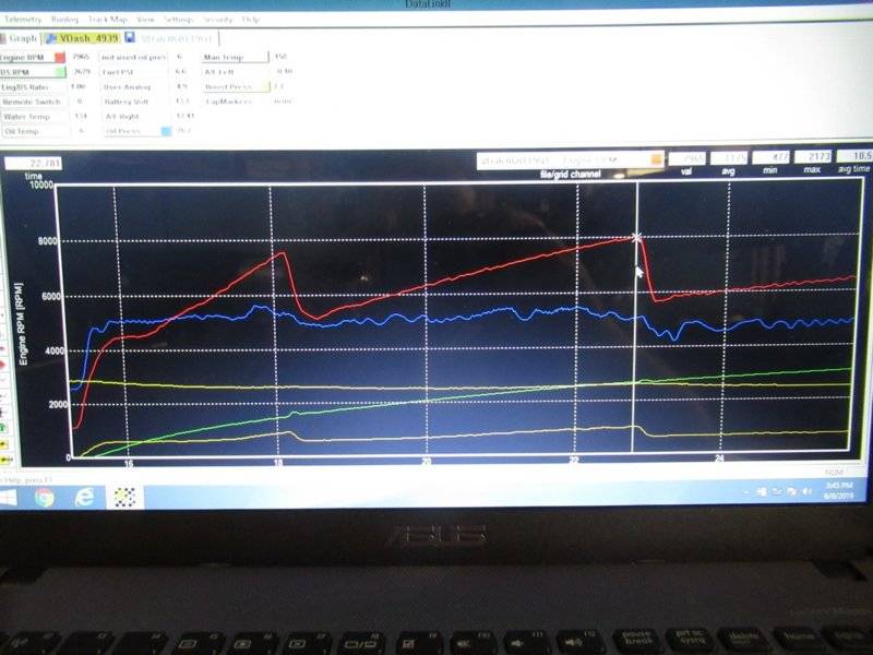

I didn't notice if it was able to datalog. Otherwise you need the PoBoy logger AKA GO PRO!!Very nice reply my forum friend!

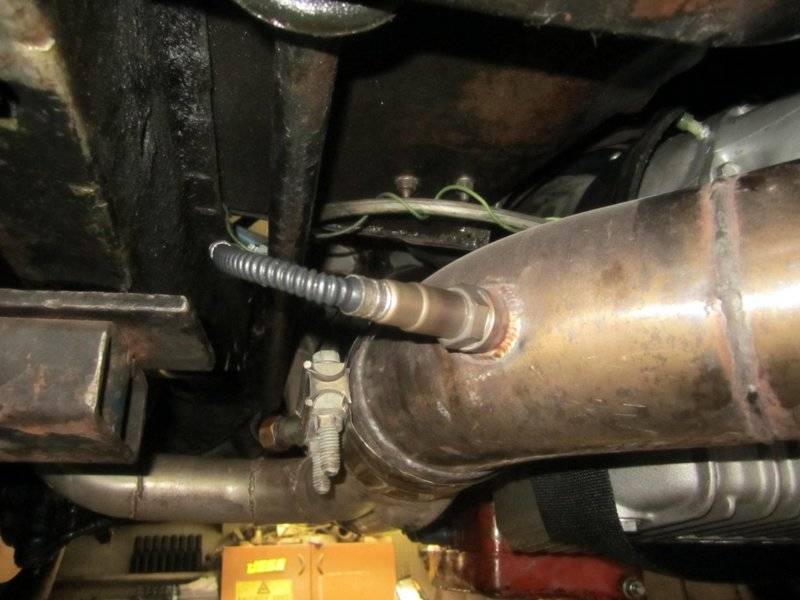

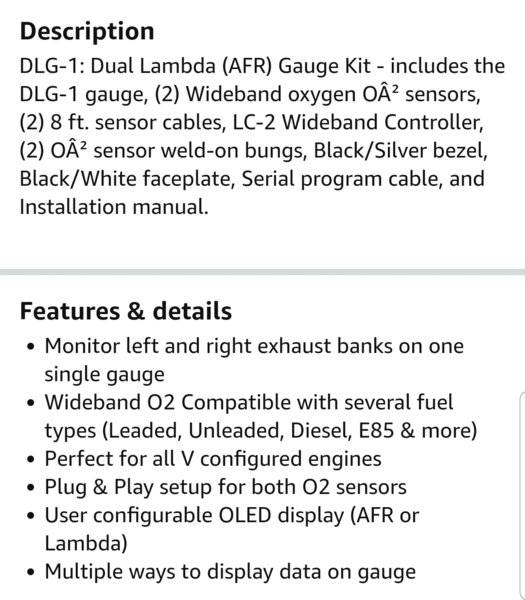

I saw a cool piece from Innovate Motorsports that will shut off the nitrous solenoid (and fuel solenoid I assume) if the A/F ratio goes above or below a user defined preset.
I have the Innovate Motorsports Dual Wideband O2 sensor system and got it installed a few months ago.
It's really cool and incredibly informative, even for a rookie like me. The point is that I am trying to incorporate modern technology into my carbureted 50 year old car, and it's obvious when you have 3x 2bbl carbs how this O2 A/F ratio data can help.
Innovate Motorsports 3891 Dlg-1 Dual Lambda Oxygen Gauge Kit https://www.amazon.com/dp/B013UG0GHC/ref=cm_sw_r_cp_apa_i_ZPC6DbM02GVYCView attachment 877284 View attachment 877285

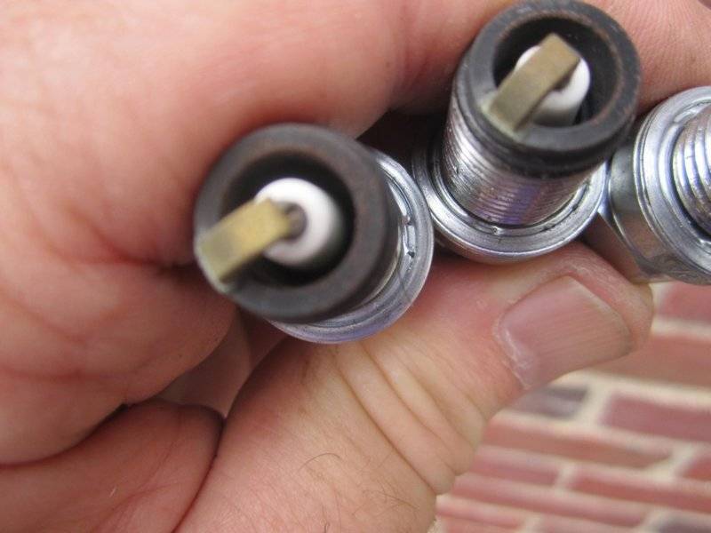

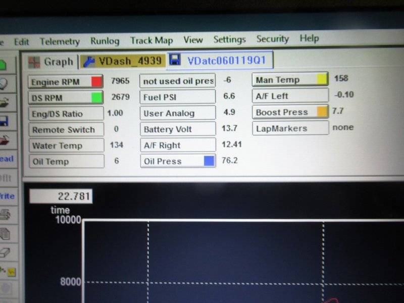

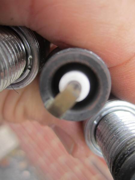

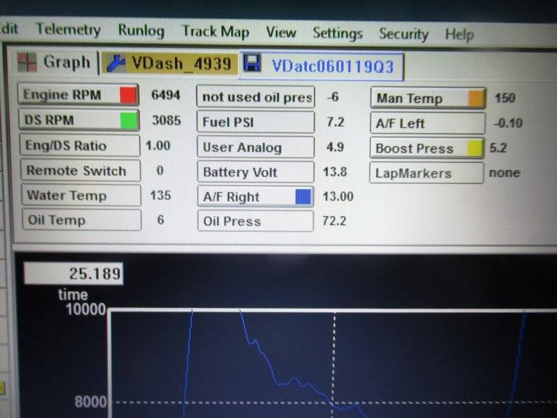

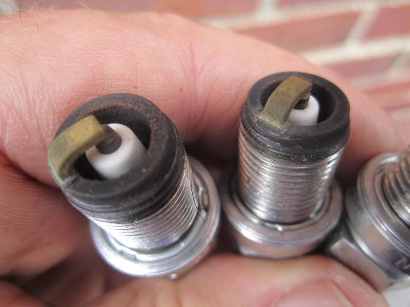

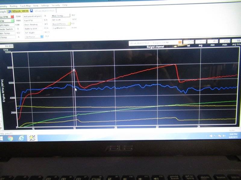

Once you can see the recording and match the plug readings then you can be on top of the tune. Takes practice!
Don't try to use EFI tech with carbs.Use Carb tech! Plenty of places to help answer your questions!
