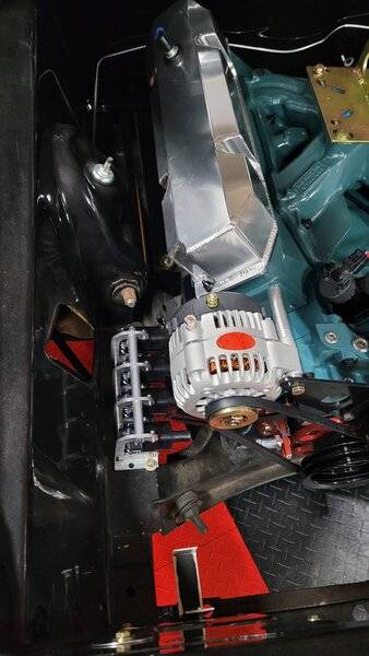

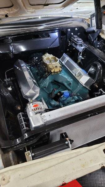

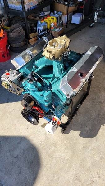

Haven't posted in a while cause there really wasn't much to say lol. But things are starting to move along. A lot of parts are either ordered or already delivered... Full TTI exhaust, Aeromotive tank and in the tank pump, etc. It was big for me getting the motor and trans done. Still a long way to go but we're getting there.

Awesome.... is it just the camera or is the water pump housing a different color than block and intake ?
No it's not the camera, you're right lol. Long story short, I brushed the block, pan, tc cover, and wp housing with por 15, and used Bill Hirsch rattle can on heads and intake. The heads and intake probably would've matched better if I used grey primer instead of black. But oh well lesson learned. Side note... I will never brush a motor again. I don't care how good the color is lol.

Me, I find it relaxing. With a Purdy 1 1/2 inch, tapered sash brush, I don't have to mask. Load up the brush with Hirsch paint, give it a slight twist to get a leading edge, and cut in the line you want. Keep a lot of paint in the brush and you can make good time. Can scrub it in with a brush too.

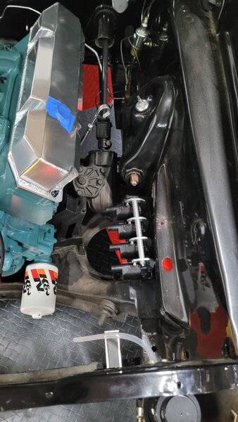

I take it you are running a coil on plug setup since I see a cam sensor in place of a dist ? Ron
Seen a guy in Md where I live with a setup like your running. He had the 4 coils mounted on the valve covers with brackets he made. If you dont mind me asking since you said its a Holley EFI is it a Holley Controller to work the 8 coil setup ? Thanks for the info and good luck with it as it is looking real good. Ron
Yes it all runs through the efi, cam sync, and crank trigger. No need for an ignition box. I'm in SJ about an hour from Cecil. Hopefully we'll run into each other at Atco or Cecil one of these days. I'd love to check out your car in person. I've gotten a lot of great info from you searching past forums. Thanks, Walt
