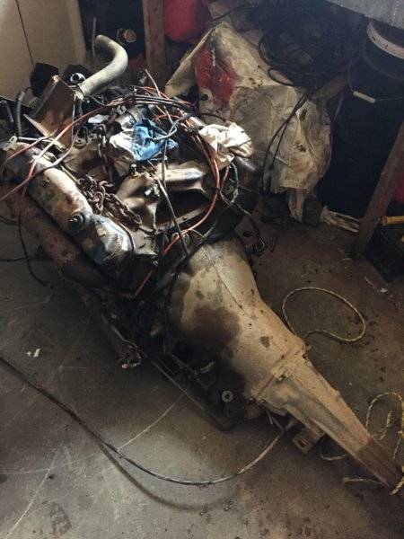

440 w/727 out of a 1979 Dodge motor home, are those any good and is it worth buying for $500? Seems to be in pretty good shape but have not heard it run.

It's all in one piece. Seller says it ran when he pulled it out. The plan is to keep it mild and drop it into my next Mopar.

Not sure about the heads (wish they were 915's :D) Motor is a 1977 cast crank (the engine pad says: 7T 440 E).
Block casting # is 4006630-4
It turns over and there is oil in the pan.
Carb is the Carter Thermo Quad.
The 727 is the short tail model.
