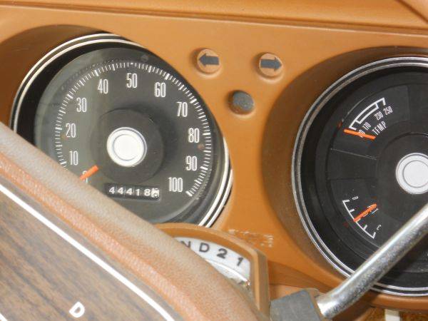

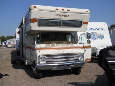

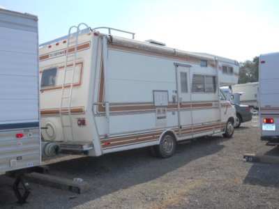

This is true.Being a Motorhome motor, you can be guaranteed sure that it's never been revved anywhere near redline, had foot on the floor neutral drops done to the tranny, and other abuses that big blocks get! And they don't have many miles on them to begin with. Good Luck
MH engines often came with double roller timing chains and windage trays too.
