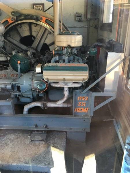

331 hemi runs the lift at a gold mine in cripple creek co
