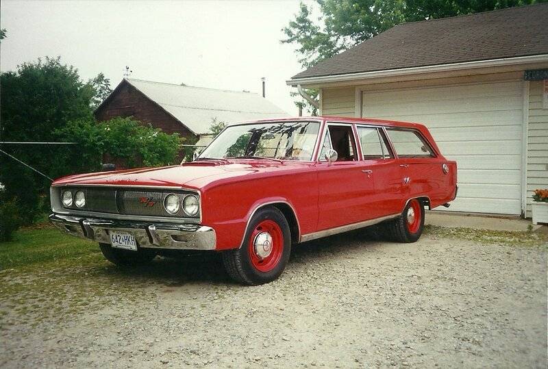

I used to break left side motor mounts on my one-of-none 1967 Coronet R/T station wagon. I built it with a 440/4-speed and 3.55 gears on a Suregrip 8 3/4". The combination of my heavy right foot, heavy launches, and a heavy car resulted in a few broken mounts. I tried a solid mount on that side, but could not accept the vibration and loose screws and bolts it produced. I found that Year One sold a mount that had floating tabs encased in the rubber mount that would lock together when under torque to prevent ripping the mount in half. Mancini Racing has the same type of mount in their catalogue called Polyloc. They are sold as pairs for less than $200.00. I think I was able to buy only the single mount that I needed at the time (thirty years ago) from Year One. After changing it, I never had another failure. The mounts are not too bad to change. Unbolt one side at a time and either lift or jack that side of engine up to get engine bracket and rubber mount out. Change the rubber mount on the steel bracket and reverse the process. You might be able to get away with changing only the left hand side, as the right side is always under compression.
View attachment 1097257 View attachment 1097258 View attachment 1097259
....your ride is awesome. I really dig it.
