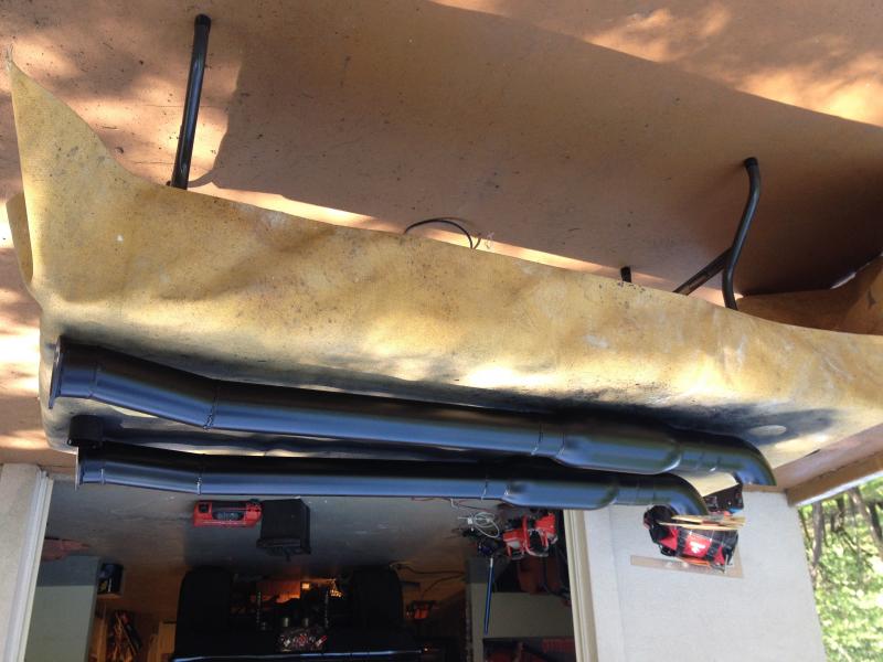

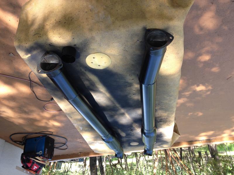

IMG_1065.jpgIMG_1066.jpgRandom Mufflers are required for Wednesday night racing at Sonoma
View attachment 258135View attachment 258136Random Mufflers are required for Wednesday night racing at Sonoma
race bullets!! those won't slow it down a bit, i had a set i use to run on my belvedere. it was faster with them. i might try some ultraflows on my RR eventually. need to get the best times out of i can with the present combination to see what effect the mufflers have if any.

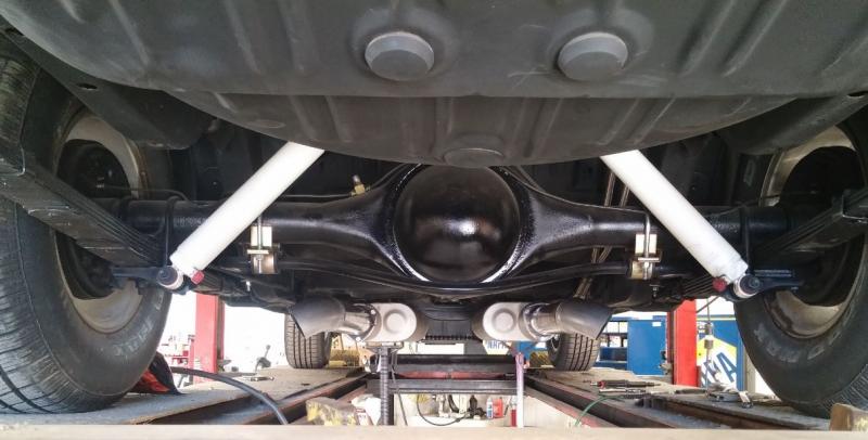

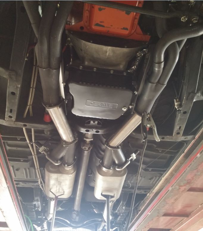

Hooker aero chambers
nice sound at low rpm , noisey at high rpm . no drone
I have them with Hooker competition headers and 3" mandrel bent exhaust I built , dumps at diff .

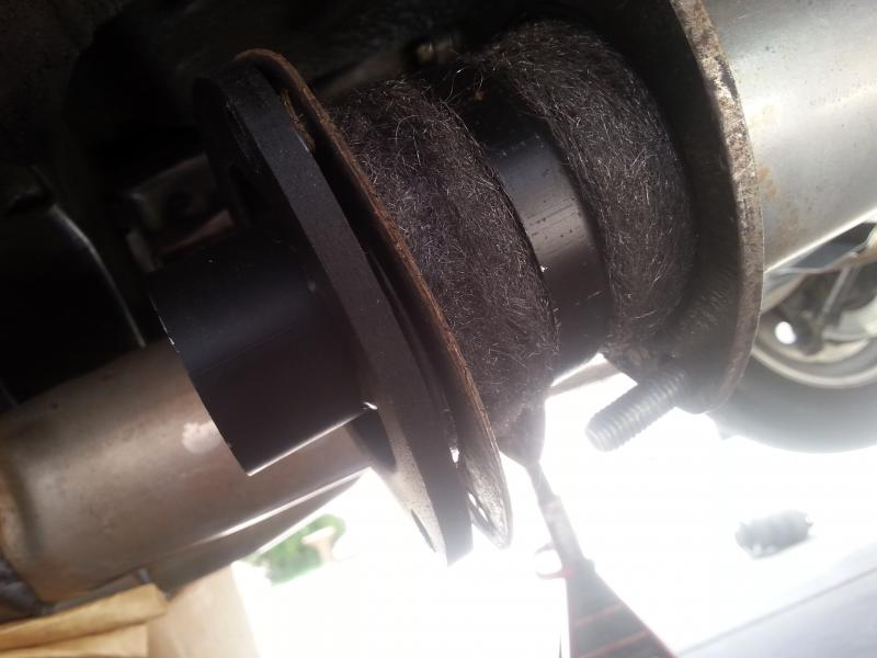

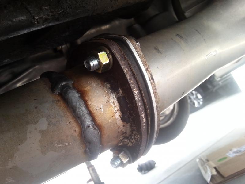

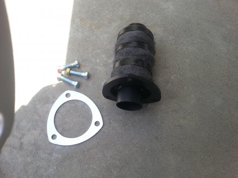

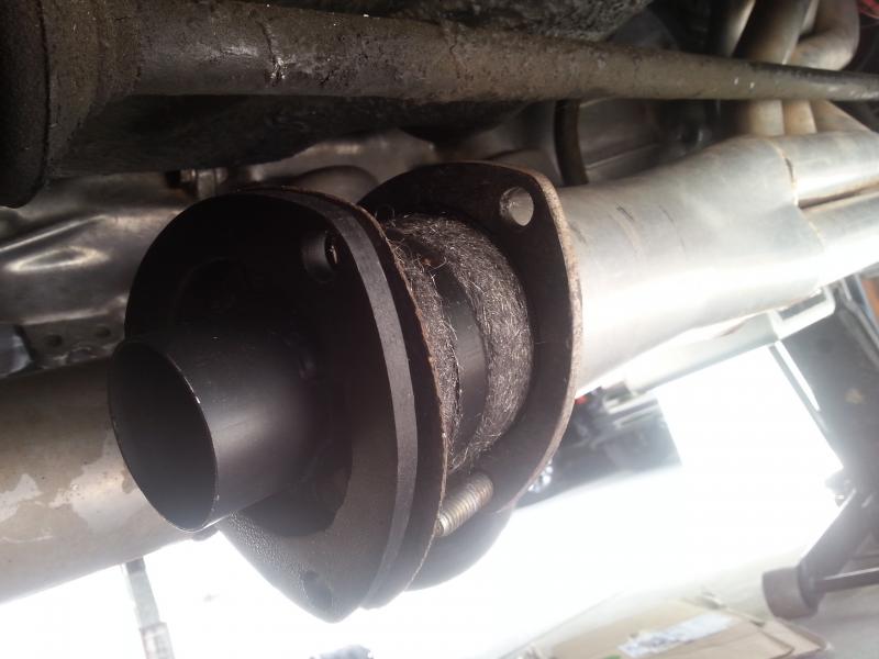

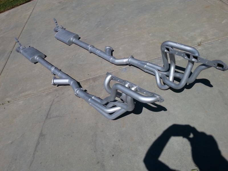

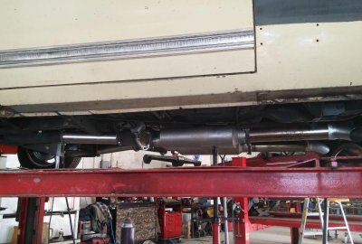

Here is my system (Hooker Super Competition Headers). 3" exhaust pipes all the way back with Magna-Flows...but...was still too loud for me so I bought "CC Inserts" (Summit or Jegs now has them) and inserted them into my header collector between header and exhaust pipe. It really made it quiet...so much I could pull up beside a cop and rev it up to 5000RPM and he could not give me a ticket for loud pipes. For more "street" performance I take out the CC Inserts. When I take it to the drags I just drop the entire exhaust system and run it out the open headers (saves about 90lbs also, total).
PS: When I set up the exhaust system I welded in the old fashioned "lake plug cut-outs" but I have never opened them.

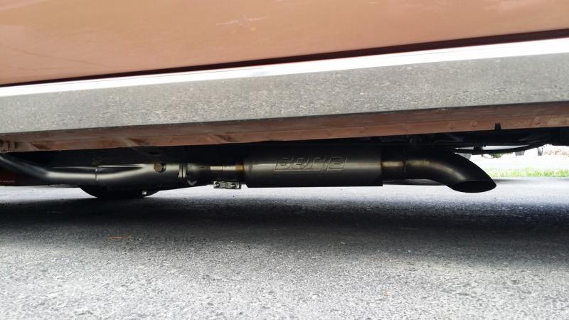

I'll get a video up on YouTube soon. I'm in the middle of swapping intakes and putting in a new rad. The car sounds amazing. Personally I love the Borla sound but it is loud. The way a 572 ci Hemi should be.

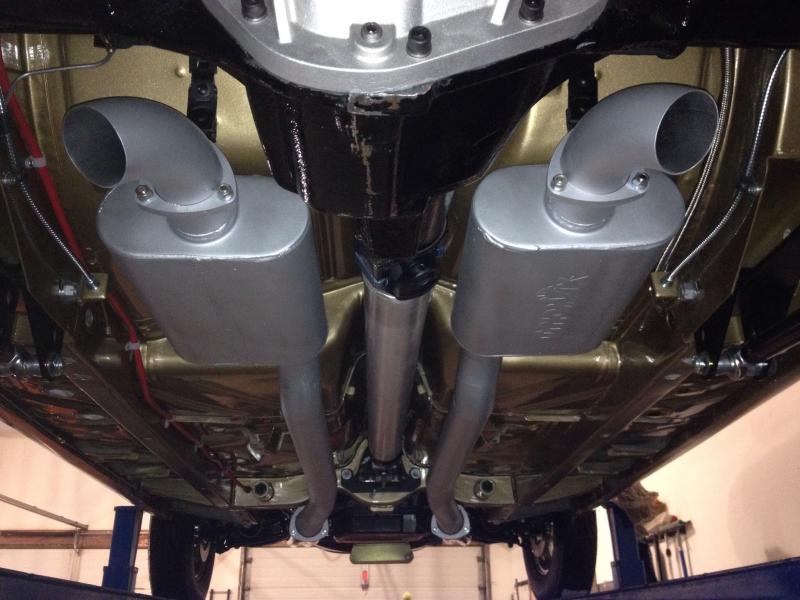

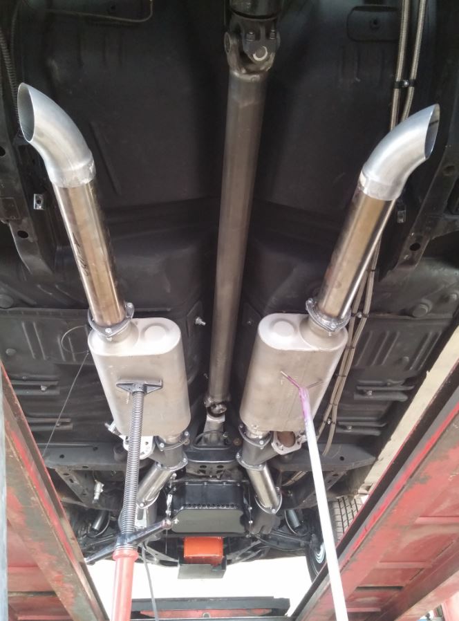

Hooker super comp 2" primaries, 3.5" collector, 3.5" QTP cutouts, 3.5" flowmaster 50's, 3.5" turn-downs.
545hp... obnoxiously loud & I love it... others do too! You would not believe the thumbs up and cool car comments I get, on second thought... you probably do!
