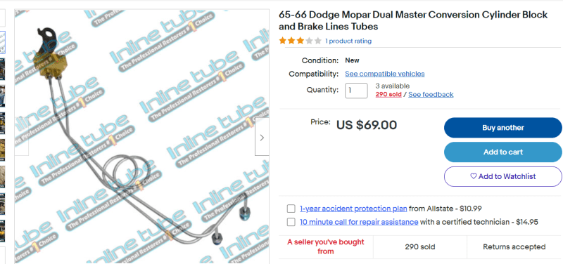

65-66 Dodge Mopar Dual Master Conversion Cylinder Block and Brake Lines Tubes | eBay
1967 DODGE CHARGER 6.3L 383cid V8 Master Cylinder | RockAuto
These parts are very inexpensive. I should have mentioned to replace the rubber lines as well.
I use only synthetic brake fluid in my cars. I've had the same master cylinder in the Charger for over 20 years.
The master will likely come with plastic bleeder plugs.
Bench bleed it very slowly, I don't like to go full stroke on the master if possible.

I think that sort if defeats the purpose of having a dual master cylinder because that block doesn't have a differential pressure valve in it. That's what saves your but if a brake line breaks, not just the dual master. That is a straight forward design, but what I'd like is a 67 metering block and lines for mine. I haven't been able to find an accurate reproduction of one yet, so I may have to go the Dr. Diff route? Not sure. Thanks for sharing tho, the master looks like what I want.

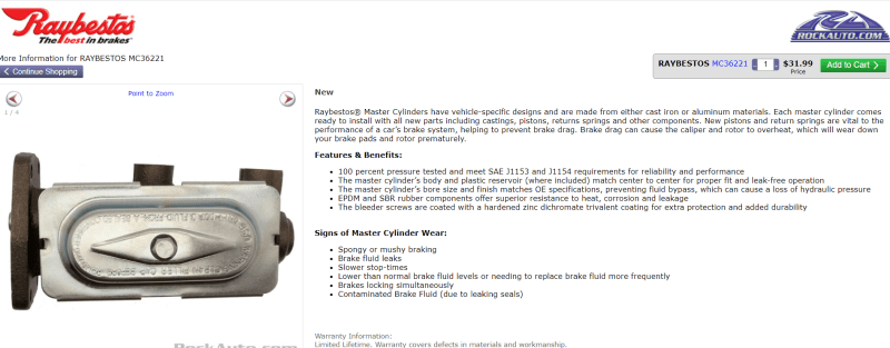

I saw those on Rock Auto, great deal it seems, but which one is for power brakes and which one is manual, and which is for front disk? There lack if application info kind if turned me off.
I think I'm going to the parts store and getting part numbers for each type of MC, then use Rock Auto's crossover search to see which one is which. Maybe I can do that today? Have to see how the day goes.
I had the Raybestos 36221 on my 66 Plymouth with 10" power drums and it worked well.
But you are correct I think manual brakes would be a different bore size, but he said he ordered a new booster so I knew he had power brakes.
I think front discs on a 66 are extremely rare and that master would have a larger reservoir section for the discs.
I think I'm going to swing by the parts store and get some part numbers just to see. But it would be 67 front discs.
