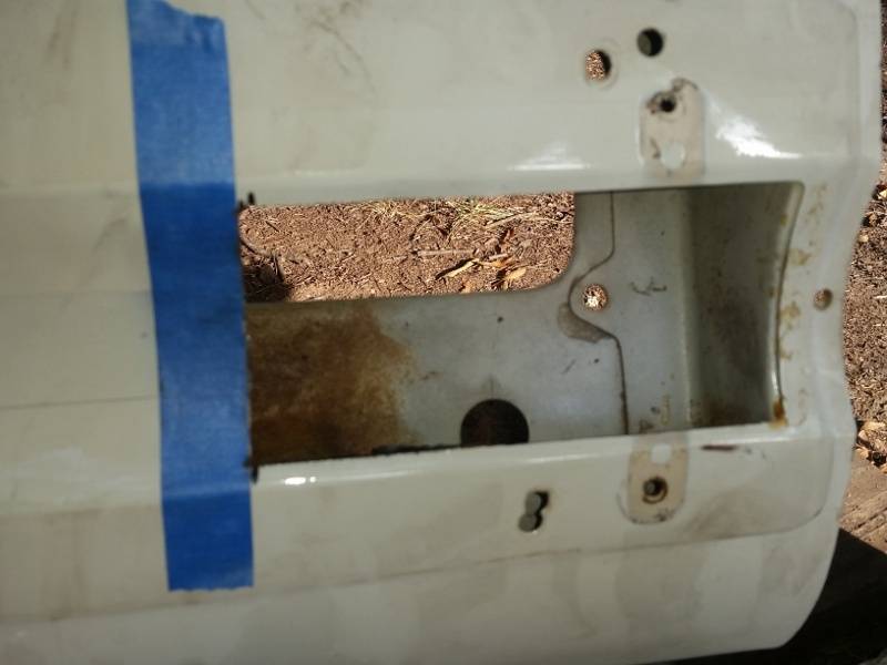

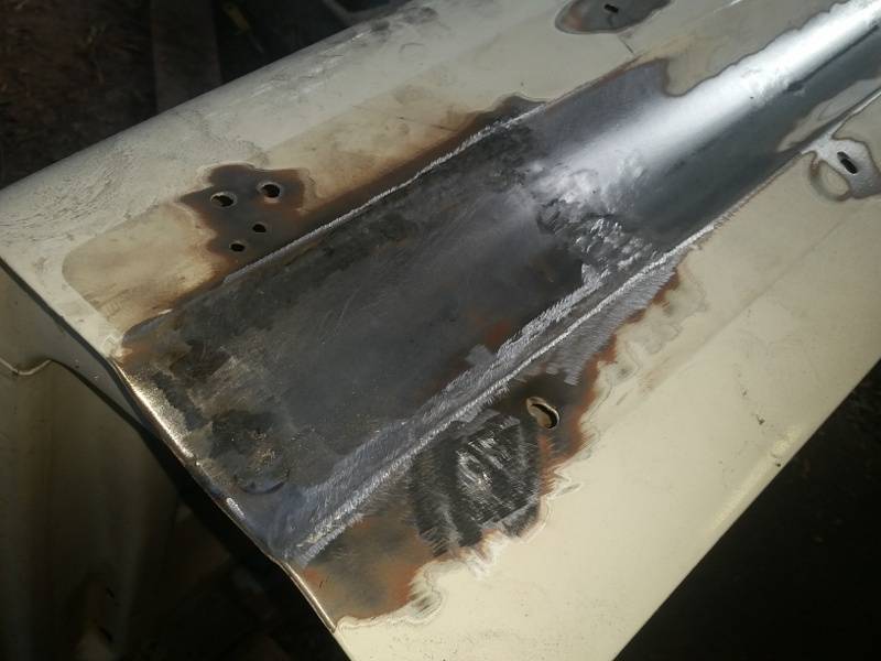

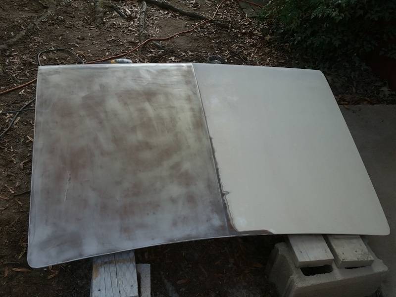

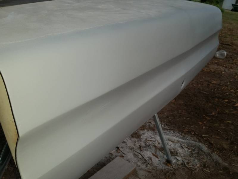

It was a sweat-fest, but I got out in the shop ( ok, the back yard ) and got to work on one of my trunks . . .

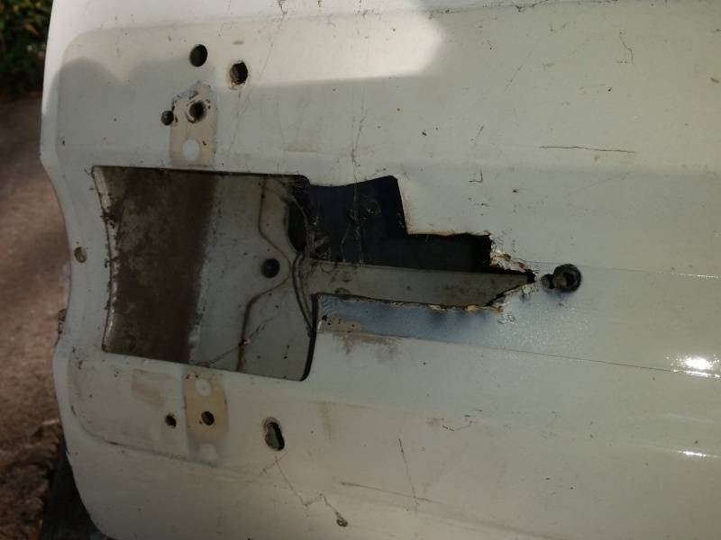

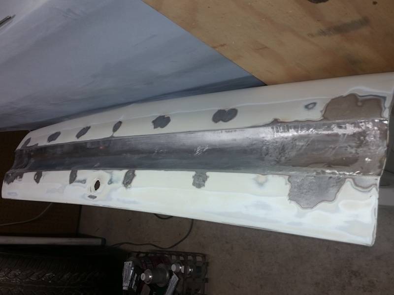

The previous owner had a spare 67 trunk, that he had on his 66, and gave it to me when he got a real 66 trunk ( no, I don't know the difference . . . )
So, he cut up the trunk ( as seen below ) for some reason ( probably to fit his 66 . . . ) . . . my plan is to make this one smooth . . .

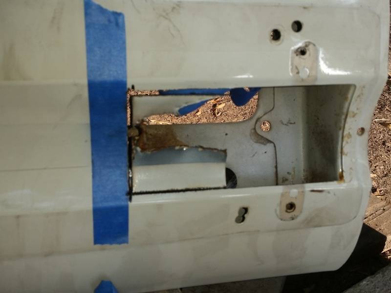

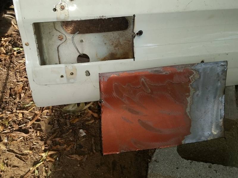

Marked out the lines with tape for cutting with the 4" angle grinder w/ a cutoff wheel . . . ( ok, it's already cut here - but you see the idea )
Removed the cut out pieces and the remaining single hole should be much easier to path then the cobbled up hole ( as see on the top photo )

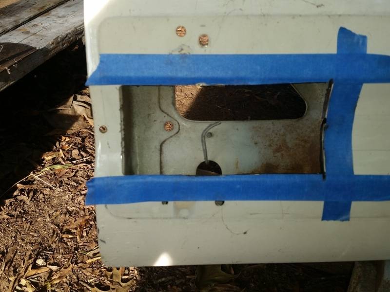

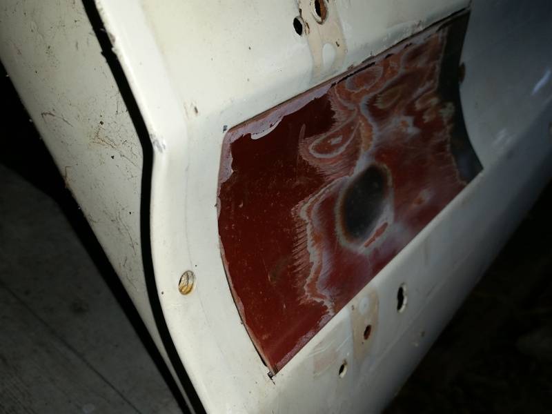

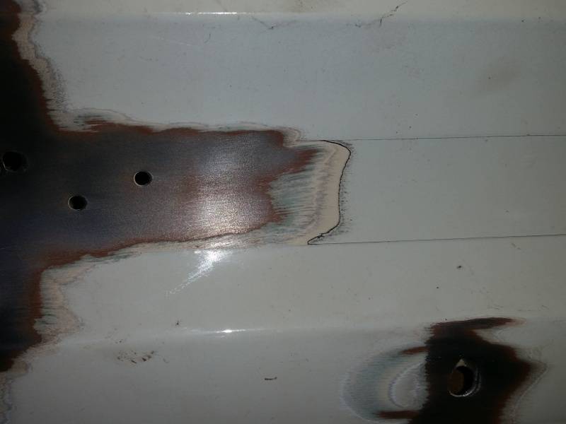

got one pic with the tape still in place - and the driver side hole cut out . . .

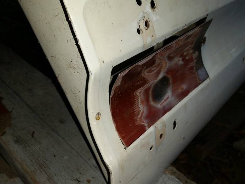

Here's a left over piece of the driver quarter panel that was cut out of my car and replaced ( yes, I reuse a lot of the old metal - I like it better than the new stuff )

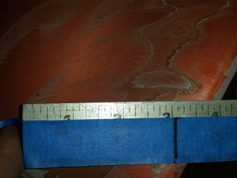

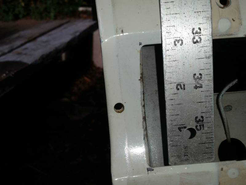

Made sure that I made my measurements correct - marked it with a piece of tape - along the contour of the rear panel . . . ( you'll see )
On the tape measure you can see that it's slightly over 3" in length . . .
however, if you measured the hole straight from side to side . . . it's reading 2 7/8 - you'd be off by 3/16 of an inch . . . tab bit to weld and not warp the panel . . .

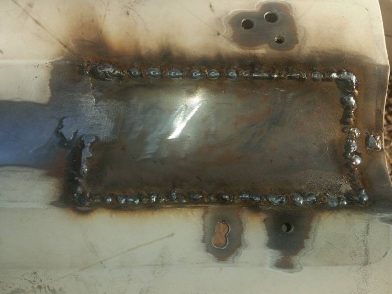

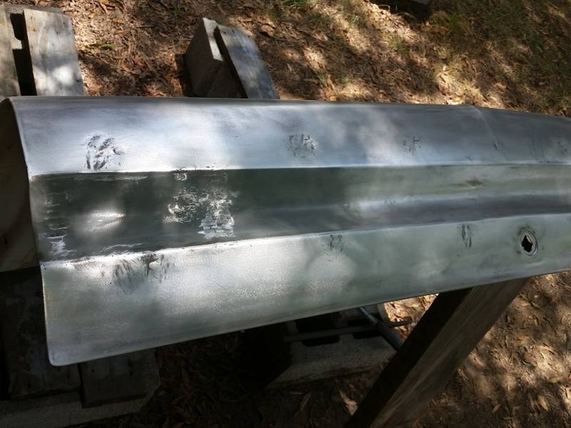

after cutting and rolling the new metal in the roller - to get the contour of the pane ( at least get it close . . . ) it's a "bit much" . . .
removing the roll is simple, tap on the center of the roll a bit till it flattens out as needed . . . and you get the shape of the panel as needed . . . time to weld . . .

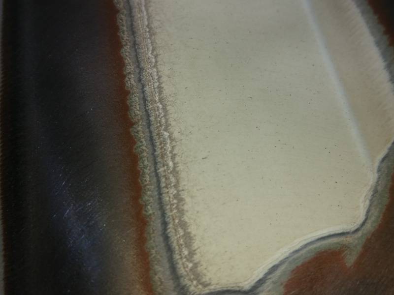

cleaned off all of the holes on the panel so that it'l be ready for welding . . . and I was swimming in my t-shirt . . .
