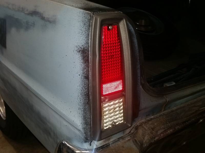

66 Shoebox - the turn signals quit working . . . and I've never been able to get the backup lights to work . . .
- - found the bad connection in the flasher module, and corrected it - got the turn signals working again
- - took apart the reverse activation switch on the steering column, and had to redo all the metal tab connections, the switch spring, basically go all ovet the whole thing again and re-build it . . . can get it to work if I hold the shift lever up, but they go out at soon as I let go with the pressure ( working - kinda sorta )

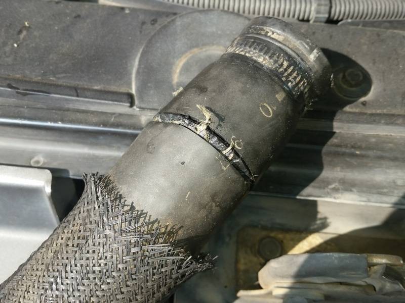

98 Silverado - took a quick 5 minute trip from the house to run an errand, got back and smelled that "sweet" smell . . . and had anti freeze leaking from the truck ( good thing it was a short little trip ) . . . popped the hood . . . and this is what I saw . . . ( when it decided to blow - boy did it go ! )
Quick trip to the local parts store, bought a replacement hose - got it all back together, and to the car wash to hose all the antifreeze out of the engine compartment . . .

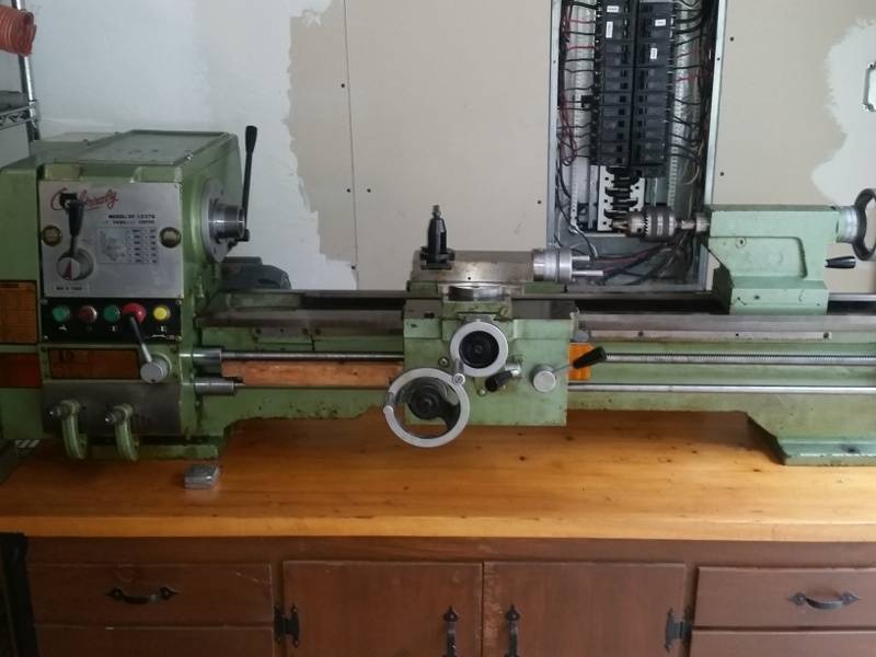

Just picked up a new "toy" for the shop . . . been wanting to add one of these to the shop for a long time . . .
Grizzly DF 1237G - Metal lathe . . .
1 1/2 HP Motor - 12 inch swing ( removable gap bed ) - 37 inch between centers - 1985 model ( by the motor label )
- needs a little bit of work
And I'm going to need a whole lot of tooling . . . I have nothing for a lathe and this had nothing "useful" . . .
Being steered to ( by my friend )
- - Bison 3-jaw chuck
- - Dorian or Aloris quick-change tool post
- - Albrecht drill chuck
And my friend is going to help me get this thing set up true/square/precise - for the best results
( probably some super cool mods too )

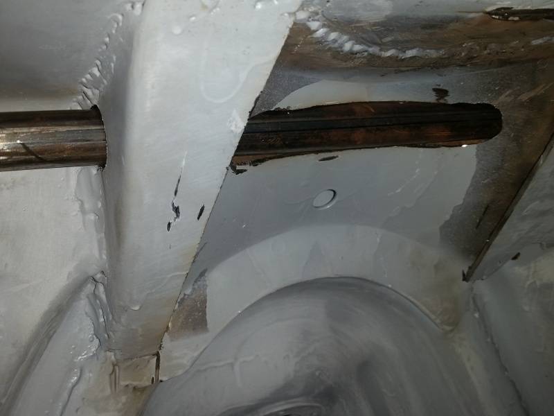

Then I'm planning on routing my wires under the fender to clear up the engine compartment . . . I had added the extra US CarTools braces under here . . .
So it's time to drill some holes and route the pipe for the wires . . . the one in the front . . .
And the one in the fire wall . . . all would be great ( but best made plans of mice and men . . . often go awry ) . . . and it did
Been tossing around ideas in my head to make this right . . .
There is an additional brace ( that I could not see ) that is in the way when you "try" and pass the tube through . . . so cut out the fender support to see what's going on . . .
The the "additional support" needed a little TLC ( tender little cut ) to give some clearance for the tube . . .
Some grinding . . . a little more grinding . . . a little more grinding ( you get the point ) . . . and then . . .
We're now able to feed the metal tube through the fender area ( out of site ) and make a route from cabin to front of car . . .

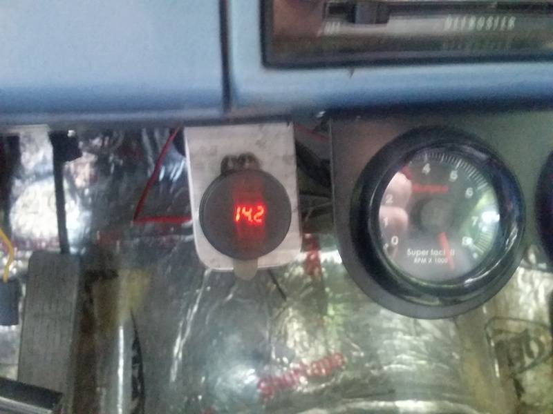

Also had some battery issues in the 66 Shoe Box - so I added a Volt gauge to the car ( under the cover is 2 USB ports )

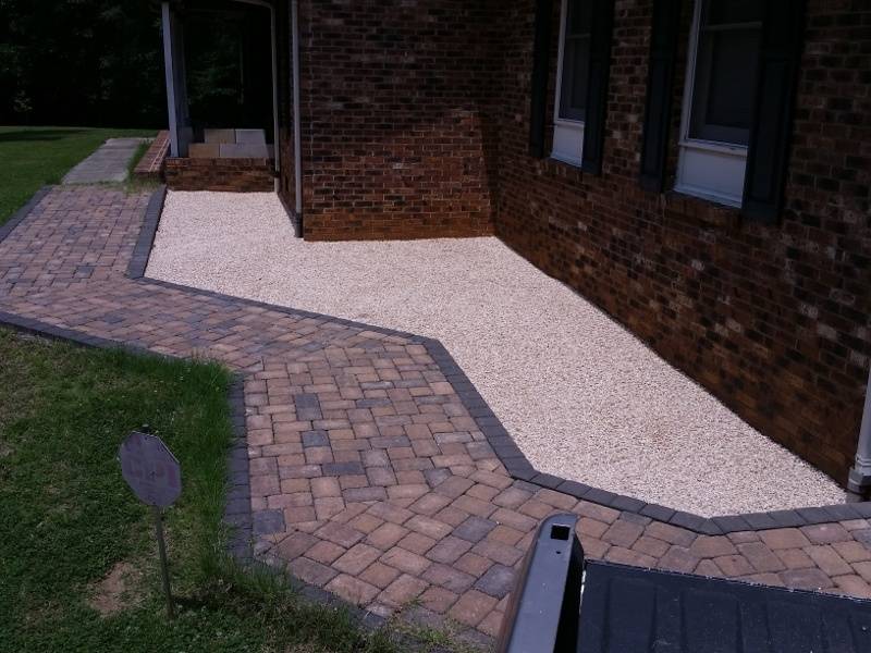

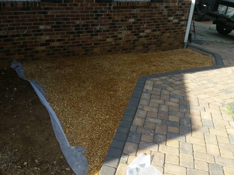

And I finally picked up some stone to fill in the planet box . . . thought it would look good ( ugh - don't like it ) . . .
think we'll be going with the white pea gravel instead
( which was my first choice - then I thought I'd get "creative" . . . argh )

Ouch . . . All that I can say is that I'm 20 anymore . . . just got finished "fixing" one of my planter beds by the house ( tired of seeing weeds growing in it ) and just finished moving 2 tons of stone into the planter box to try and make it look nicer . . .
The first attempt, a couple posts up, was a brown stone ( that I thought would look good - didn't like it ) so I went with the tan/white stone instead . . . I like the looks of this much better . . .

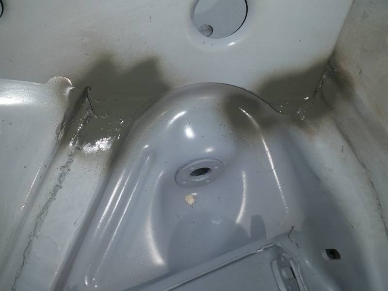

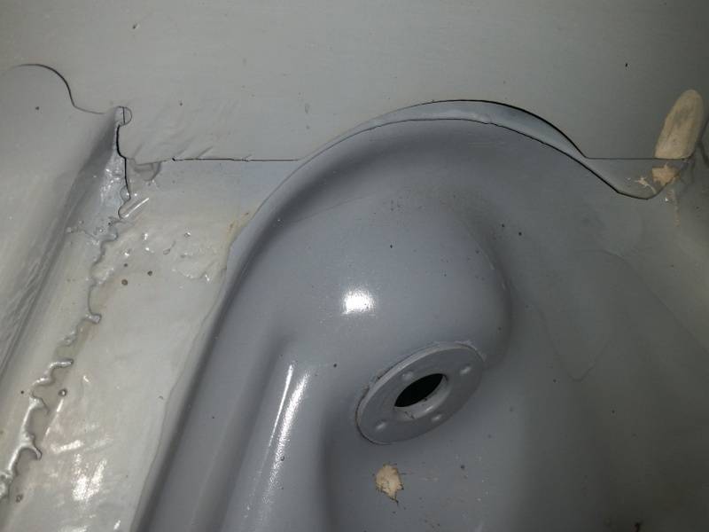

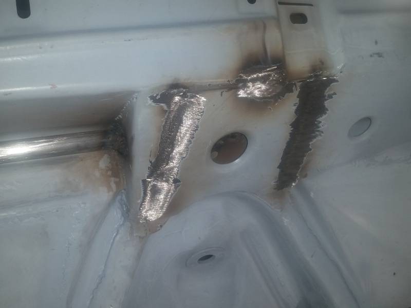

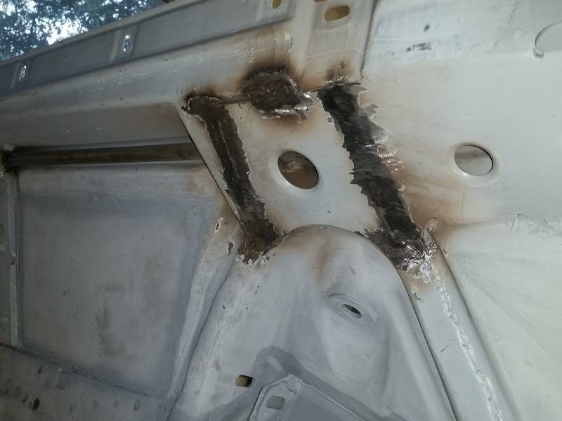

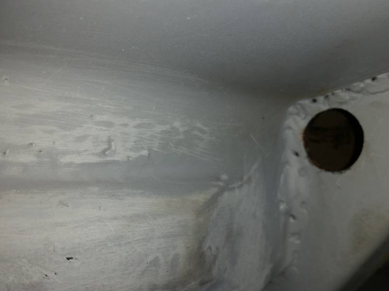

A little more tidy up work on the stiffener . . .
Had to take this picture of the passenger side, since I still need to "tweak it" like I did on the driver side.
If you look at the bottom of the bracket, you'll see it's not fully welded to the lower metal of the inner fender
Fixed a couple pin holes, and worked on blending the metal all the way in at the bottom of the brackets . . . much happier now . . . and stronger too

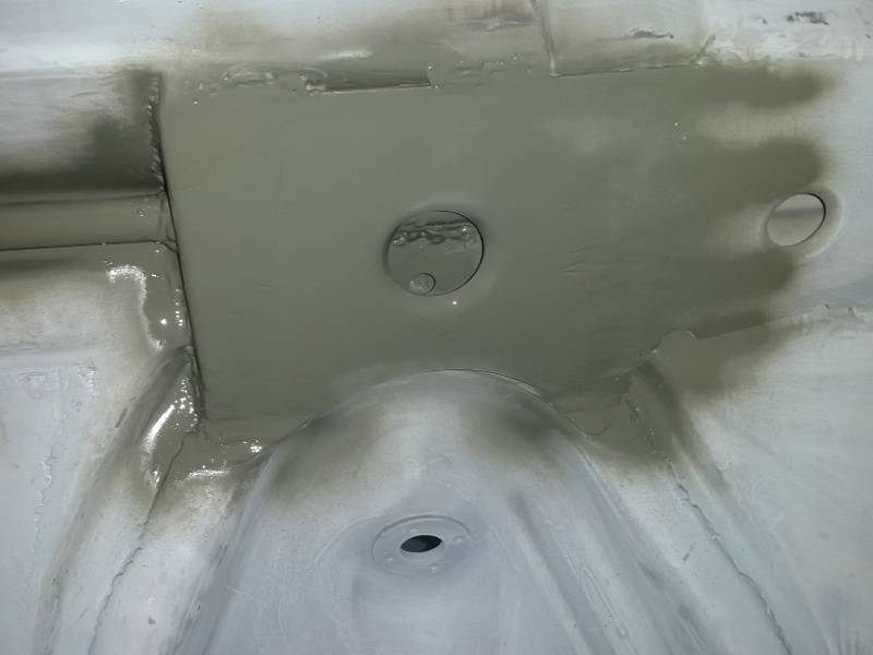

Back in the shop . . . mostly finished up the stiffener brackets . . .
The driver side . . . with some self etching primer on it . . .
And the passenger side . . . also with some self etching primer on it . . .
They're solid now . . . and I'm sure they're not going anywhere . . .

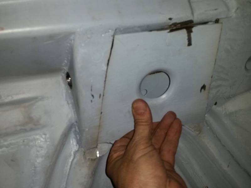

Got out in the shop today and got a bunch of little things done on the Belvedere:
- pulled out the backing plates and got them cleaned up
- media blasted the inner fender splash shields and got them in epoxy primer ( guess I could get a picture )
- got the welded areas under my fenders covered with epoxy primer too
- welded up a couple gaps on the frame to help strengthen it up
- did some grinding on previous welds to get them looking a little better
