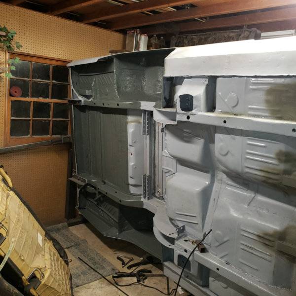

And I've been working on the bottom of the car as well, trying to get some things wrapped up so that the car can go back on all fours . . .

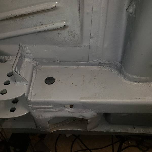

Got this area cleaned up a bit, and in epoxy primer . . . the top right is where my E-brake cable will come from the cab . . .
An this is the tight area that I need to figure out the connection to the E-brakes . . .
Here's the bracket that will need to be mounted ( hope that I have enough room here to make it all happen . . . it's going to be tight . . .

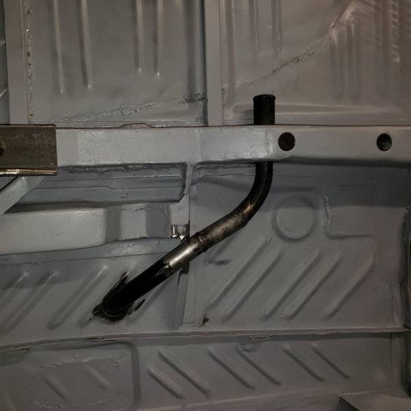

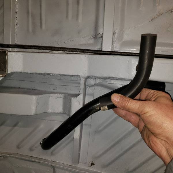

Also working on the gas fill tube . . . this is bolted in place, and cut through the floor of the trunk . ..
from there I'm thinking going in this direction ( it will go through the frame rail . . .
and one more piece angled to bring it into the center section then a rubber hose connection to the tank . . .
These pieces will allow me to do some more practice on my TIG welding too . . .
Gawd . . . I'm hoping that this is going to work out for the tube
( if it's all welded in place - is that a problem - or does it need to rubber isolated ? )
Was a "balmy" 40 degrees in the shop yesterday . . . and I spent about 6 hours out there fighting with this filler tube fabrication . . .
Got the underside of it mostly done, but got a couple pin holes that need to be fixed . . .
Then I'll have to get the welding done that connects the "top" part of the filler to this "bottom" part of the filler - with no pin hole leaks to boot . . .
And get the rest of it all welded into place . . . fitment is so-so . . . just didn't want to cooperate . . . but should be able to make it work.

trying to get the bottom of the car ready to shoot the Liner Xtreme . . . gawd there is a lot of stuff under there . . .
Sanding . . . Sanding . . . Sanding . . . Sanding . . .
:lol: I don't envy you lol. Not to rain on your parade but you've got one more hole to put in that floor, your A/C drain. O.K. that's just a small job project that can be done afterwards.
I'd try to figure out a way of testing your filler tube at the pump before you make it permanent. I had a 78 F350 with a flat bed that would make me cuss, couldn't hold the lever much past 1/4 or the gas would start backing up the tube... turns out gas hates fairly flat filler tubes.

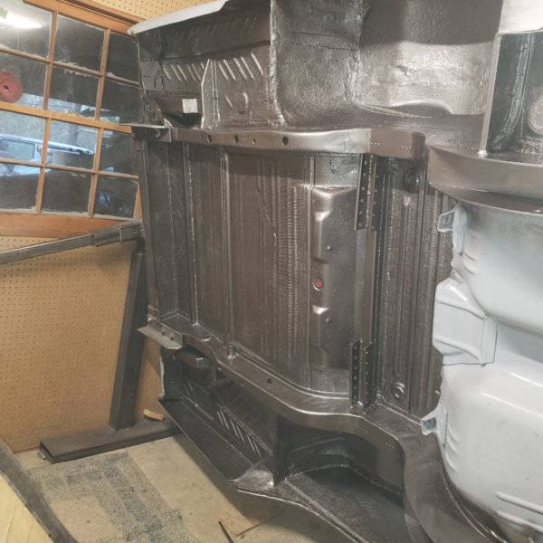

Got a bunch of stuff done on the under side of the car - working on adding the bed liner to the bottom of the car . . .
Passenger side wheel well . . .
Behind the passenger side wheel well . . .
The rear trunk area of the car . . .
Better view of round one areas done . . .
The fumes from this stuff are strong - even through my respirator . . . WOW . . .
Be back out there again tomorrow - thinking of painting over it, while it's still possible to allow me to get paint on areas that I'm not covering with bed liner . . . and make the whole bottom the same color that will match the rear end and front K-member powdercoat color . . .
Looking awesome!
Have to agree with the idea of painting over the coating, I did it on the Fury and love the results.
Keep up the good work my friend.
I had issues with modern fuel delivery pressures at the pump, and the filler entering the tank half way up the tank on my A100. Too much pressure meant a lot of blow-back when filling. So the new custom tank drops fuel in from the top. Having a good breather tube helps also. It started getting tiresome filling the tank from plastic 5-gallon bottles. :eek:

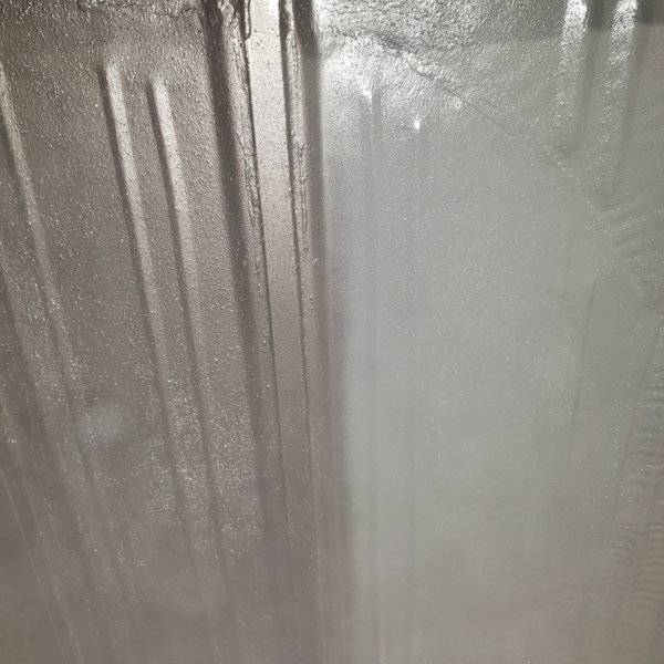

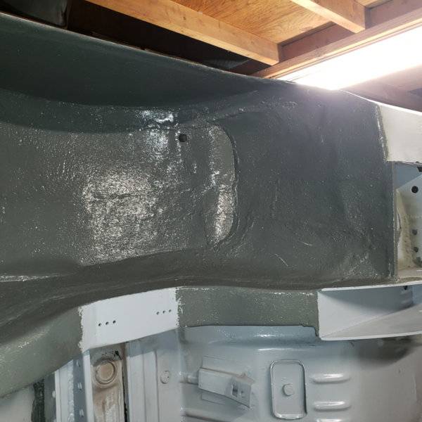

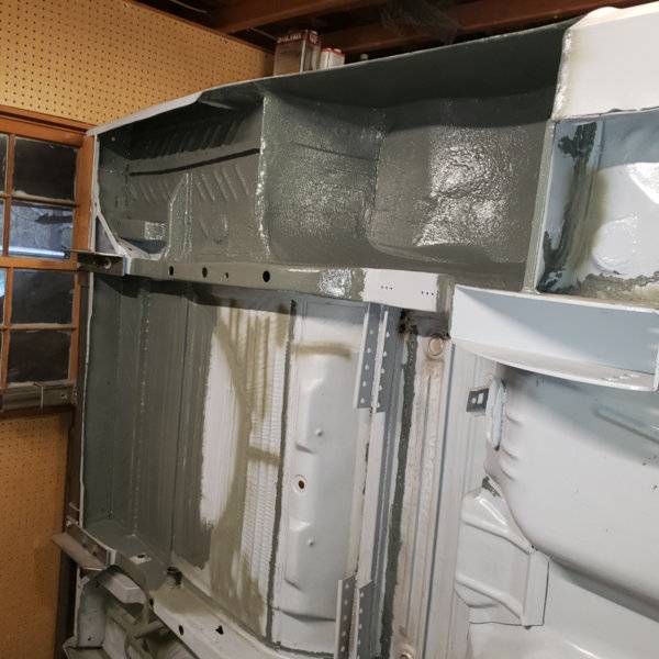

More bed liner was applied last night, and then I needed to get the paint on this stuff before 48 hours when it's fully cured . . . so it was off to the shop for some painting tonight . . .
and this is what happened . . . on the left is the paint - and the right is the bed liner color . . .
and here's what it's looking like now . . . gotta say . . . I'm really happy with the way it turned out ! ! !
Spent part of the day in the shop working on the bed liner on the bottom of the '67
Now if I can just figure out my E-brake . . . ( that's the area not covered yet as I think I'll need to weld some stuff in there . . . )
Got the paint shot over the bed liner already today . . . sure like to see progress . .
Thinking of also doing the bottom of the rockers to prevent rock chips in the paint . . .
Looking good Larry. Should be good and durable.
Lots of good progress Larry. I used undercoating when I did mine. Its a 3M product called Dyna-pro. The brand label is Dynatron, but its made by 3M. Really good stuff and not horribly expensive on Amazon. Also paint-able. I've used this on my truck, wife's van, and on the Coronet.

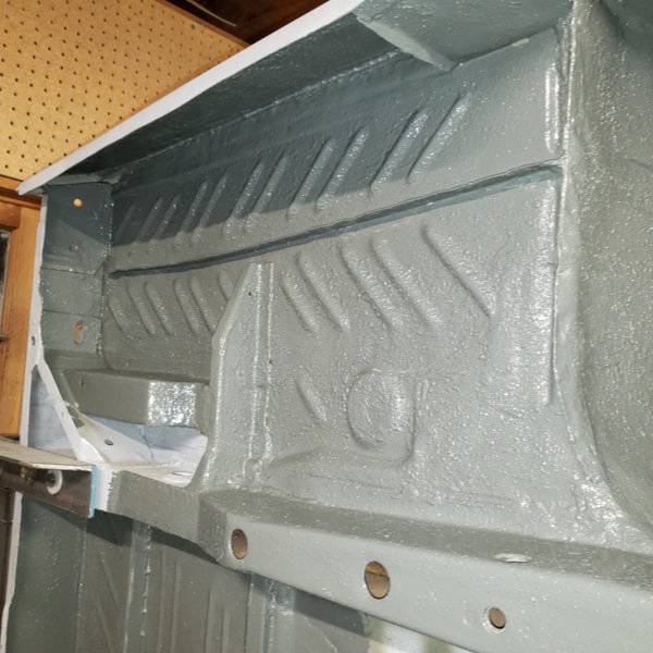

Got the bed liner in the trunk of the 67 in the morning . . .
Did some cutting up of the tree . . .
and got the bed-liner in the trunk painted too . . .
