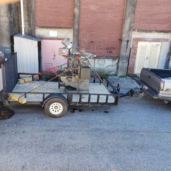

Look what followed me home the other day . . .

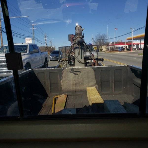

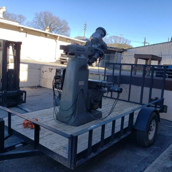

Picked up a new "toy" for the shop . . .
Good news it's the 2J head to boot ! ! !
Got it on the trailer . . .
And then got it strapped down securely . . . needs to get home safely . . .
Ahhhhhhhhhh . . . what a great site ! ! ! Love it ! ! !
Mine was delivered AND put into place for no charge. Had to turn the Head horizontal to get it through the overhead door. It was close squeeze. Used to run a Bridgeport Series II w/4J head at work quite often and liked the all axis power feed on it. It was a nice machine. I have a 10x50 Lagun....
Awesome, love the Bridgeport's! Hope to see some cool parts being milled out soon.

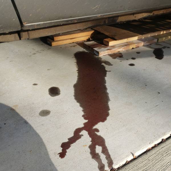

Walked to the truck the other morning and was "greeted" by the following . . .
( since the transmission was just rebuilt a couple years ago, I was not too happy - turns out the transfer case was leaking instead . . . transmission is GOOD ! )

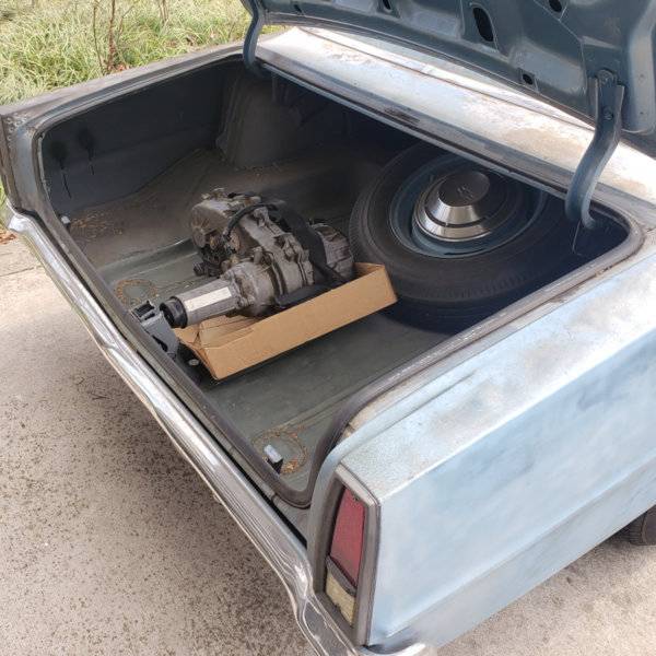

Will be tearing down the leaking 241 transfer case, but have found that it's a pretty common occurrence for a loose chain in the transfer case to wear through the casing - and that just might be what happened in this instance, so I'll look at rebuilding it and then I can swap them out (again) or hold onto it and have a spare for the next time it starts leaking . . .
BTW - my truck now has 350,000 miles on it . . . so the transfer case did a awesome job for me for 20+ years ! ! !

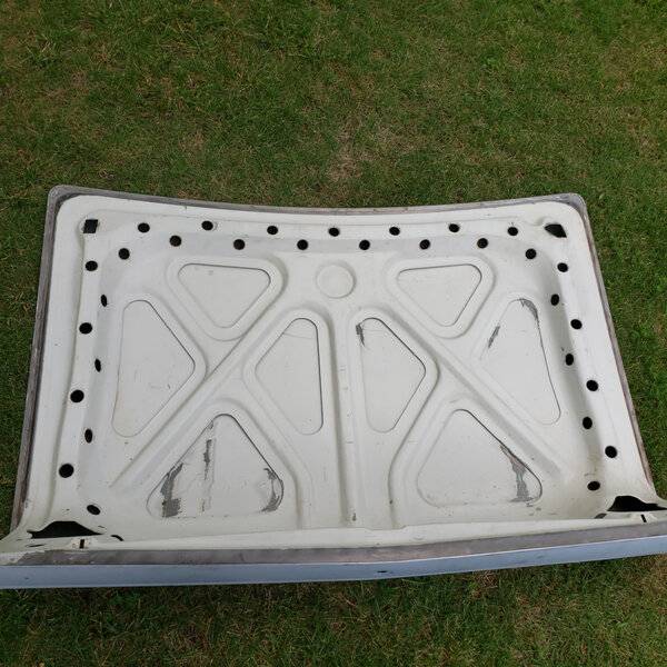

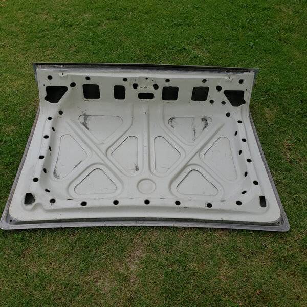

So I grabbed a not so visible project, to work on and see how the results turned out, before I work on something that is more visible . . .

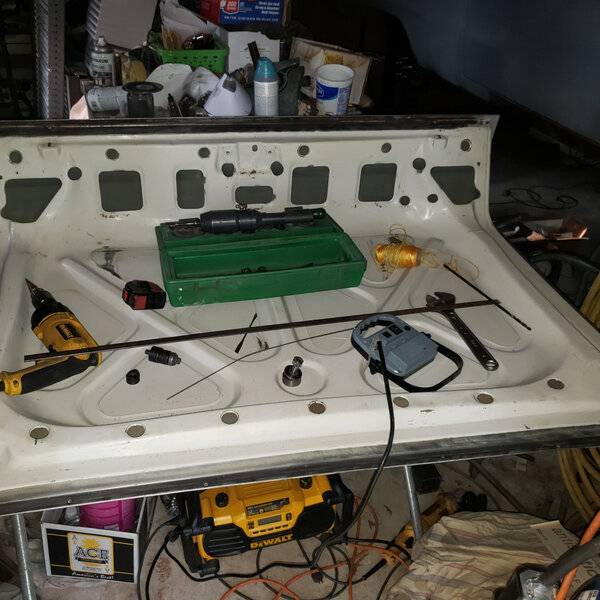

The candidate - the trunk lid ( inside the trunk ) . . .

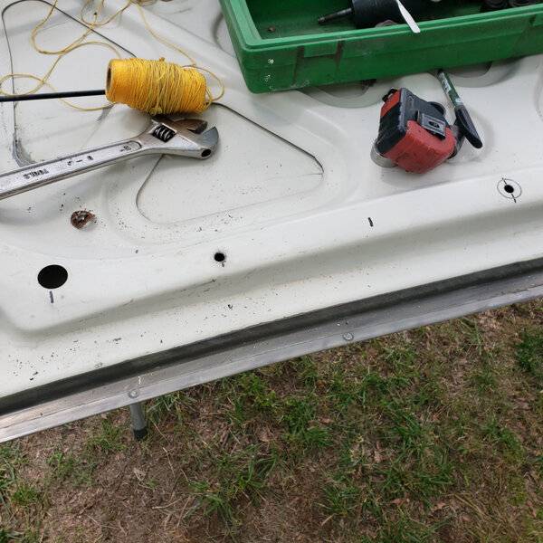

First the layout work . . . where do the holes need to go . . .

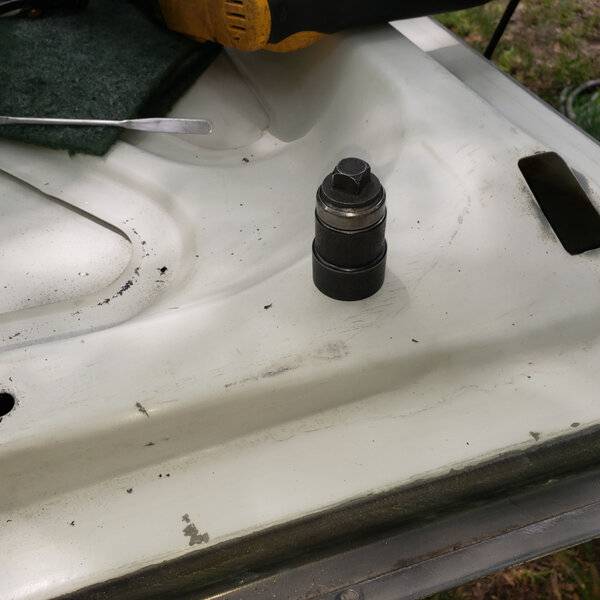

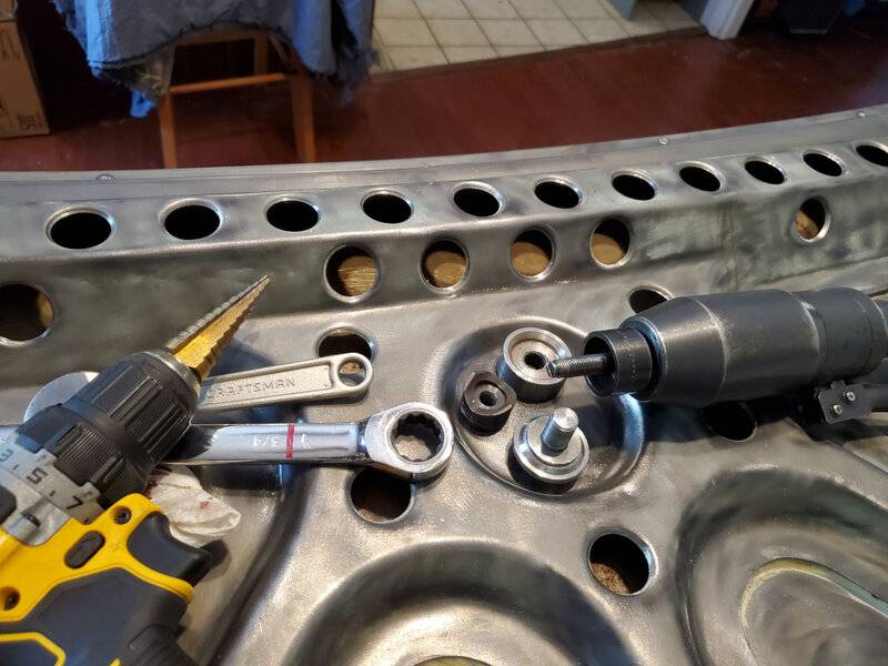

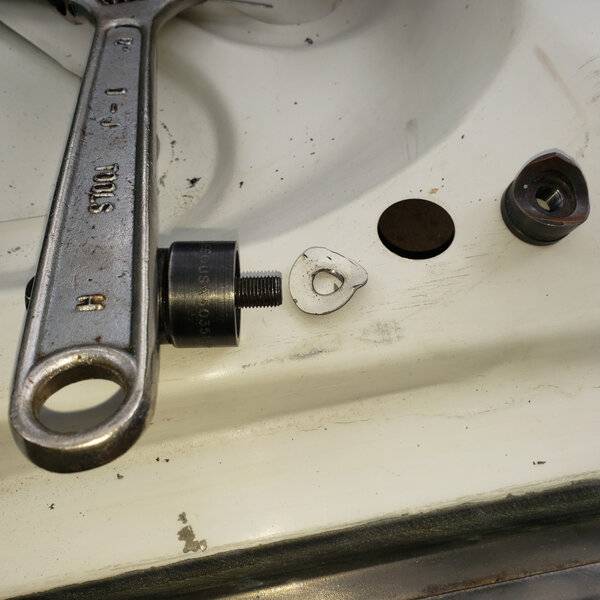

Next, this is the stackup of the Greenlee tool to cut out the holes in the metal
This is the result of the hole cutout . . . really clean . . .

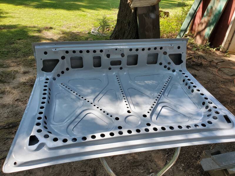

Add a bunch more . . . then dimple die the hole for added strength ( and coolness )
The end result . . . kinda . . . you'll see a few more in the next pics . . . and I'm thinking of adding a few more . . .
This allows you to see the holes on the inside part of the trunk cross member

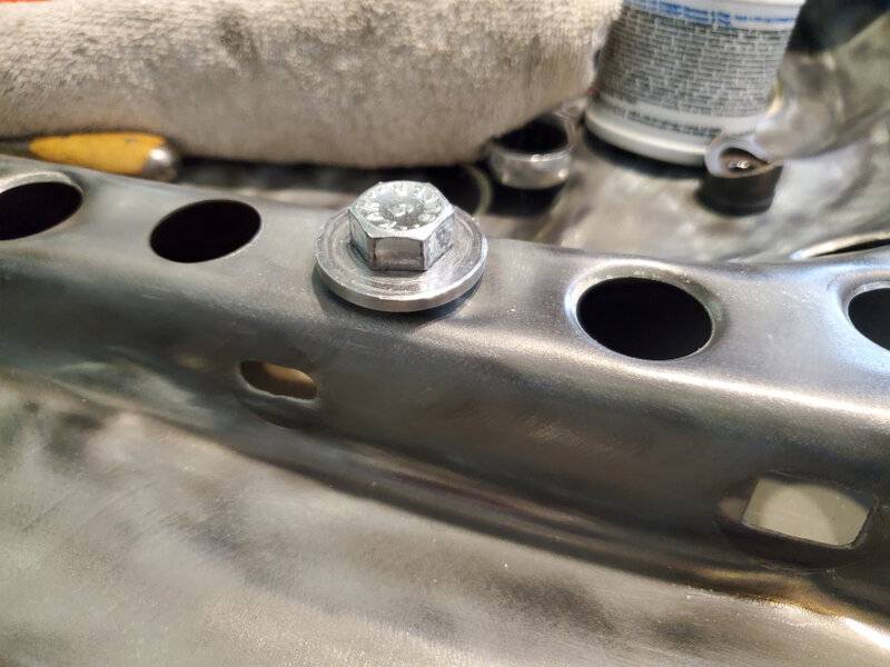

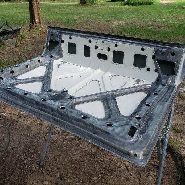

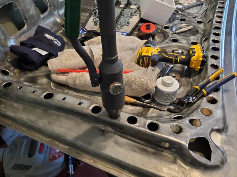

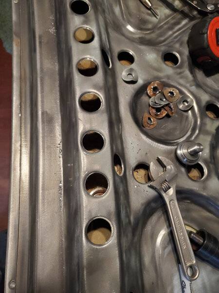

So . . . I started doing a little more tinkering with the trunk lid inside . . .
Added a few more holes to the supports . . .
And . . . add a few more . . . and here's the process . . .
And this is the dimple forming tool . . .
And a few more holes . . .

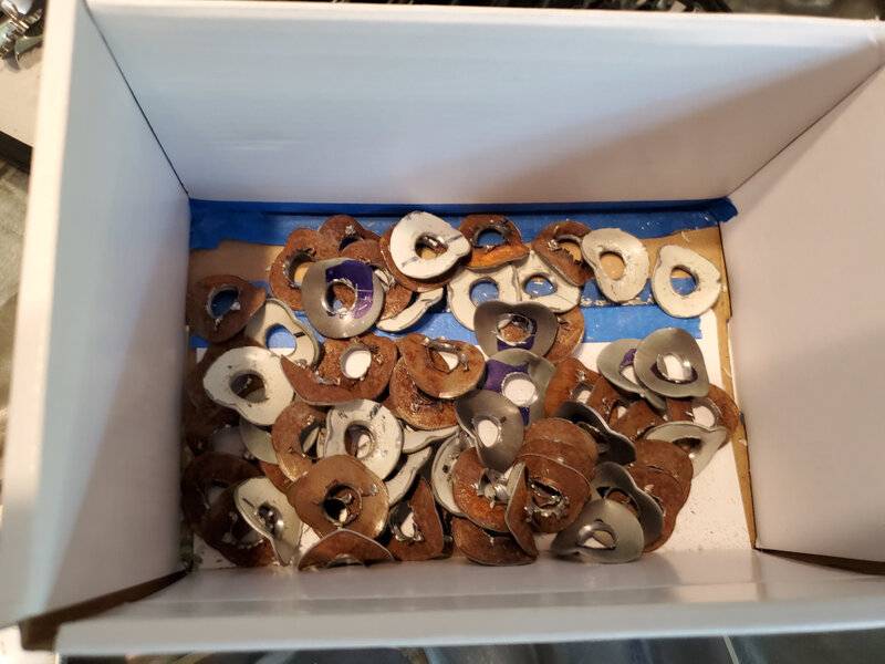

And I'm saving all the punch outs to find out the weight . . .
Still tinkering . . .

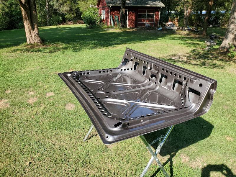

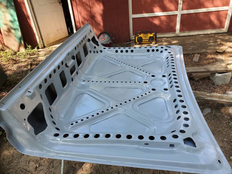

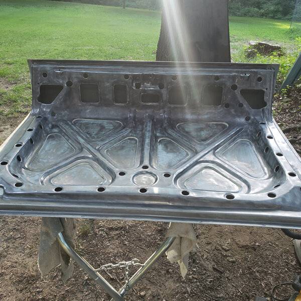

Finally got around to working on this thing again . . . and got it into primer on Sunday . . .
Really happy with how it turned out . . .
Another view . . .
Then yesterday I got it back out and shot it with some paint . . .
Next . . . will be the hood with a similar treatment ( I hope ) . . . .
