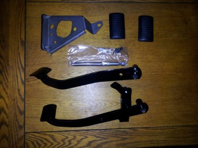

Good new on the Belvedere Front . . . we have pedals ! ! !
Got home today to find a box from Brewer's Performance with my brake/clutch pedals and stuff . . .
So . . . here's what we got in the package . . .
Bracket, firewall bracket with bolts and nuts.
(2) rubber foot pedals
Clutch pedal
Brake pedal
Kingpin and bushings . . . this is the 1/2 kingpin that should work with my assembly

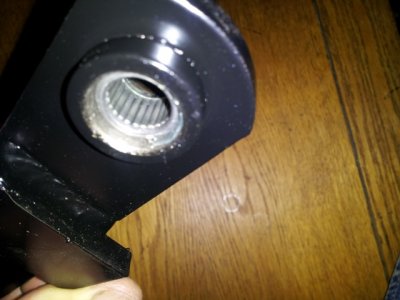

But the nicest thing about this setup - you've got to see this - the clutch pedal is lined with needle bearings ! ! !
That should really help out the wear and longevity of the clutch pedal in my car ! ! !
Still gotta get into the assembly and make sure it all works, but so far it looks great ! ! !
Test Fit . . . Looks Good . . . time to get this assembly painted . . .

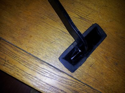

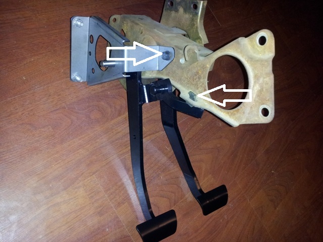

So now the time for the full test - how does it go together . . .
Here's what I got:
The kit came with
- the nylon bushings for the brake pedal ( just like in the stock brake pedal )
- the bolt to hold the bracket in place ( top arrow )
- rubber stop for the clutch pedal ( fit in the hole in the bracket ) ( lower arrow )
- (2) felts to go in the edge of the clutch where the needle bearing are located.
- (2) rubber pedals ( not installed on the set yet ( but I've got them ! )
- and the firewall bracket ( you can see the 2 bolts on the end of the new bracket )
Now to tear it all down and get all this metal cleaned up and properly painted and protected ! ! !
Here's what I got:
The kit came with
( so it can be stuck under the dash and nobody will ever see it - that makes complete sense ! )
( SMILE )

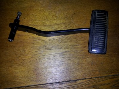

Got my old automatic brake pedal cleaned up and it's available if anyone is looking for a Automatic brake pedal . . .
Pedal comes with:
- kingpin ( in good condition ) lock washer and nut
- 2 nylon bushings ( probably need to be replaced
- brake pedal
- rubber pedal ( in very good condition )
